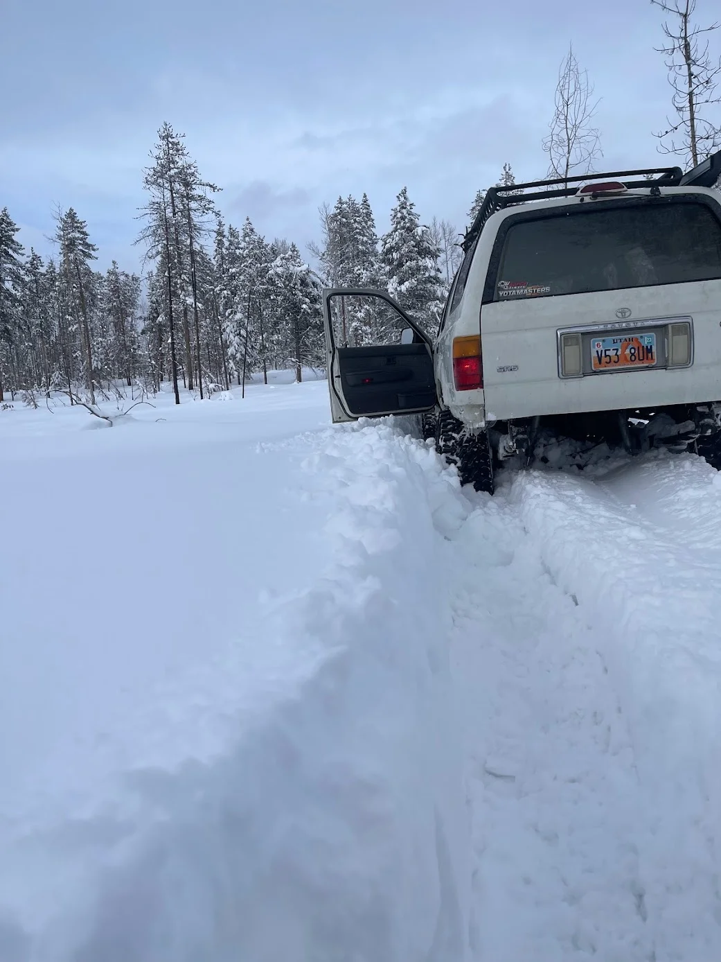

I was running 5.5 psi here. Just for reference, those are 37's.
:rofl:
