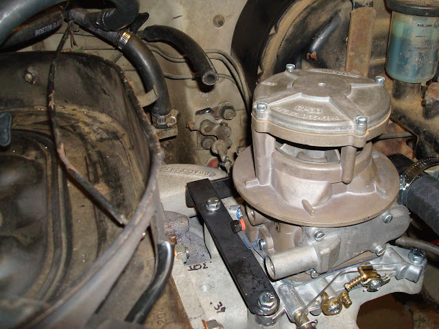

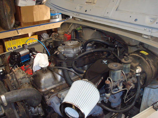

Is there anyone that does some wheeling that is interested in doing a propane swap whether it be in a Land cruiser or Toyota period. I got fed up of paying rediculis prices for a measly little adapter to fit on a 20r and 22r carb so I started making my own and doing a lot of propane swaps for my friends and I would like to pass my knowledge and parts on to the Cruiser guys. I wheel the crap out of mine and want it to run at any angle and this is the cheapest and easiest solution that I have come up with. I will get some pics up and show you kind of what I run and you can look at the videos for proof as to how it runs. If there is any interest I am going to build some propane set ups for Land Cruisers. I am hoping to keep them as cheap as I can find the parts for I just like doing it. Here is a pretty good video bc this is pretty much straight up YouTube - Jody on Bee's Nest @ The Farm .mpg

Impco 425 - holly baseplate - offy 4bbl intake

That looks like it was meant to be there. I am trying to get a company to make me some base plates for the intakes just to bolt everything down without a bunch of adapters. I have some 22r and 20r adapters made that bolt directly to the factory carb but what sucks about the cruiser is that it is not a mechanical secondary
If I had the parts available (hint hint) I would have gone w/ a smaller mixer, 2bbl OE baseplate, and not had to mess w/ the intake. These 2F's don't need as much CFM as the 425 provides, but I got a hell of a deal on these parts so I rolled w/ it. I have the secondaries tied to open when the primaries are about 3/4 full open now. Probably could leave them closed to be honest. I think I need to put the "lean" diaphram in that 425 b/c on the road I'm only getting about 8mpg. Of course I rarely drive it on pavement, so I haven't taken that $100 step yet.
