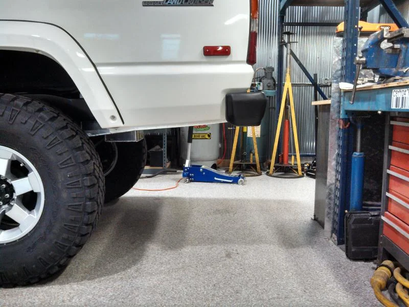

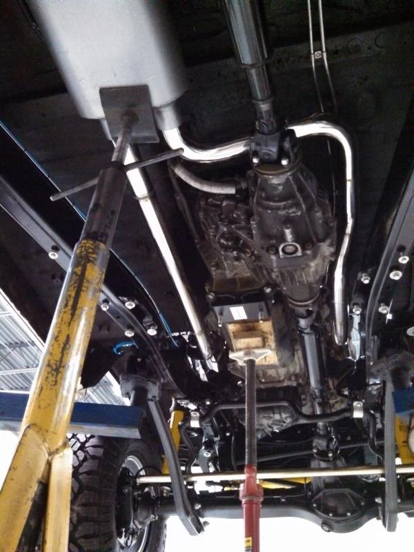

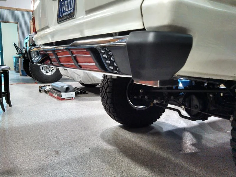

Finished the rear bumper today and started mounting the front. The rear in its new chrome and new end caps looks amazing. Started welding up the exhaust system, but will have to take some pics in another day or so because its going to take a while.

You going to clean that transfer case up before calling it done? It just doesn't look right with that shiny exhaust...
Was going to be temporary until I got the part time kit case done.

Question: what type of clearance do you have between the xfer and the exhaust?

At the smallest area, there is about 3" clearance.
