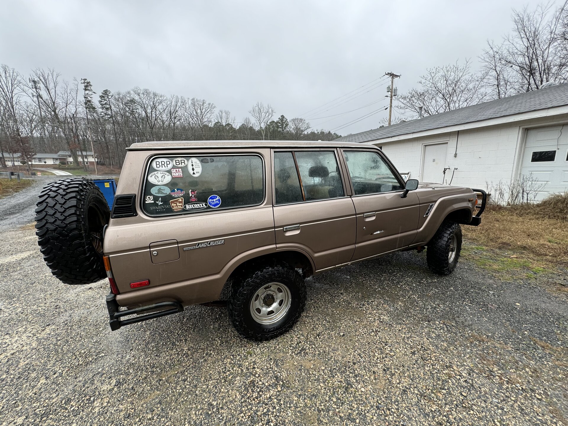

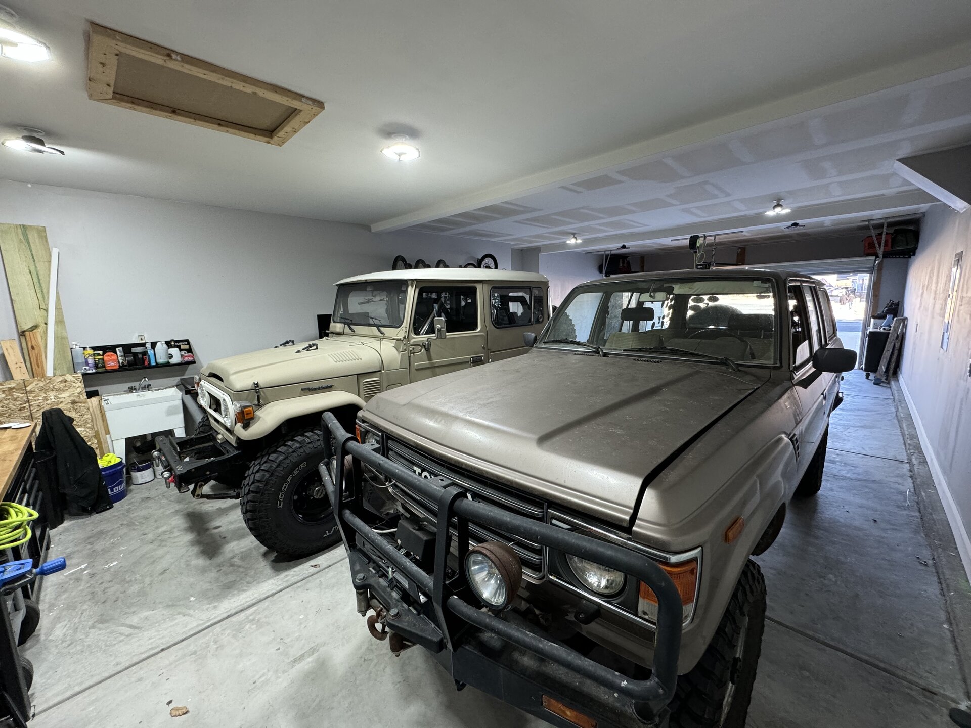

I asked @roadstr6 to help find me a 60 and 23 minutes later....
I was looking for a project for me and my son; crockpot has been trouble free for two years so I hope this is something we can work on, swear at, and enjoy for many years. Thanks to John Whitley for parting with it.

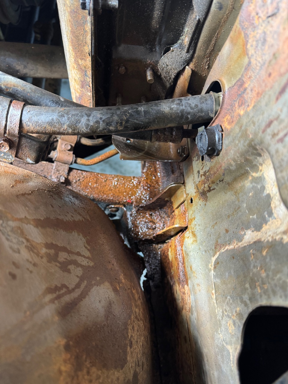

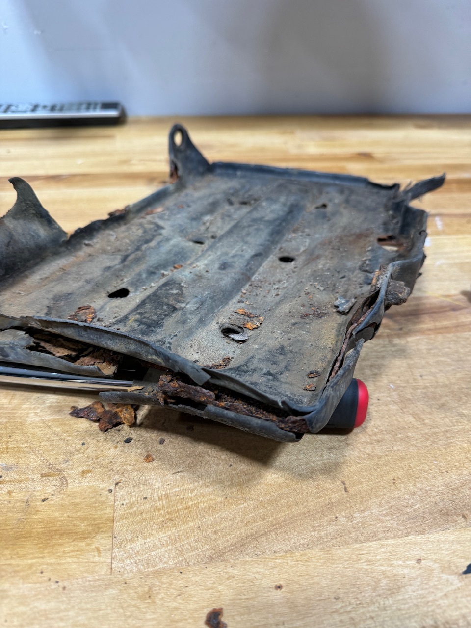

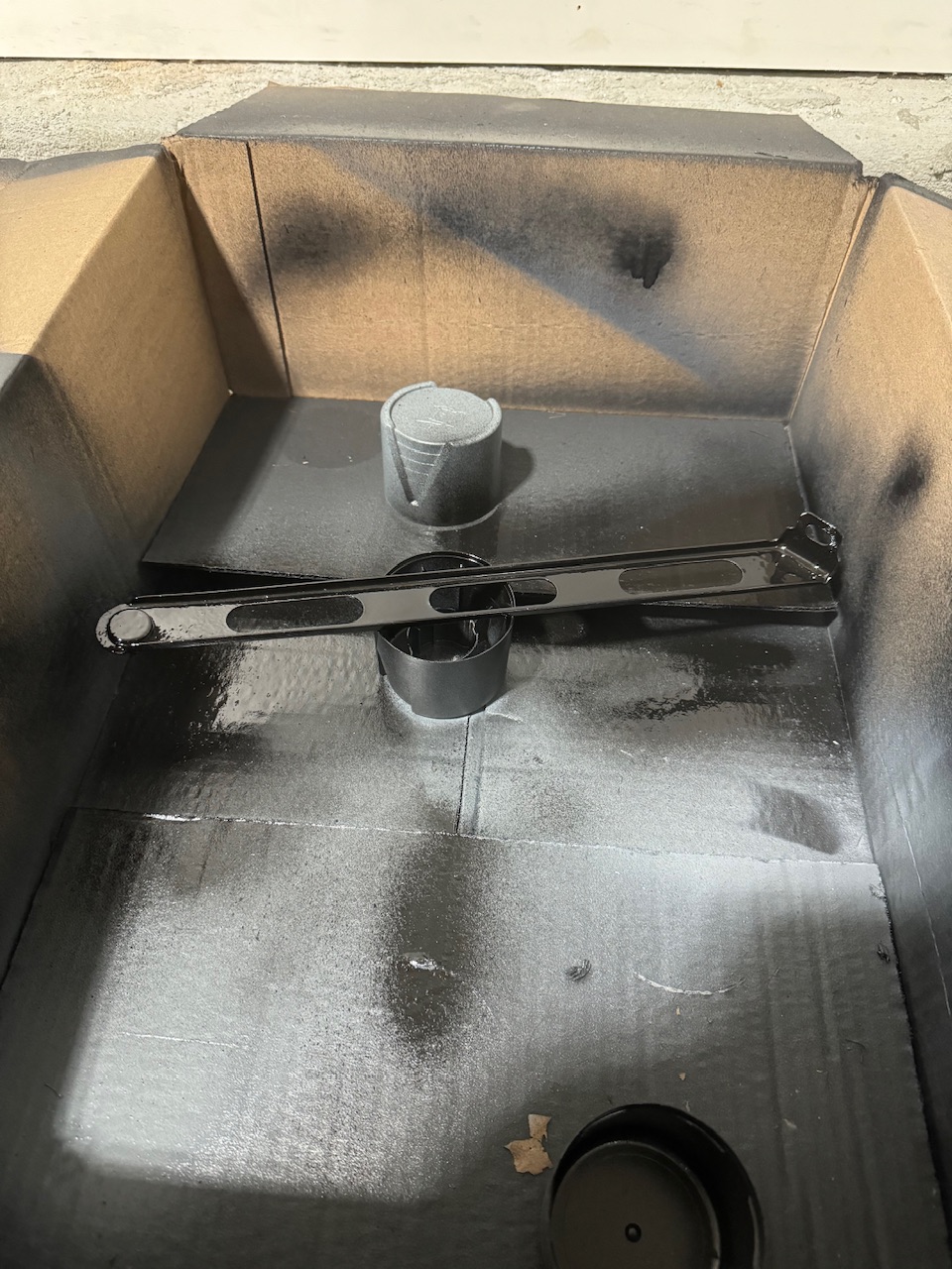

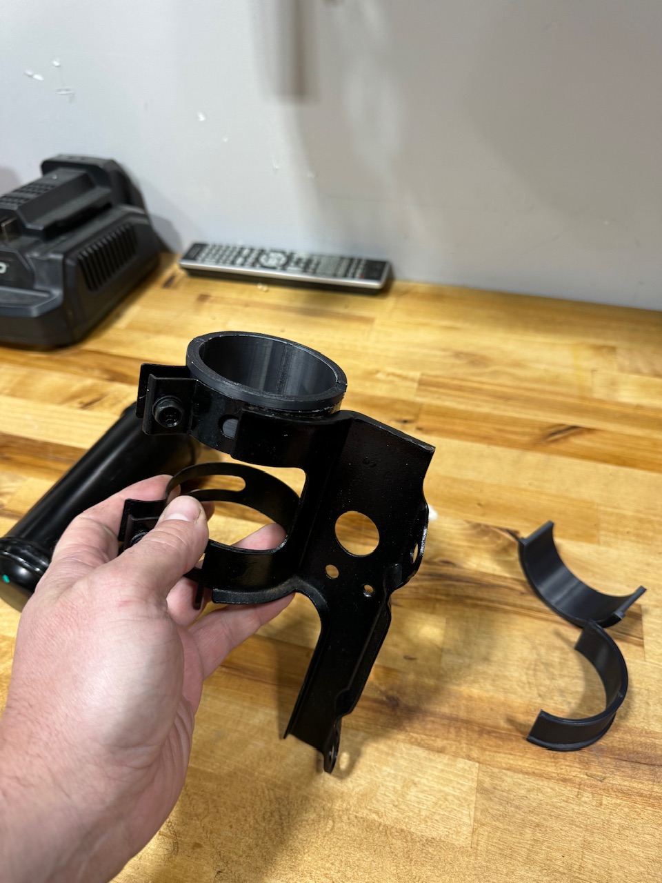

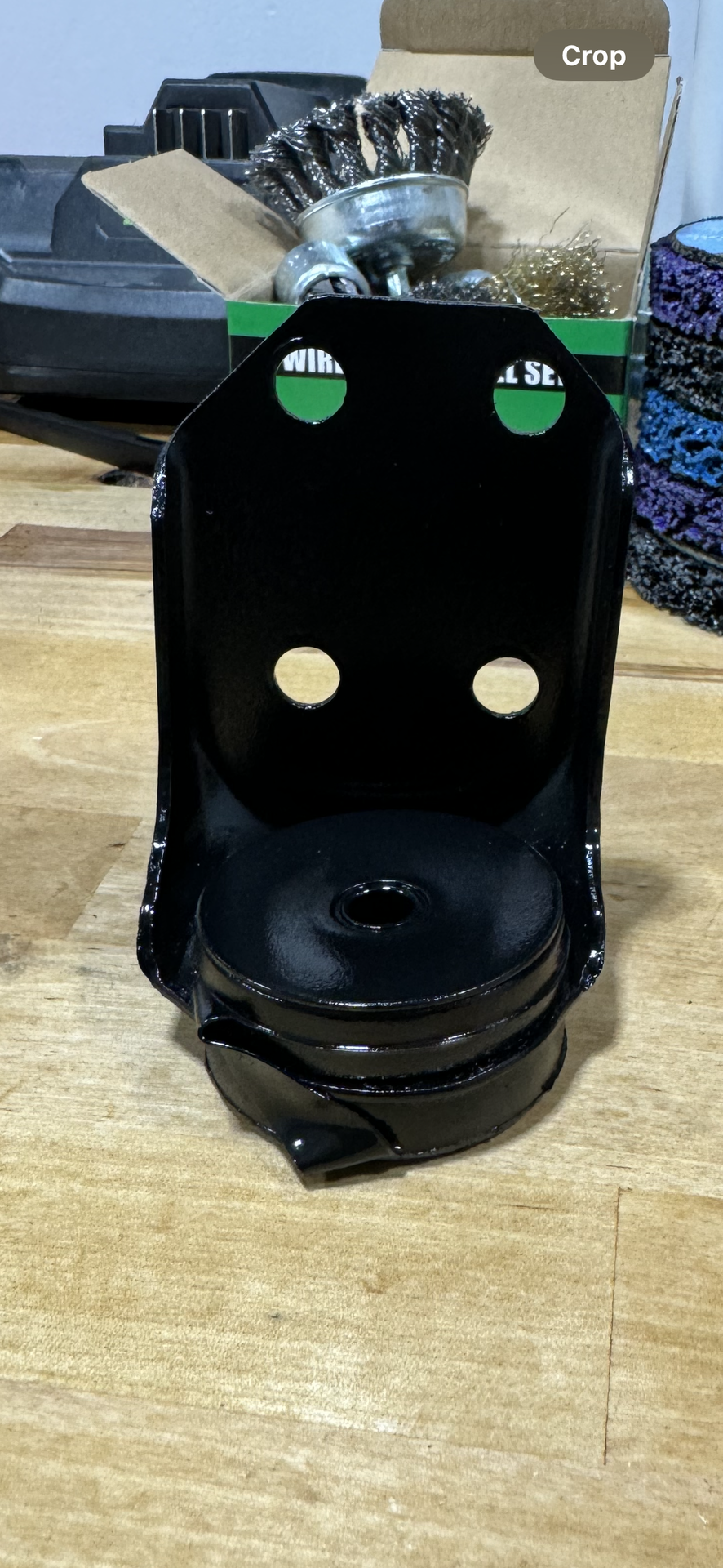

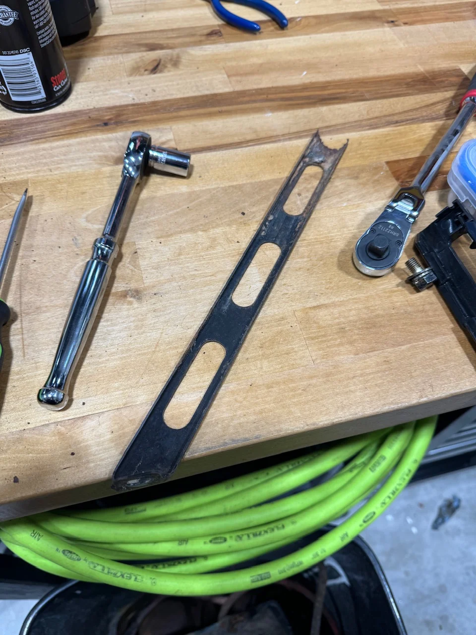

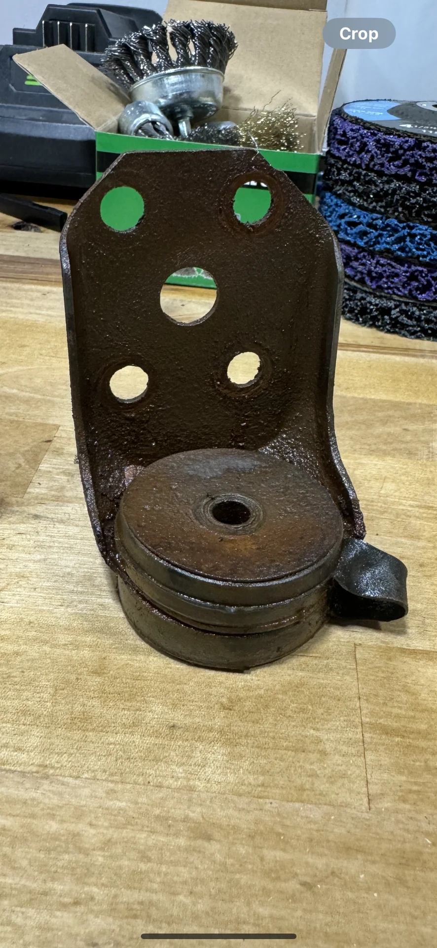

The support bracket for the battery tray (74431-90A00) was also rusted out. Got an OEM tray coming but support bracket is NLA. Didn't see any solutions with a quick search.
Seems like a simple item to fab up, any other thoughts?
You should be able to duplicate that bracket with a piece of flat stock from Lowes. Just stick it in the bench vise, bend one end at a 45 and drill some mounting holes.

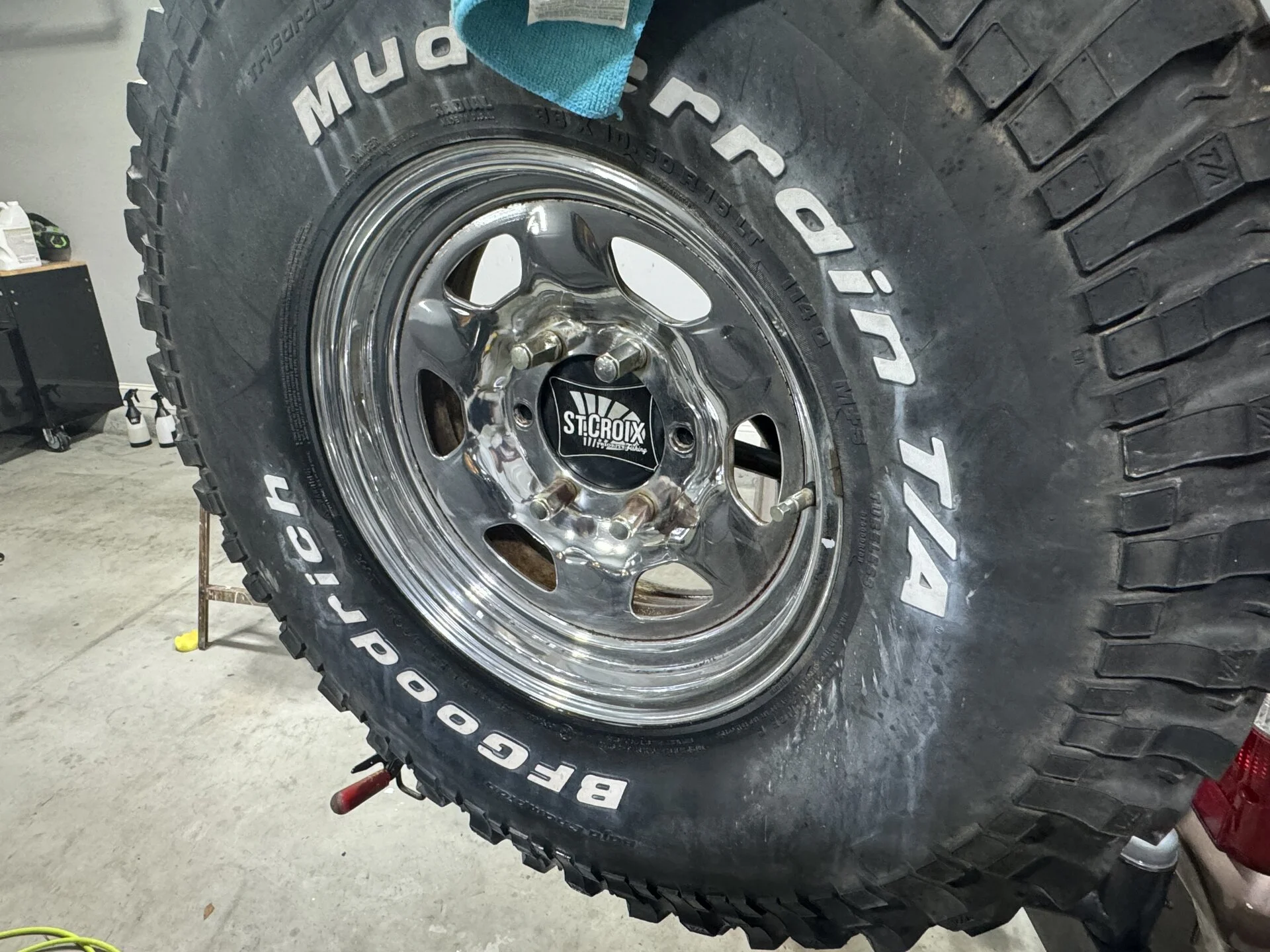

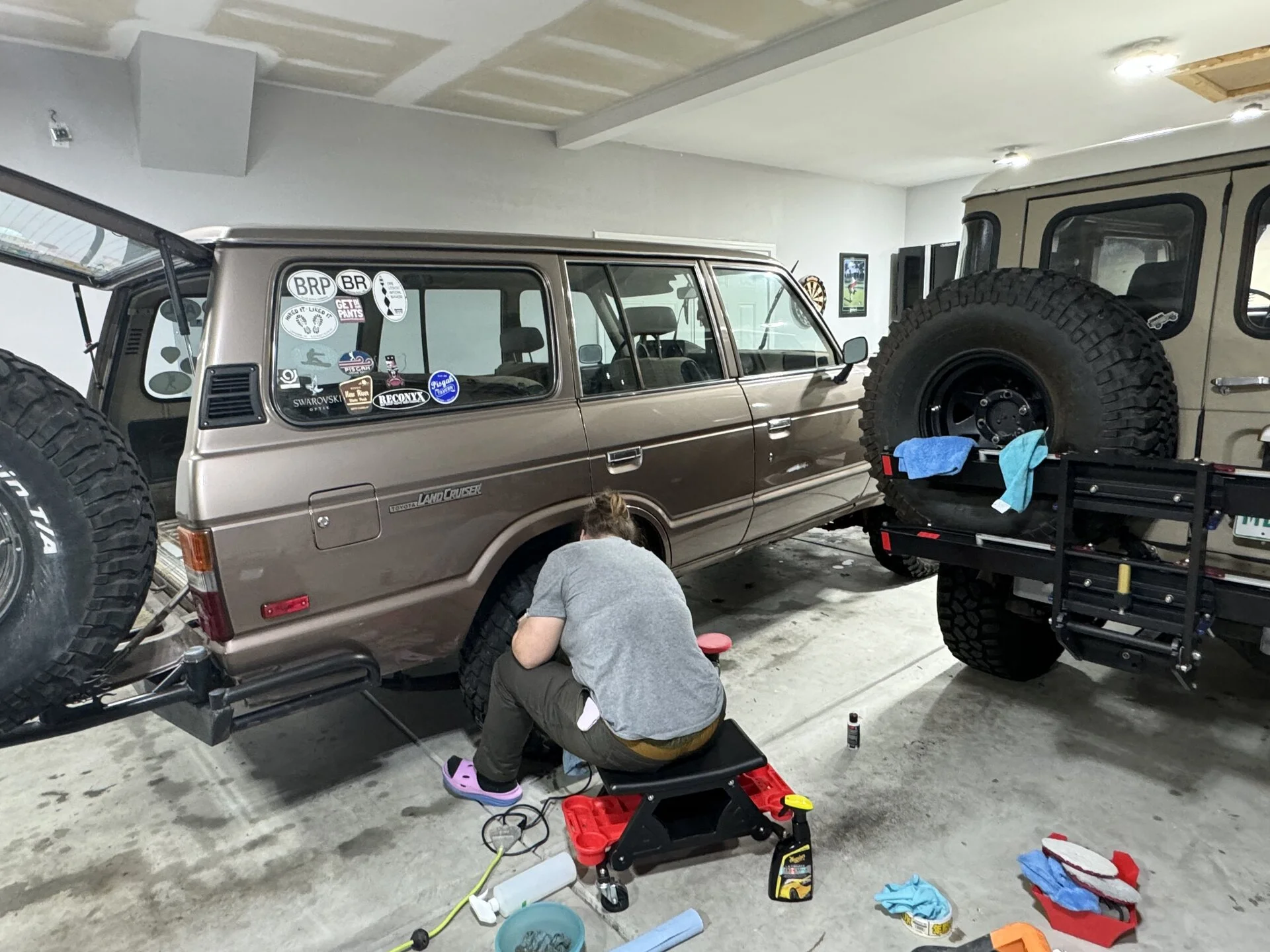

First bath in a while, clay bar, correction and polish. My wife volunteered to polish the chrome wheels, and only one broken bolt so far. Waiting on the alt and battery tray to be able to start driving it

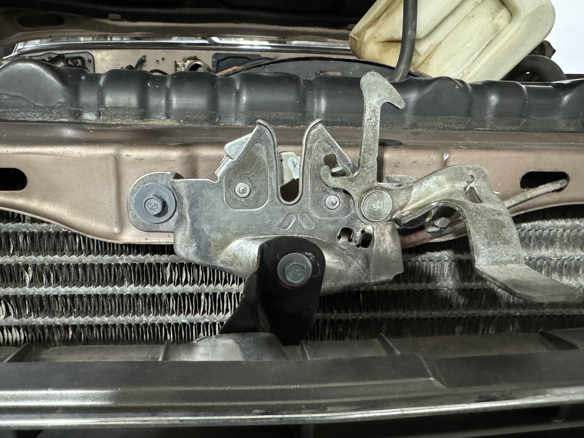

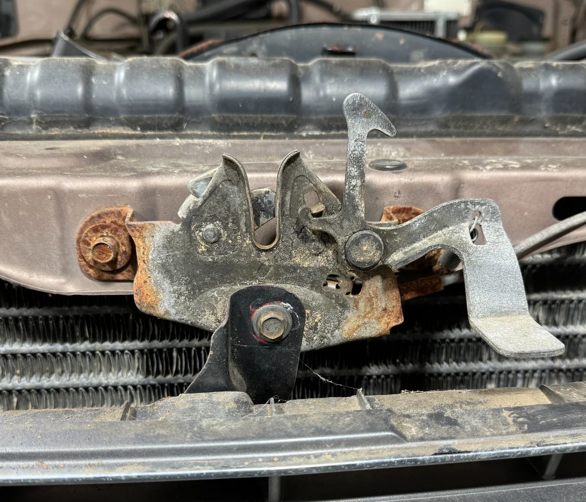

Waiting on a few key parts so I took some time tondo some rust clean up. Truck is pretty clean except for some tot in the passenger front fender area

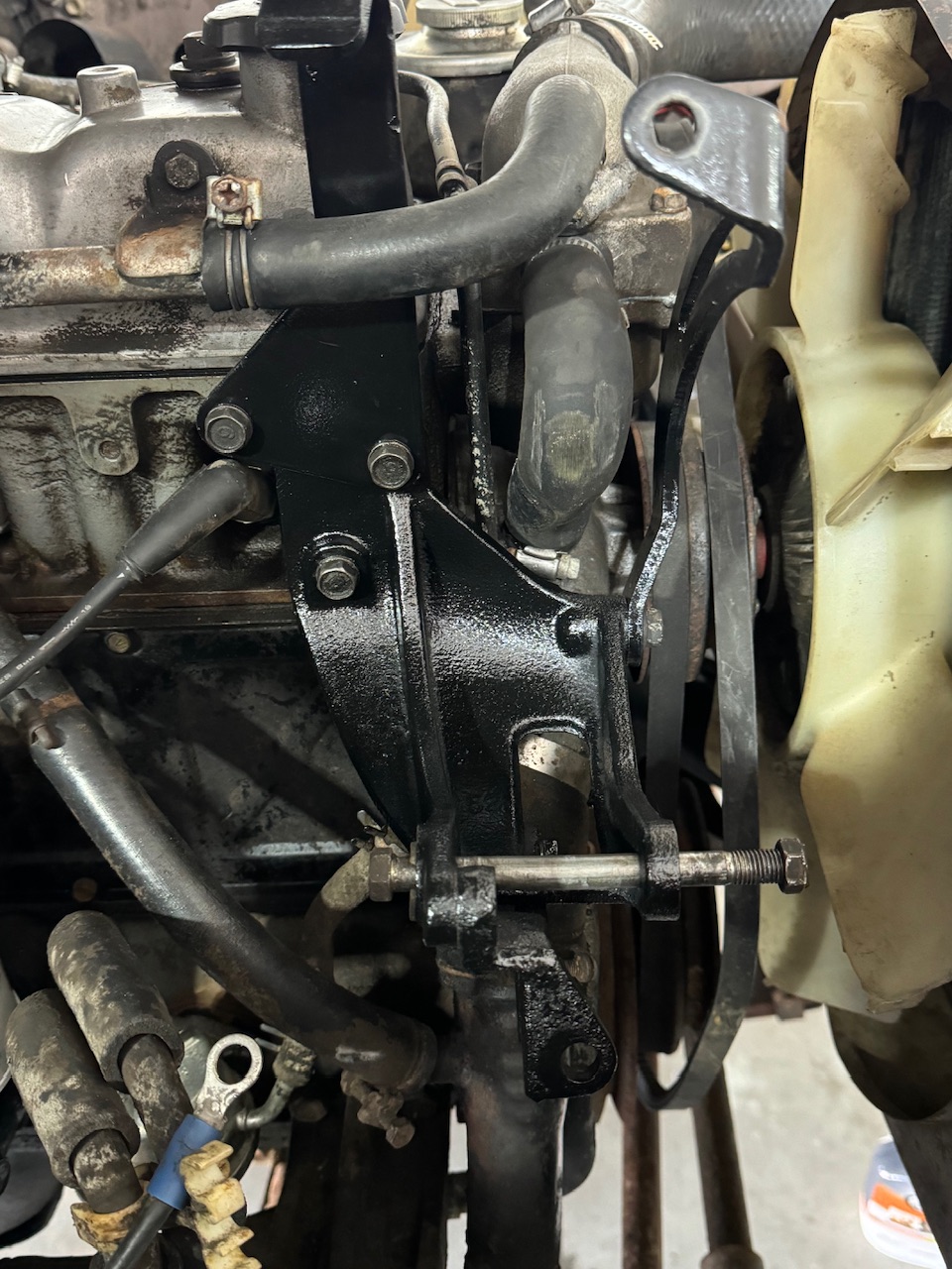

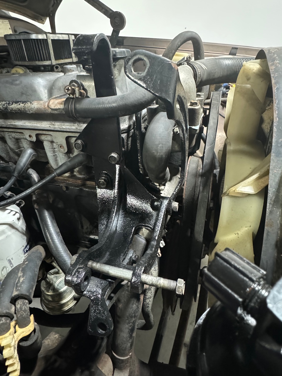

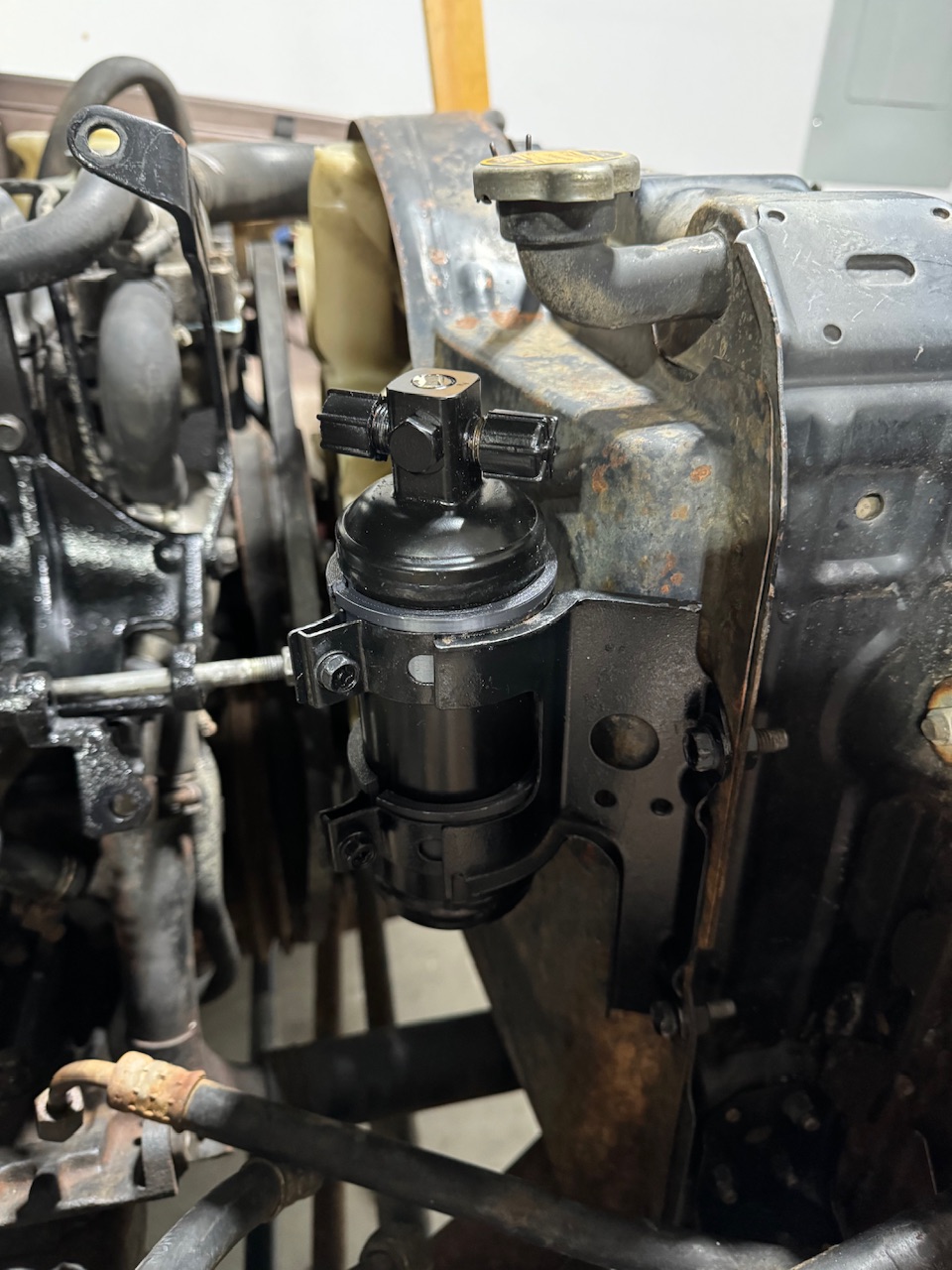

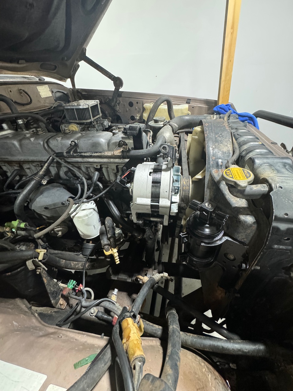

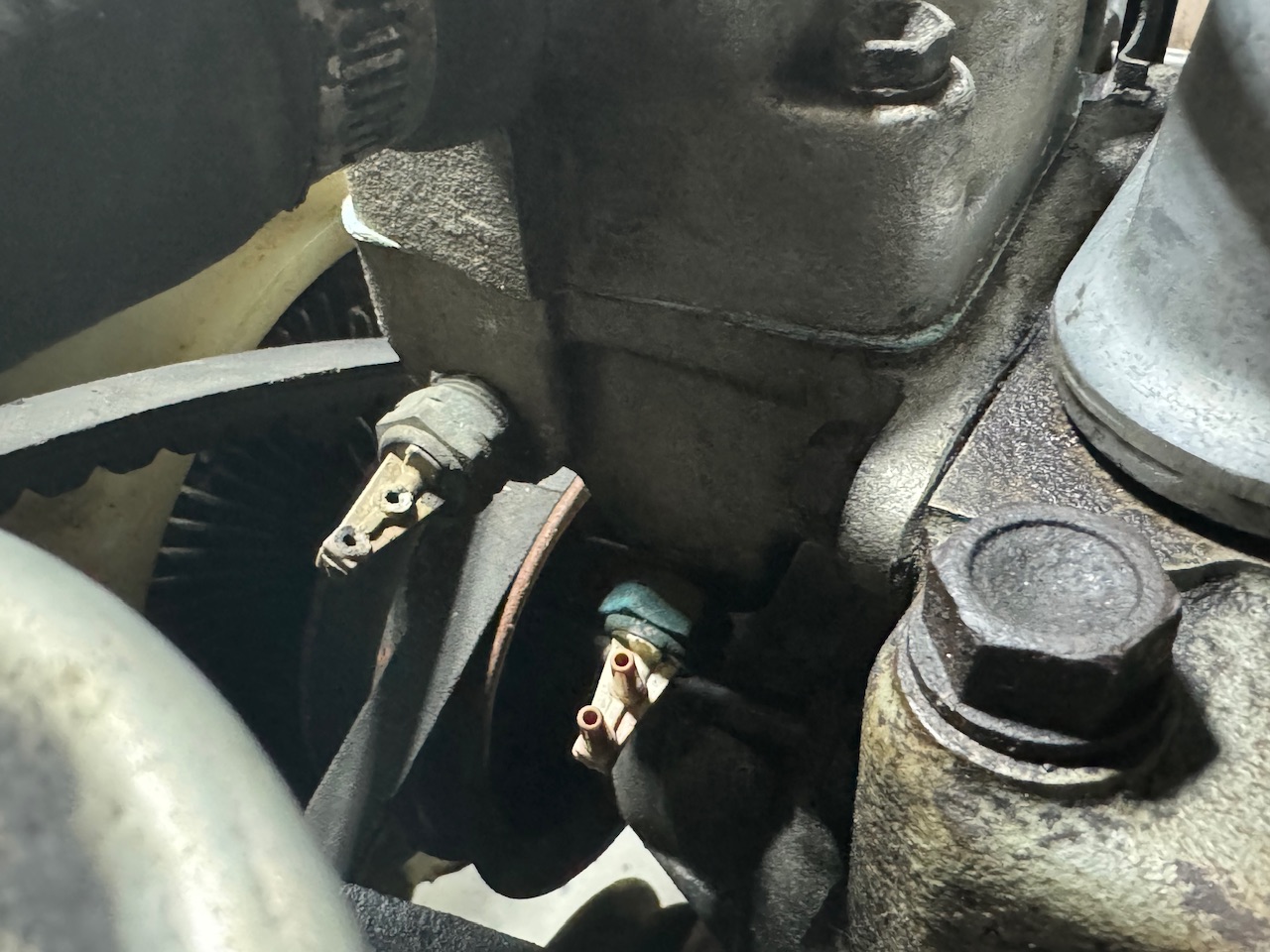

Got various parts cleaned, wire wheeled, and painted. Got a 134 drier and adapter, new alternator. Lots of PB and degreaser. Looks like sensors are broken off thermostats housing.

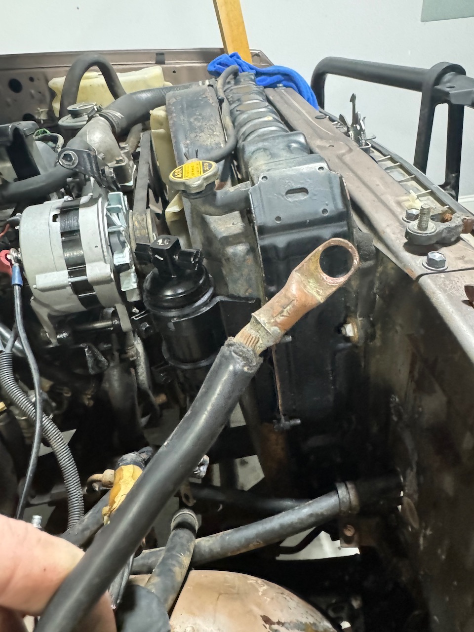

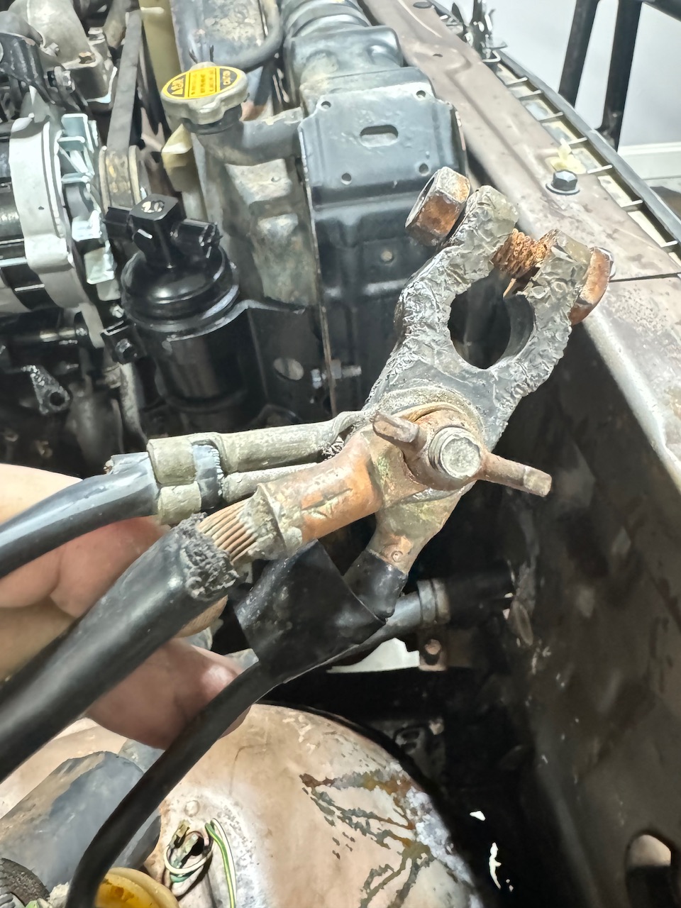

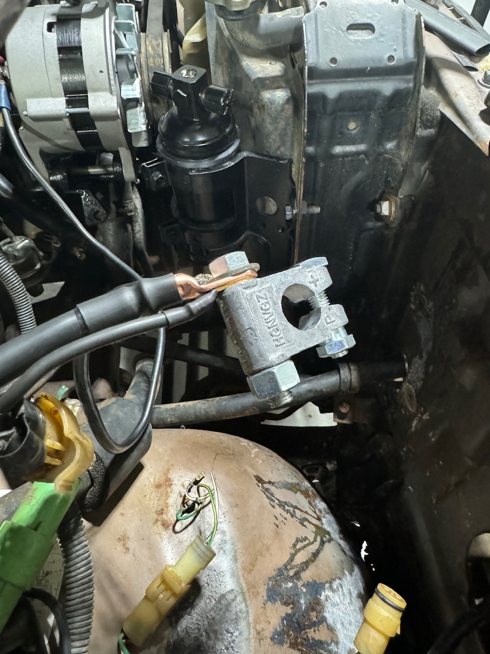

Battery terminals were rough, put on new terminals and rings. Thanks to @cruisermatt for the tray bracket. Tray should be here tomorrow so i can start putting around. Front shock lower bushings are gone so thats up next. Ive ordered 845 coolant hoses that should be fun. Going back to OE style City racer carb with factory box after that. Thanks to @roadstr6 for the daily Q&A. Going with 33x9.5s so if anyone is looking for some 31" KM3's let me know. Basically new and id love to have them sold before buying new ones.
The BVSV's in the thermostat housing are not necessary for your desmogged truck. Either get the socket head plugs from JimC or just leave them as is. It won't hurt a thing to leave them just like they are.
