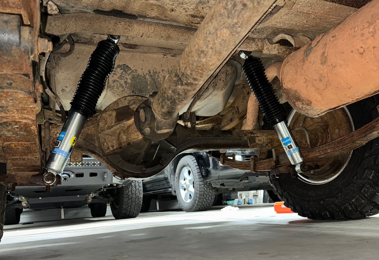

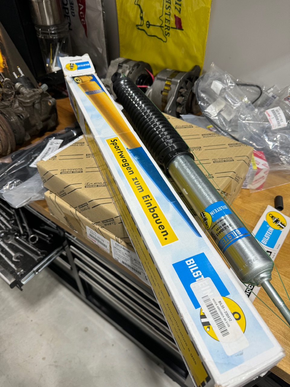

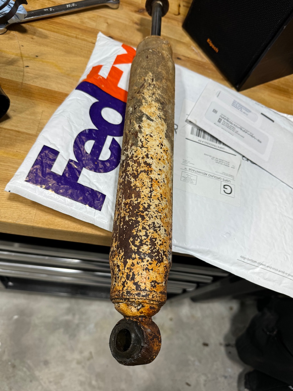

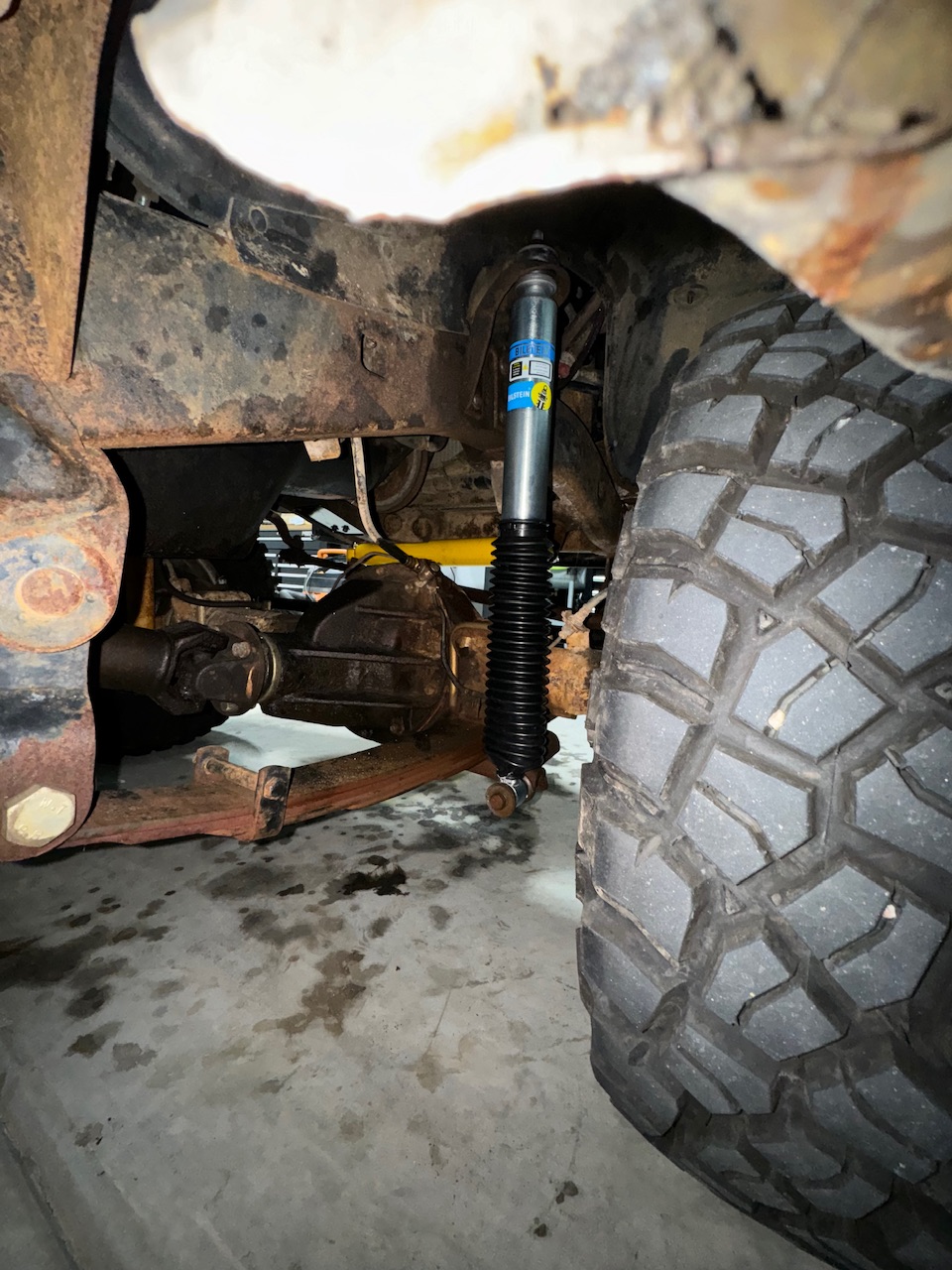

Replaced the old ProComps withBilstein 5125. Had to enlarge the front lower bushing a bit. Front are 33-230412 and rear are 33-185606

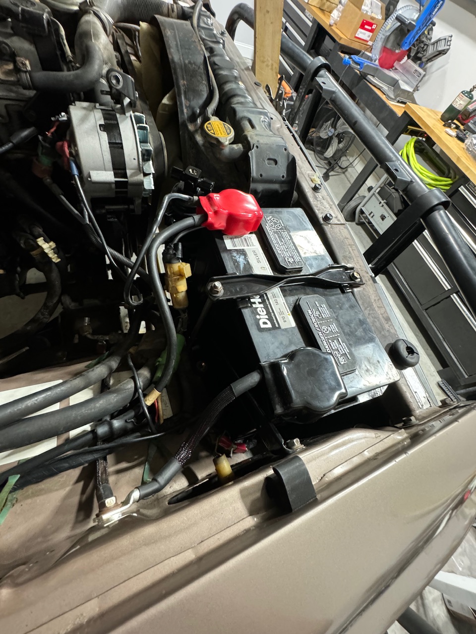

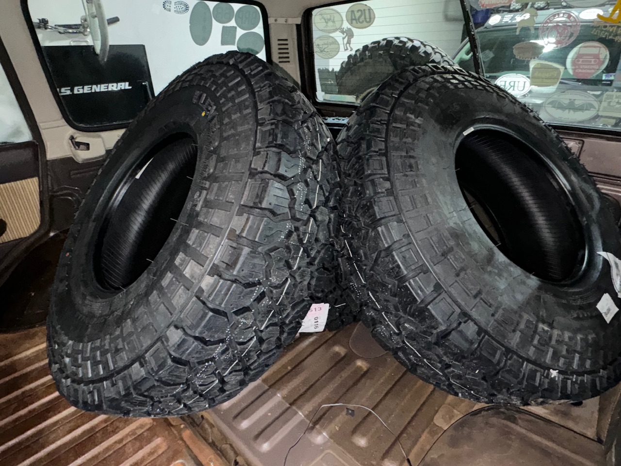

Back went on real easy. New steering stabilizer, plugs, rotor, wires, dizzy cap. Got the rusted out battery tray fixed. 33x9.5 kendas go on tomorrow
nice progress for sure! I don't know if it holds true, but I thought Bilstein shocks made it to where their name would be upright once the shocks were installed. I could be incorrect though.
You are not, i am an idiot. 🤦‍♂️. I actually thought about it too before i did it...
AFAIK it doesn't matter which way monotube shocks are mounted. Whichever provides the most clearance.
In theory they're best mounted with the tubes up so crud doesn't build up against the exterior shaft seal, but eh.
The Bilsteins are fine to be mounted either way. I usually try to mount mine with the big end on top for the same reason Johnny said. They shed dirt better that way. I usually leave off the crud catcher boots as well.

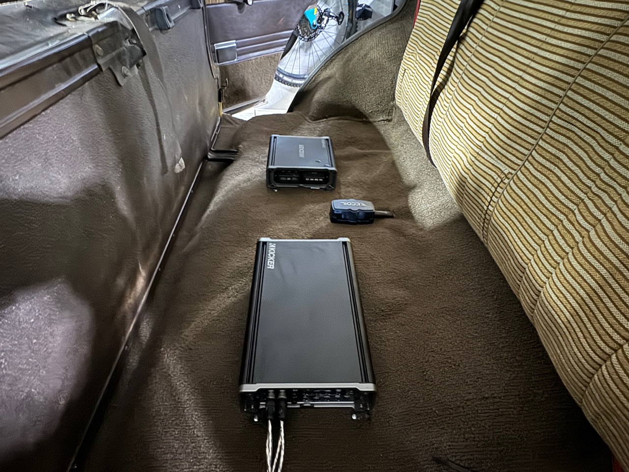

Got halfway through the audio install. Kicker 75x4 for the 6.5 components in the back and 5 1/4 ip front. Kicker 300 for the comp VR.

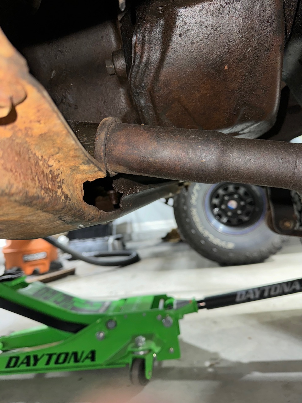

Also found this when I was dropping the Tcase lever. Looks like when they did the SR the clearanced the crossmember for the driveshaft. When i get bold ill probably drop it and try to box it up a bit
I did end up switching the shocks around. The black boots have weep holes at the bottom for water to drain out. Thanks for catching it, hopefully prevent issues down the line.

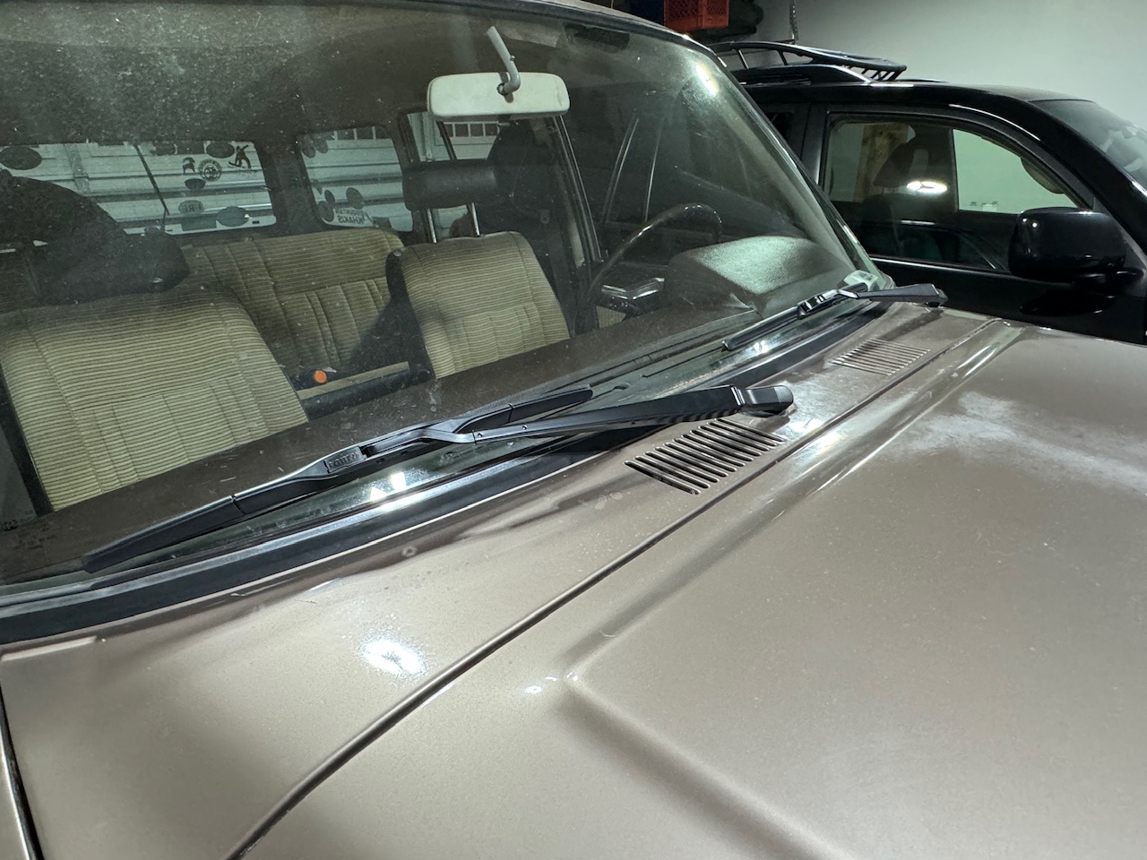

New 3rd gen 4runner wiper arms and hood strut kit from @c2dfj45. Been able to drive it the last few days. Its been enjoyable.
