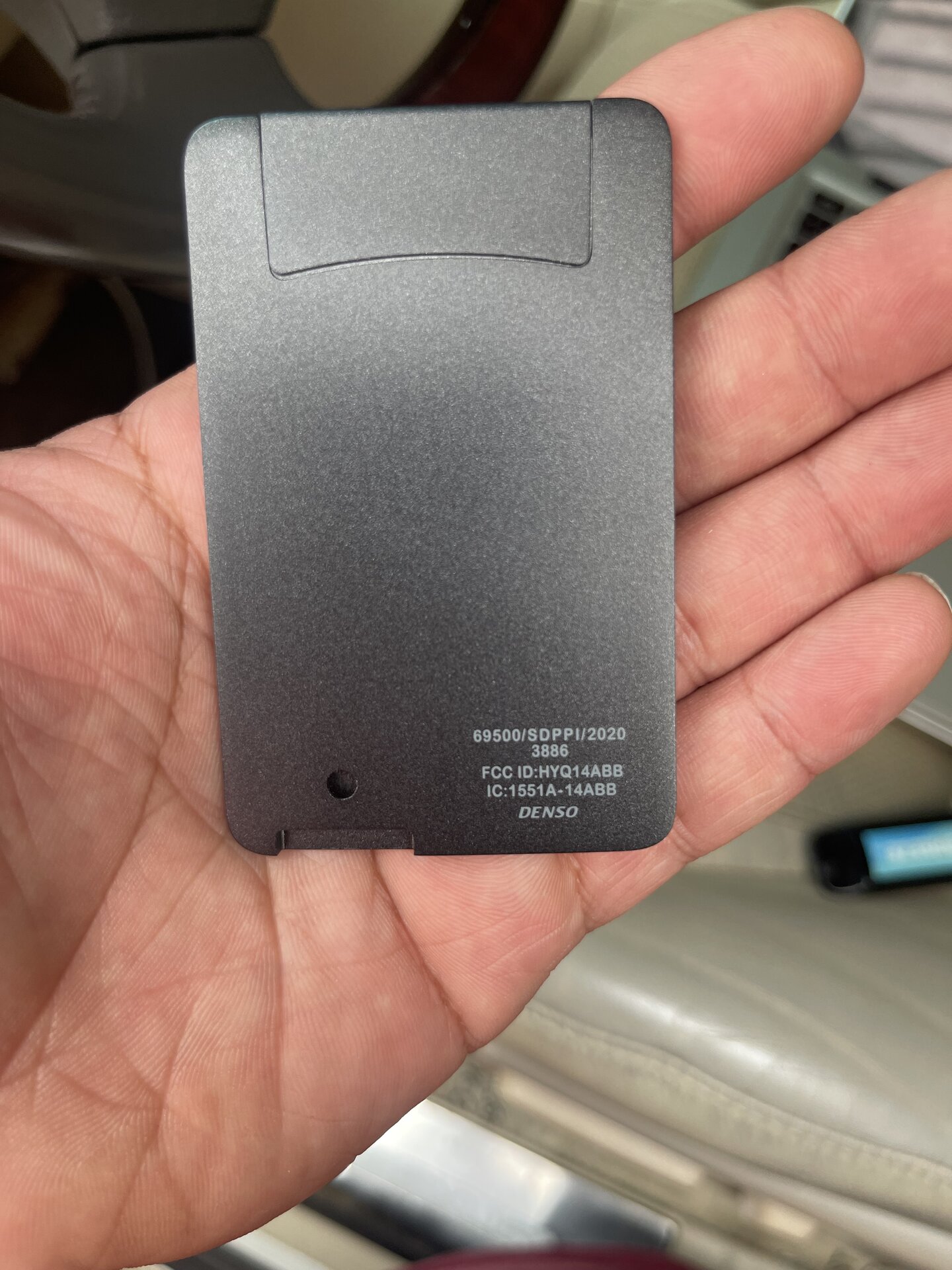

so i recently bought a keycard from this online lexus dealer, i was getting tired of carrying the keyfob so i bought a credit card key its a easy programming with techstream.

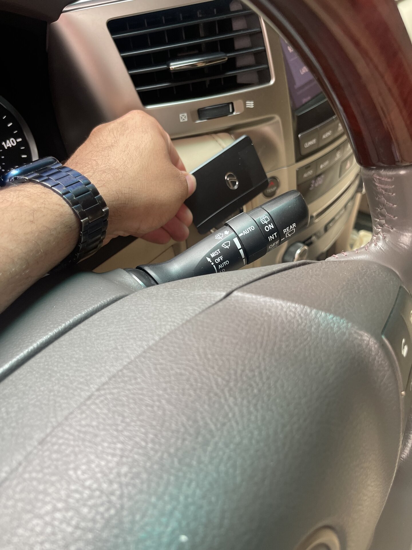

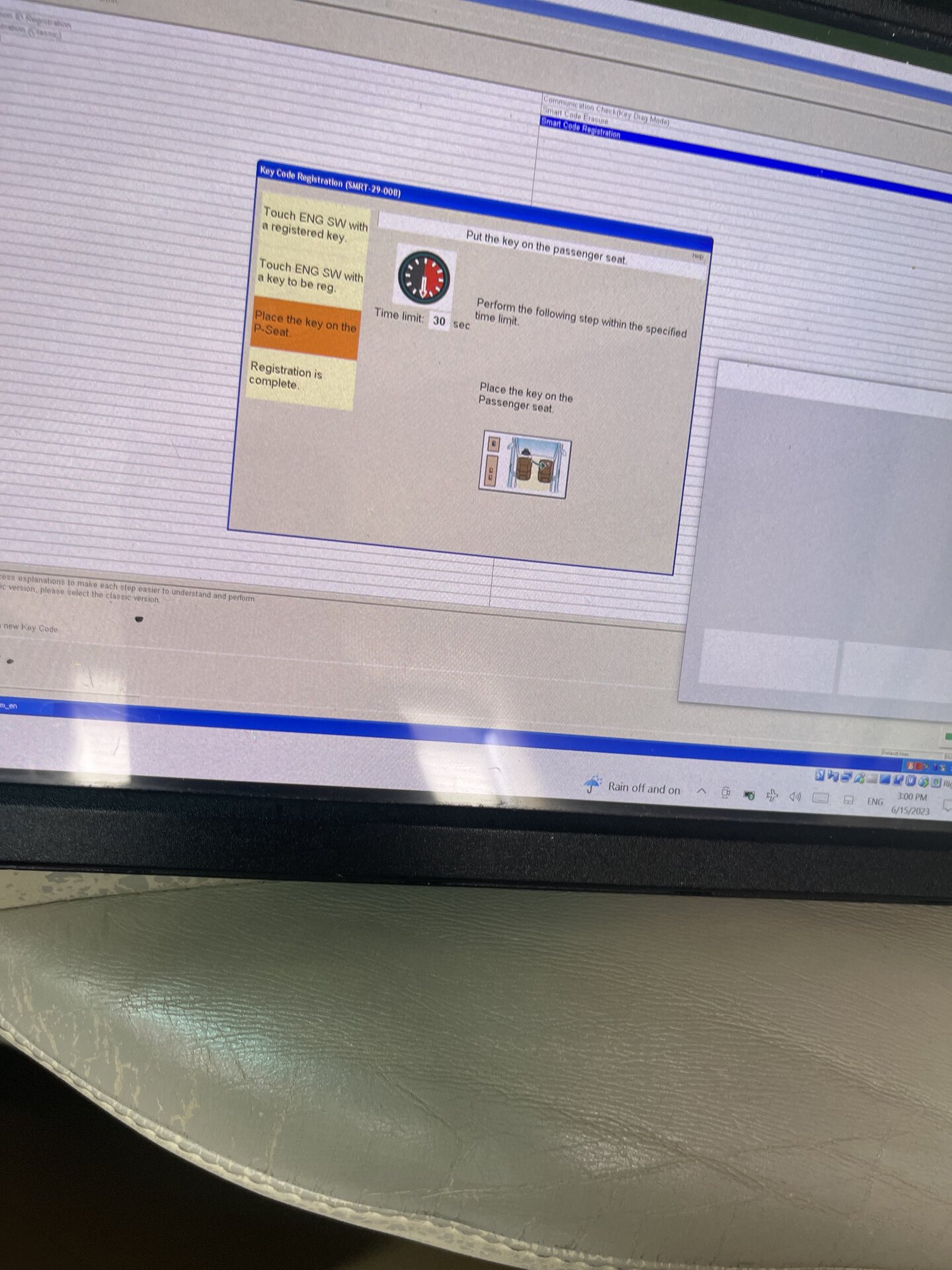

Step 1: starting up techstream
Step 2: double click on "smart access"
Step 3: double click on "utility"
Step 4: double click on "smart code registration"
Step 5: screen will pop up and check on all four instructions, press next
Step 6: it will tell you how many keys you can and already registered
Step 7: read the instructions
Step 8: select "start"
Step 9: 30 secs to place the registered key on the start/stop button YOU WILL HEAR A BEEP SOUND (right after that make sure the registered key isn't inside or near the vehicle)
Step 10: place the new credit card key on the start/stop button it will start beeping
Step 11: credit card key is registered
Before going into step 12 make sure the old key is not near the vehicle so you can test the new credit card key
Step 12: test the new credit card key. Start the engine/shut off the engine, lock the doors with the buttons, unlock the doors.

Is there a way to program it without tech stream? I only have one key I’m thinking of getting this. How thick is it, can you put it in your wallet without feeling it in your butt?
