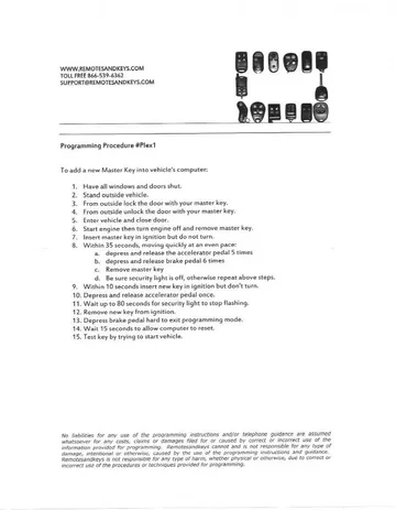

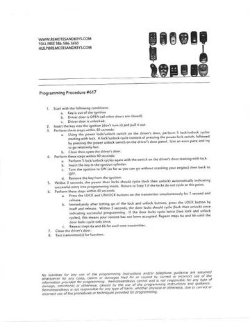

Ok, so here's my question:
I have my new key blank, and I was going to have it cut here at the local locksmith. They CANNOT code the key to the vehicle, JUST do a basic inner cut (LX470).
Once that's done, I'm assuming I'll have a key that will just unlock the doors and that's it.
After that, I was going to follow the programming instructions that came with the key. If I do that, will I be able to use the buttons to lock/unlock the doors AS WELL as starting the vehicle? OR does the transponder chip in there require some other type of programming (something I cannot do without equipment) to make it work to actually start the vehicle due to its ignition code?
I'm just wanting to make sure that the programming instructions that were included in this thread (earlier posted) will make it work to actually START the vehicle AND make the buttons work.
Some of you guys were mentioning something about a techstream (I don't know what that is, or how it relates at all to this) however that's making me a bit nervous now before I cut the key without the proper knowledge of doing this correctly.
Any input is great appreciated!
Here's a picture of the instructions that came with it (there were 2 pages):
It looks like following the bottom instructions will code the new master, and following the top instructions should set the buttons to work; is this correct?
