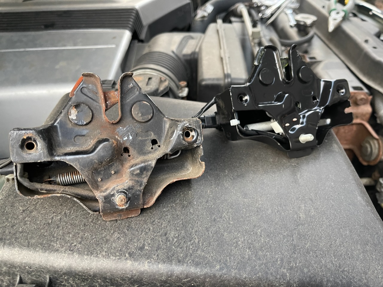

I had the same issue, and occasional difficulty closing the hood, on my ‘00LC and was able to fix by replacing the entire latch. The new spring seems to pull the cable nice and tight now, and the hood has a nice “pop” when pulling the lever in the cab.
There are two bolts and one nut to remove, and then the latch drops down to where you can get your fingers in there to pull the latch alarm sensor cable and I used needle-nosed pliers to get the cable off. Removing the hood release hand lever fully helped a bit. Then you can rotate the latch and just barely slide it out on the passenger side of the center vertical grill support.
