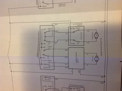

You have obviously have shorted something out that's why all manuals say disconnect the negative battery cable as a first instruction. I think you need to pull the door panel completely off to make sure you don't have any toasted wires. Can you hear the relay click when the switch is activated. I've seen relays fail without and signs or smells. I would use a jumper wire to bypass the relay do u have a wiring diagram or a test light?
Ok, finally had some time off to repair the window. I found the wires power supply to the locks and the power supply to the windows , same fuse but the power supply to the windows was dead. I used a jumper to route power from the locks to the window and they work minus the "auto" down and up feature. I have no idea why the power supply to the windows is dead since it's on the same fuse at the power locks. Do you see any problem with splicing and routing power from the locks to run the windows also? Thanks!
I would trace the problem down to the loss. Have you verified the grounds are good when electricity grounds itself through other means I. A switch you can get some odd acting electrical devices
...via IH8MUD app
image.webp image.webp Hope this helps, good luck
