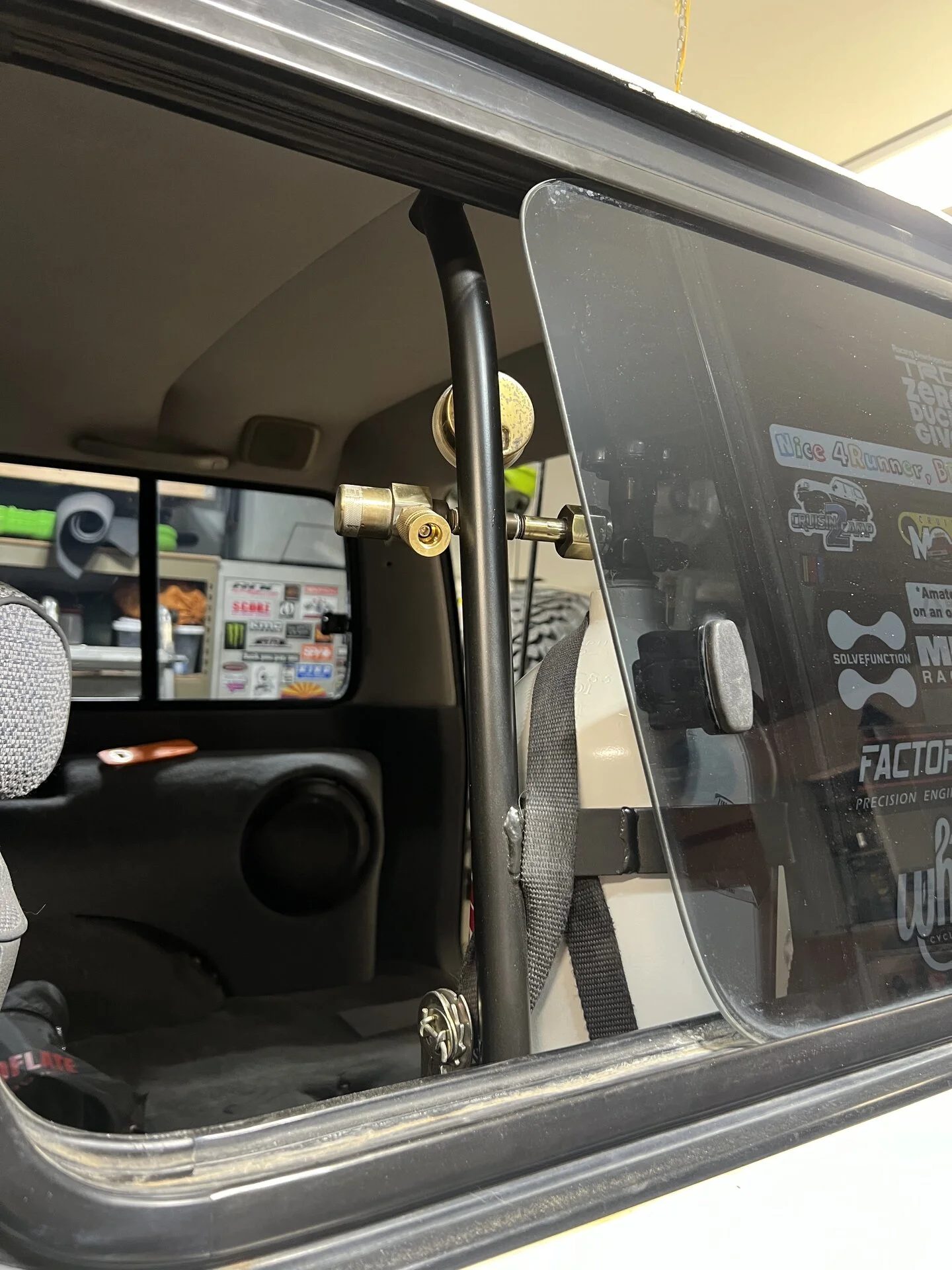

I keep the tank wedged between front of drawers and rear passenger seat. Takes me no time to lift it out and go wheel to wheel. I have 32.5” tires, the CO2 brings them from 15psi to 42psi in 30-40 seconds each. Just have to watch for cold nip from the valve after a few tires.
But yeah the price for a fill has increased from $15 to $44 in the last three years. And I do have to flush the CO2 out when I get back home to avoid pressure decay.
