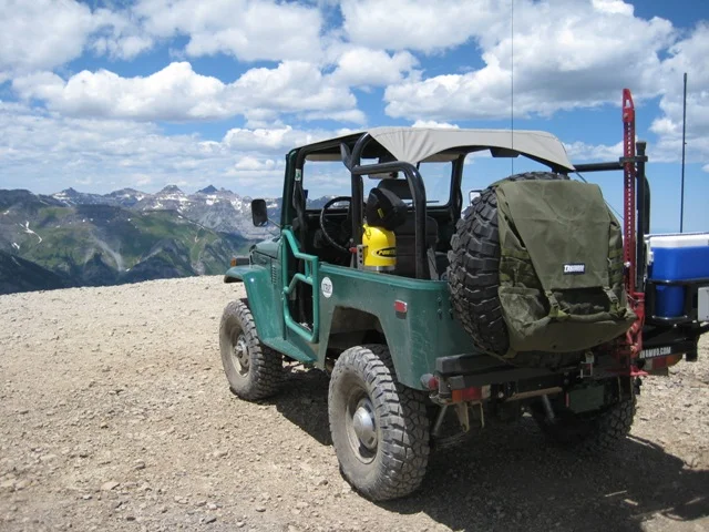

The liquid and gas phases don't need to settle. If you store it laying down, just set it upright before you open the regulator valve. Powertank sells an upright holder/mount for their tanks. I put mine on the B pillar of my roll cage; with the top off, I can reach all four tires with the Powertank coiled hose, without removing the tank from it's mount. Makes it even faster to air up.

Powertank user for 15+ years now, so I thought I'd chime in. CO2 does permeate the tires, so pressures will drop over time - not so much an issue in the summer, when we'd be on and off the beach multiple times a week, but at the end of the season I'd have to remember to find a "regular" air chuck somewhere and air down & back up to replace as much of the CO2 as possible.
CO2 is in liquid state in the bottle, so as others have said you can store it horizontal, tip it up when you're ready to air up and it's immediately ready to go - no waiting. Not that I ever had an issue, but it's "like" carrying a CO2 fire extinguisher, so I can't image getting into "trouble" for carrying bottled gas without a placard or in violation of some rule or reg. Pressure is constant across the full tank payload, until all of the liquid is gone. You can feel how full the tank is, with the liquid sloshing around inside, so it's easy to know when to go get it refilled. I've never been worried about leaks, as the regulator can be turned off in addition to the master valve for the tank itself. I have the big 20lb tank, which would last for many, many cycles of down and then back up, although this was for lower volume street tires on LCs and Mercedes GLSs, not the 33 / 34 / 35 AT monsters that some people run. YMMV. I used the local fire extinguisher place - $25 / fill as I recall; leave it there and pick it up the next day, usually, although I did wait once. A bit annoying to remove the PowerTank guard and regulator each time, but I'd rather not have someone else fooling with those. I ditched the Powertank trigger fill handle with analog gauge and use an Astro Pneumatic digital gauge/handle combo on the end of their coiled hose, but will probably be ordering their new gauge/handle combo soon, as it looks pretty slick. My tank has been hydro tested twice now I think.
