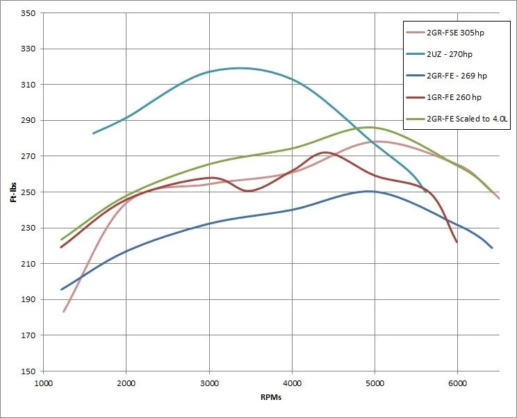

That's right where the power band tops out, you're feeling the full power of the engine. Then it drops off from there.
