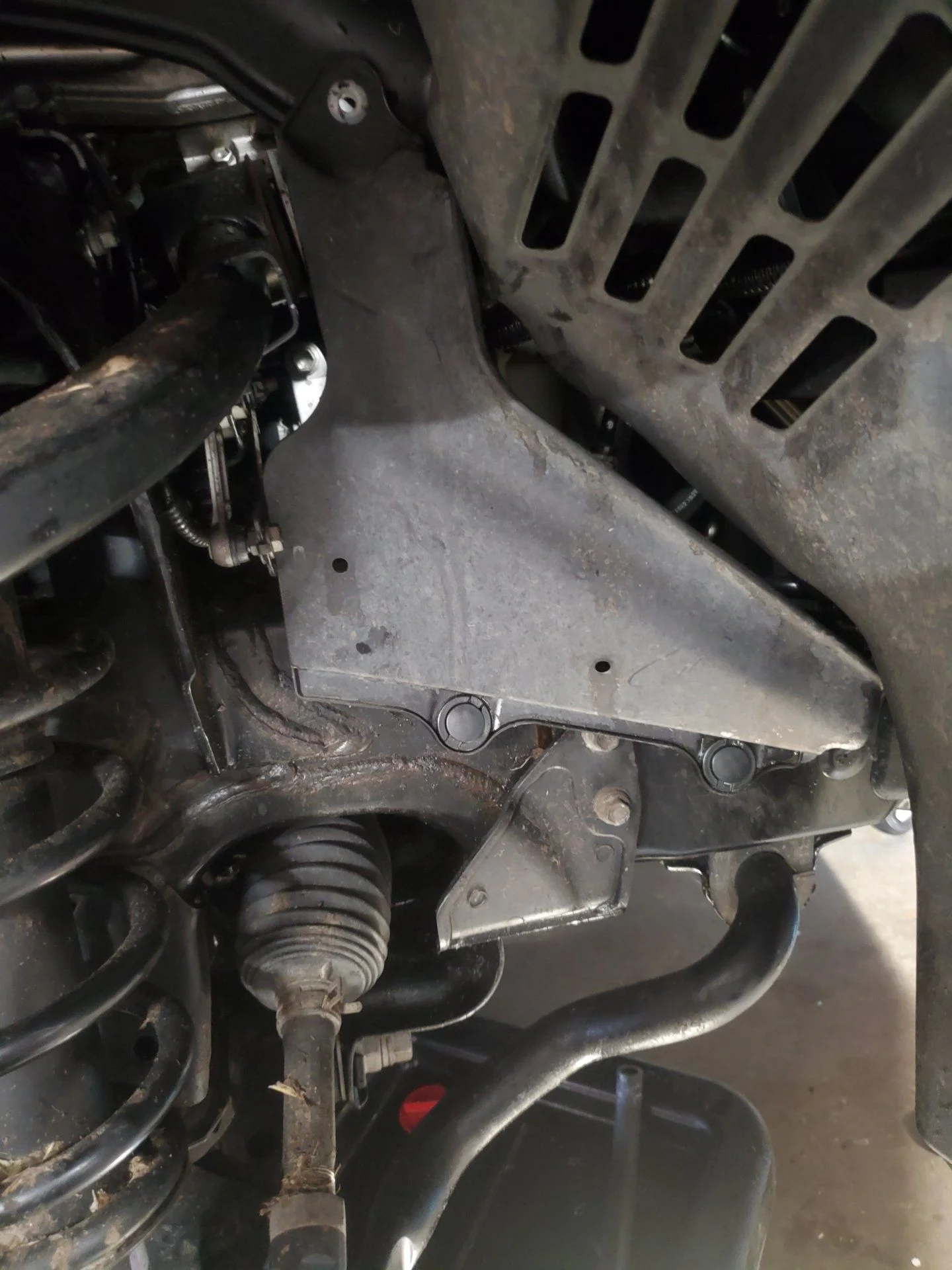

Finally pump is removed. Easy access. Now I'm waiting for parts.Thanks for the directions. I found metal shavings in reservoir. I've clean it well but I wonder if the shavings damaged rack and pinion. I'm planning to flush the system by disconnecting the return line the reservoir. Any other suggestions?
