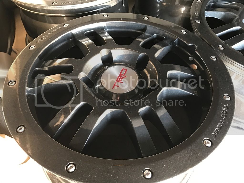

I powder coated mine for about $400. I ended up going with a very dark grey for both the wheel and the bead-lock ring. I left the lug nuts chrome and bought new center caps. The chrome accents of the lug nuts, ring screws and TRD center cap look great IMO. I was reluctant to go with a glossy finish and to leave chrome accents but so happy i did. To me flat black or matte black wheels look lie cheap spray paint.
I forgot to add a bit of advice- make sure your powder-coater tapes off the inside of the wheel where it mounts over the hub. The rock warriors are very tight to begin with and just a mm of powder coat made it very difficult to mount. it took me about an hour with a grinder to remove the finish just so i could mount the wheel on the LC hubs.
I have rock warrior wheels and I had them powder coated a dark grey color to match my grey LC. I painted the center caps myself with a high quality spray paint. I had the rings powder coated as well. I bought black lug nuts online, maybe McGuard brand? No problems so far.
