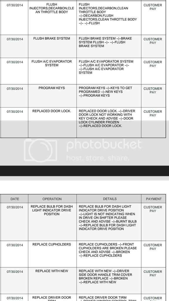

Last time it touched a dealer was 2 year or ~8k ago.
[/URL][/IMG]
looks good but it is a lot of nothing (dont want to nag)
cup holder :cheers::cheers:
I rather see belts, oil, diff oil, valves, engine and chassis stuff. light bilb is irrelevant.
injector flush bla is just a bottle of poison in fuel?
