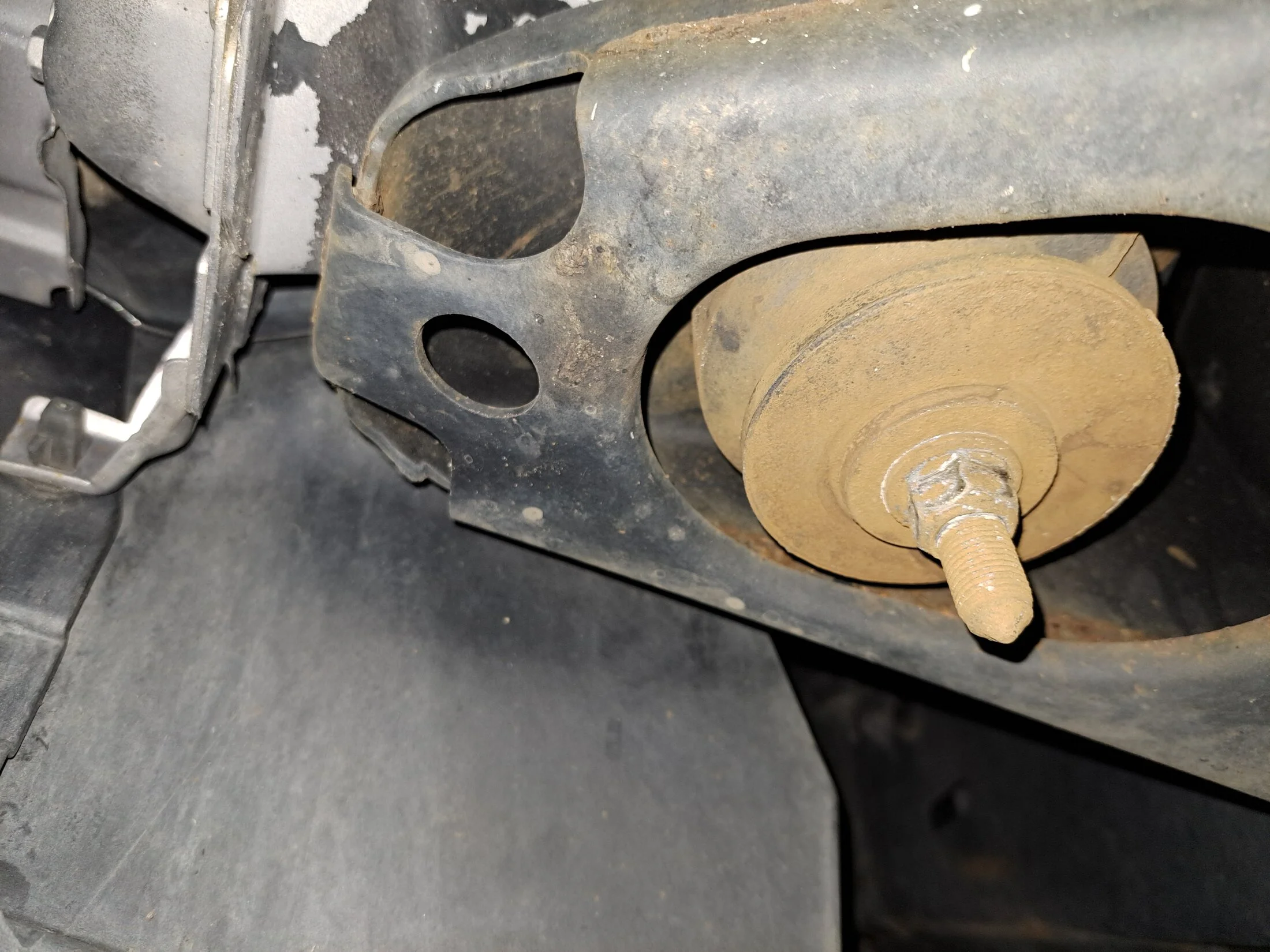

@TTO5 @Sinister Can you guys post a pic with the bolts circled? I'm daft and intermittently heard this sound a long time ago and have since gotten used to it. TIA.
Yes I'll get a pic put on here. The bolt takes a 17mm socket. Not sure what torque spec is so tighten at your own risk. Stay tuned for a pic
This is the mount I tightened. Driver side next to the running board just behind front mudflap.
Thank you! How tight did you go? I saw two turns with impact, but I don’t know if you could give some approx lb ft it’s supposed to be.
