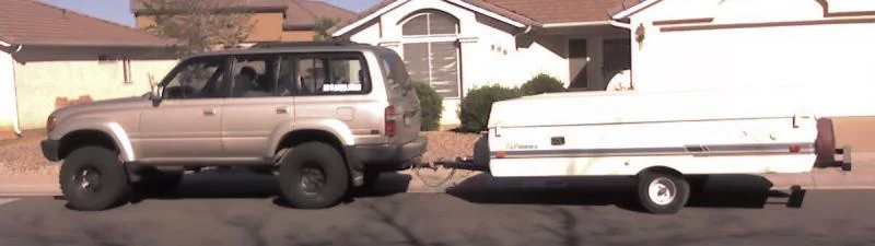

Pop up spring over and tires......

With shocks on the way and a little frame reenforcement I think it will do ok.
In a week I will drag the thing through DV! so we will see..... :popcorn::popcorn:

Gret job on th SOA. I did a SOA conversoin on my 88 Coleman Williamsburg. Made a huge difference. I like to camp off the pavement. Pop ups are a great way to do it and be very comfortable.
