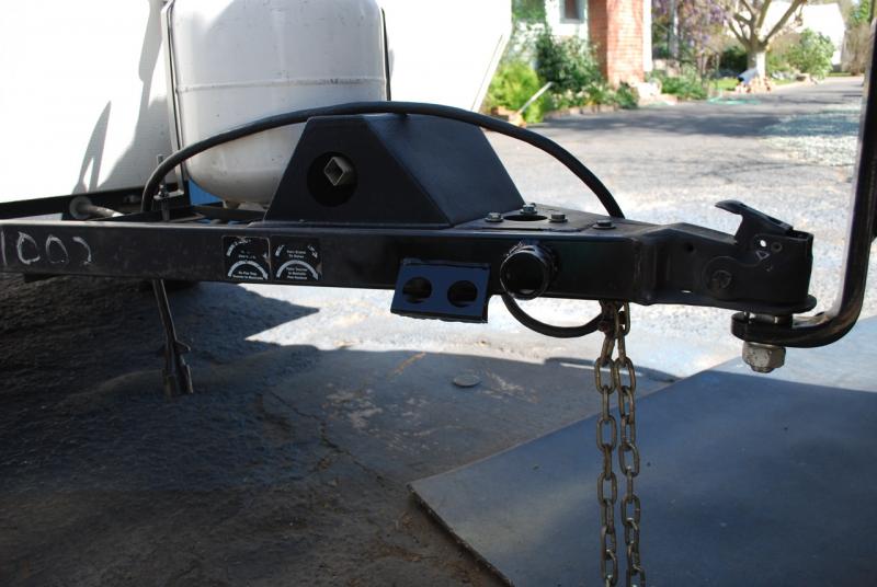

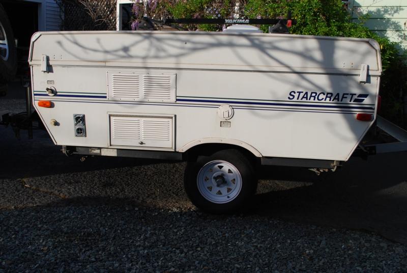

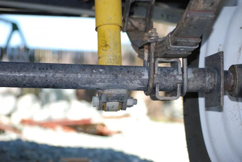

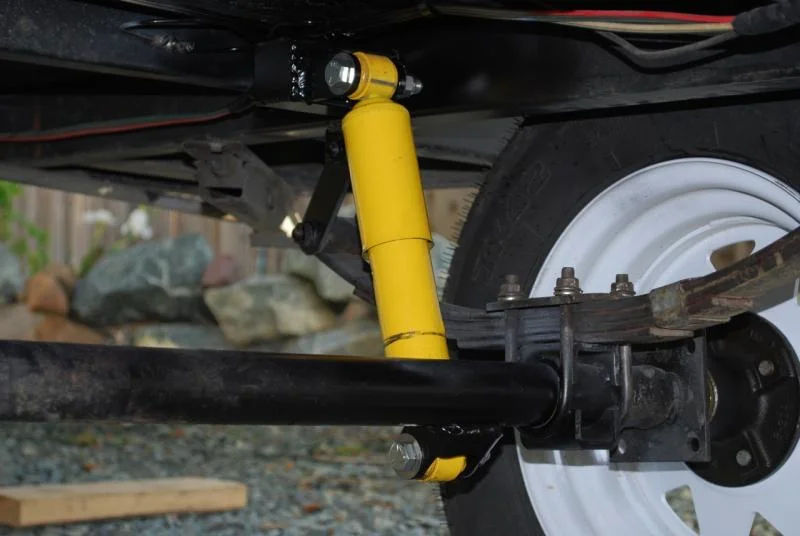

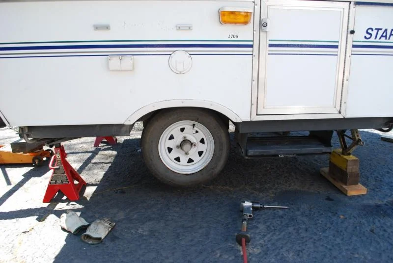

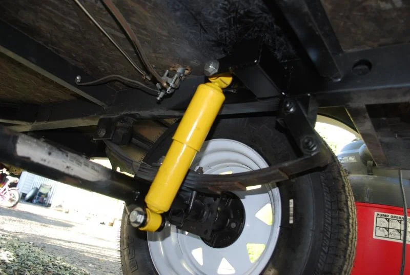

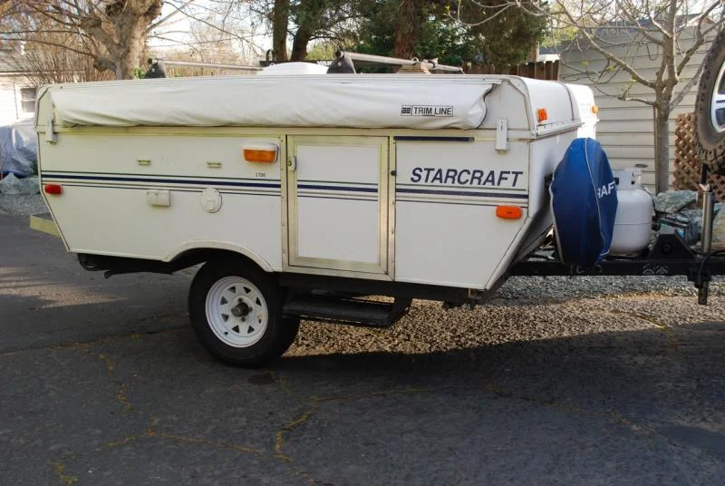

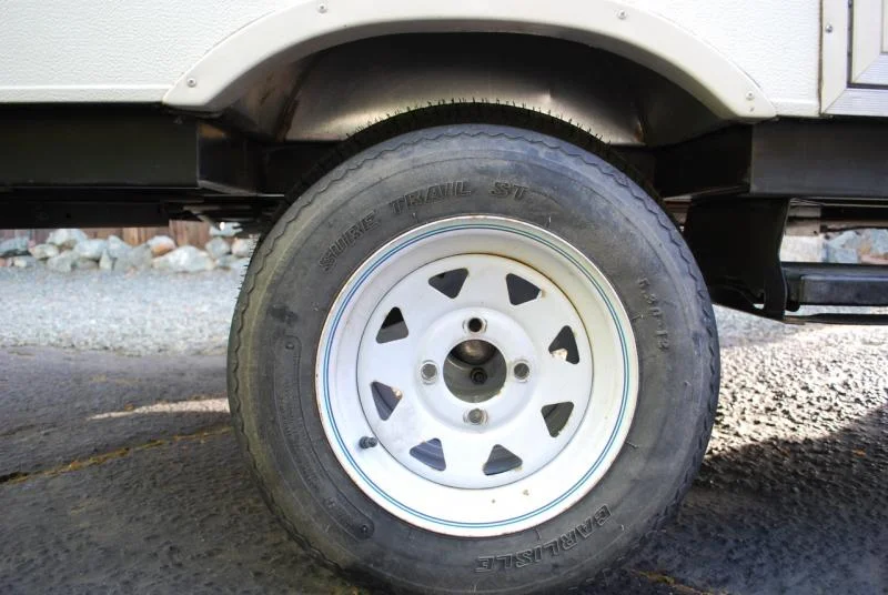

Finally got around to lifting up the tent trailer, did a spring over and added some 13" wheels and larger tires . I still need to install the pipe mount tounge jack and figure how to find super small shocks.????? Still pulls nice and true.
Here are some before and after shots.....

I was wondering what you did to spring it over .
Ive seen kits for doing this and I need to do my Starcraft too.
thanks

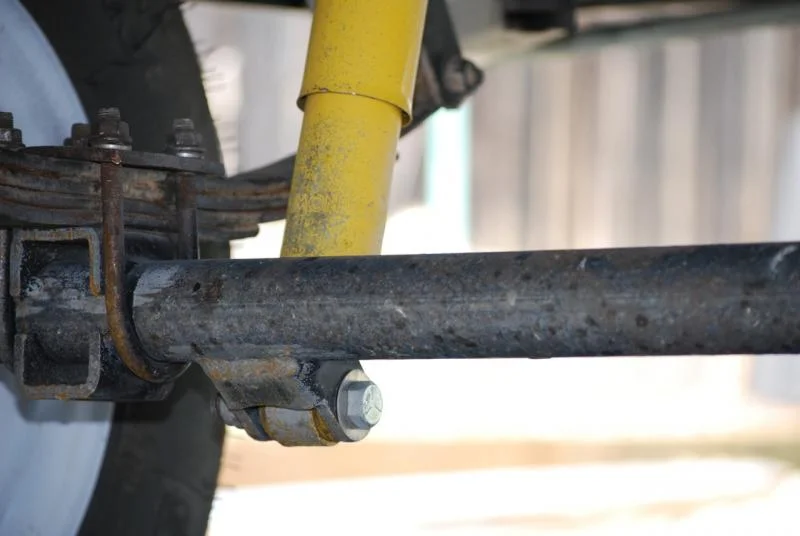

Yes there are kits available for some axels that are a bolt on deal.
The axel I have is a Dexter 1-3/4" and they dont make a kit for that size.
Dexter does however make a kit for the next size up. All I did is weld 2 new perches on the other side , pretty straight forward (sans the warn hardware and loose wheel bearings):mad:

With shocks on the way and a little frame reenforcement I think it will do ok.

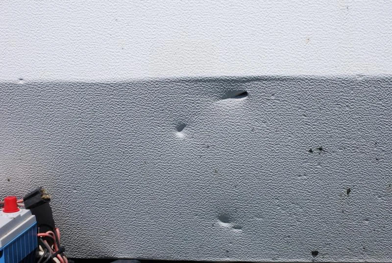

Well I put it to the test , It did better than expected . Cant really say that about the paint.
Now I need to make some kinda rock guard or mud flaps or both.???
ken
ken
