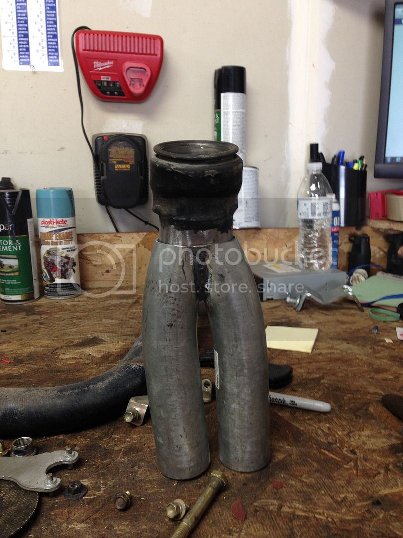

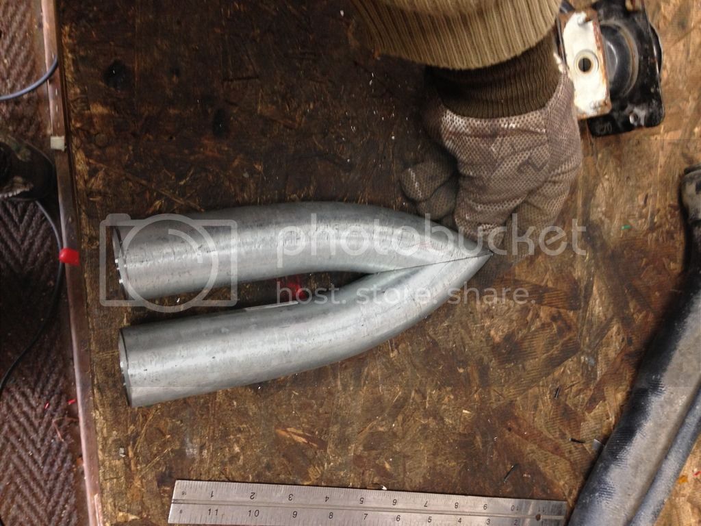

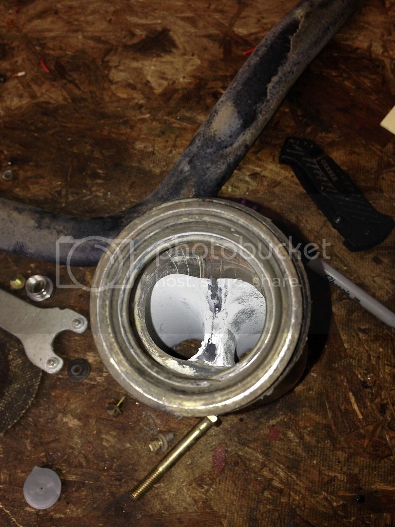

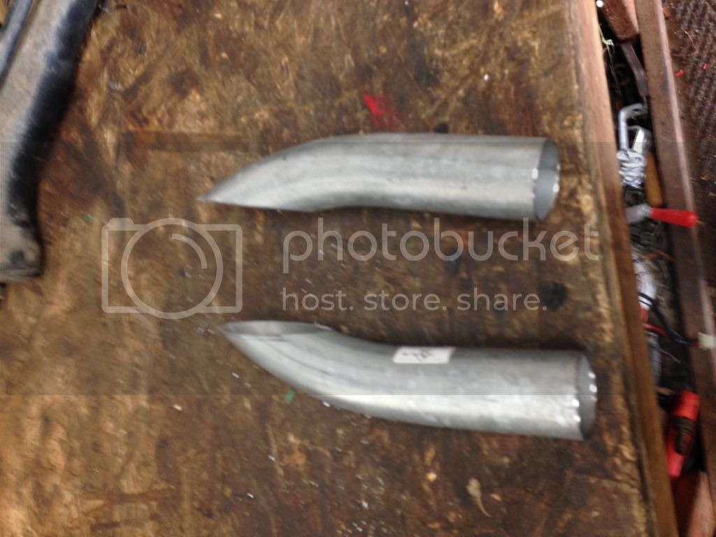

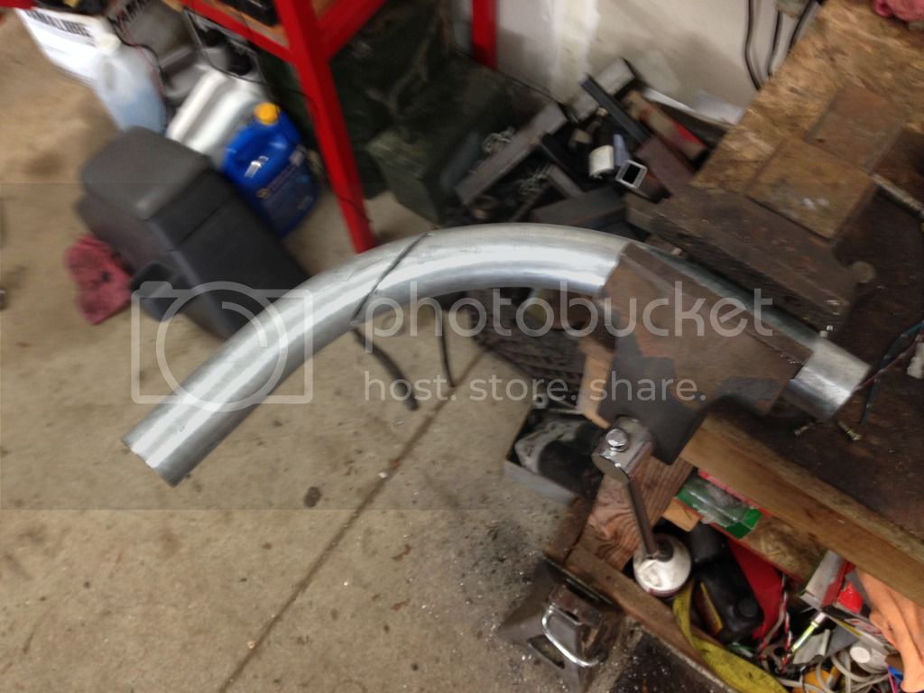

i m working on dual filler neck every time i start on it i come up with better idea
whole idea is to stay cheap and be 100 % funcional
i will use pump what is in the aux tank , any pump can fail but if transfer pump fails there is drain plug on the bottom of the tank take it off and fill bottle ,can or ... and dump it in main tank so there is solution
Do yourself a favor and cut a hole in the floor to access the tank pump. I used an 8" round screw down boat on my V8 FJ60 big tank.
i know , i usually grind galvanizing off and use fan when wld that stuff
and the metal pipe i 1 1/2 inch and it is conduit 6 $ so far my project is on super low budget
Brilliant idea for a DIY dual filler neck. Definitely worth copying (or at lest storing for future use) if you don't mind!
i don't mind

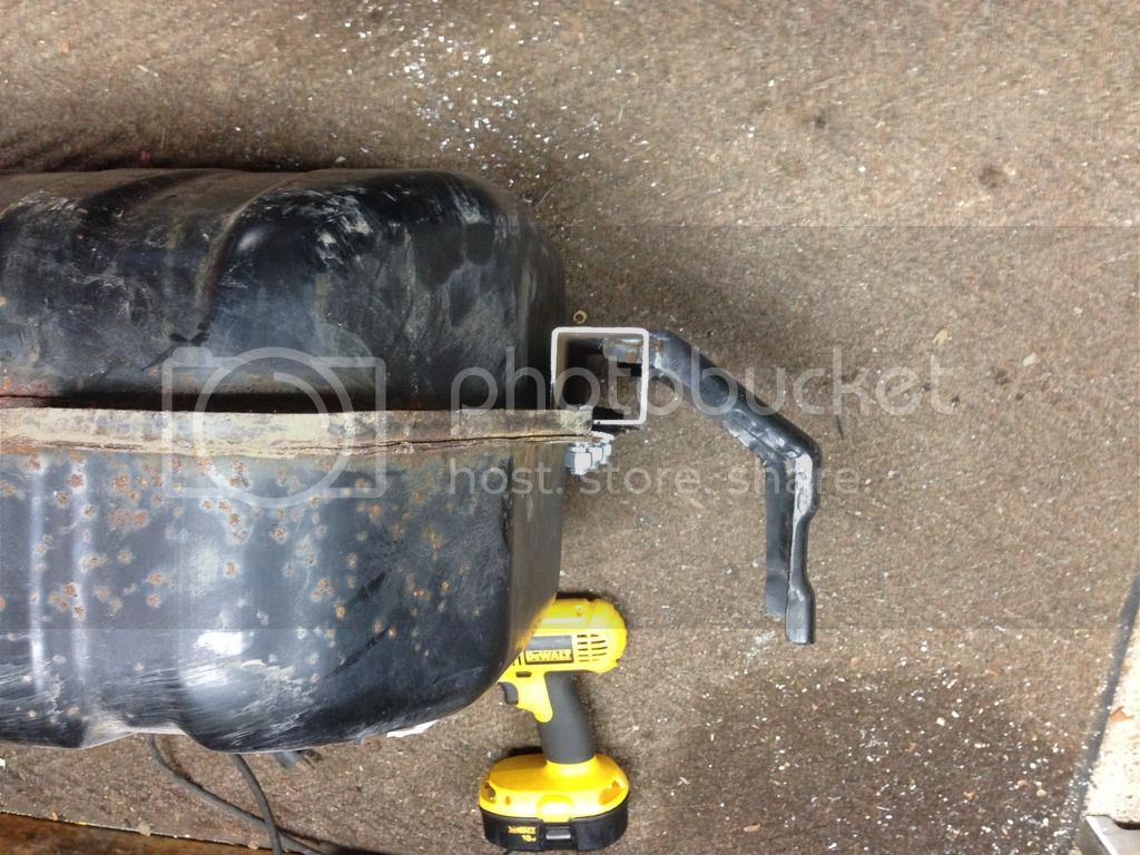

it is in , fits excellent all is left wiring and plumbing
Looks great! I am not questioning your design. But instead of using two separate mounts that only support it by the seam, why not run a plate under the tank join the two mounts into one mount. Come to think about it you could expand it into a skid plate of sorts to offer a little protection for the tank and mount it as well.
Picked up one of these from a local pick and pull today. $30. but has nice drain hole they punched in the bottom :(
The mounts on the trooper are welded onto the frame, and the bolts come from the top, so anyone getting one from the pick and pull yard, be sure to take some Advil first or your more limber kid to help.
