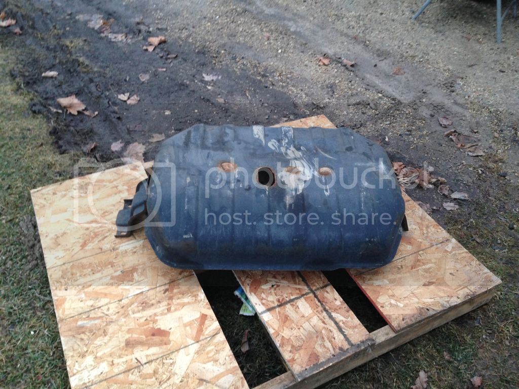

starting my auxiliary tank installation don't have all parts but will post pictures as i go

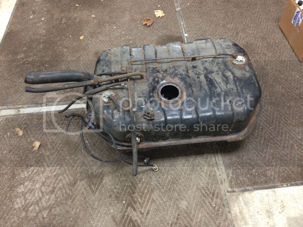

got the tank off salvage yard for 50 $ with sending unit and bottom protective metal i got some idea about dual fill but not done yet ..
So what's the tank out of?
Are you going to do anything about the rust?
Por-15 on the outside would be fine
If you meant their gas tank sealant for the inside just a word of caution. Yohavos on here documented his lining deteriorating after a few years use. Suspicions lie on the ethanol blends so depending on your location may not be a concern to you. Just a Heads up.
Otherwise carry on and keep us posted of the results. That would almost double your range

For some reason, I thought that the Isuzu Trooper tank comes with a killer skid plate. The tank is totally supported by this skid plate which has all the mounting stuff attached to it. Wish I can find a picture of this on my hdd but unable to thus far.

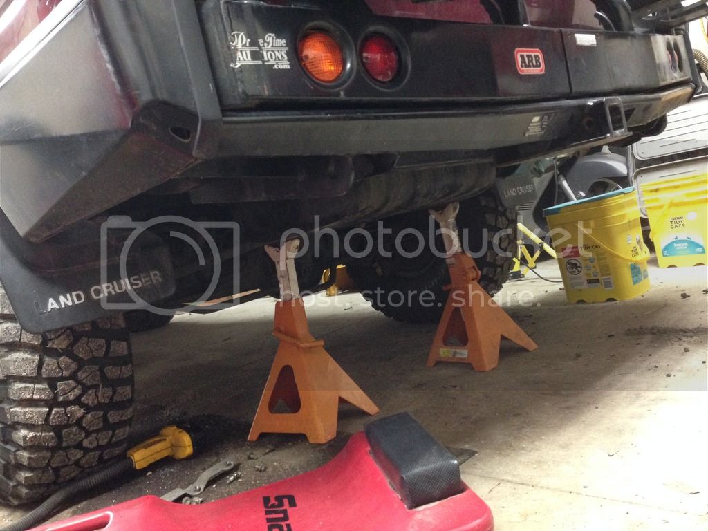

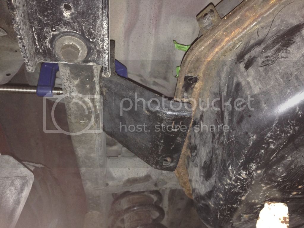

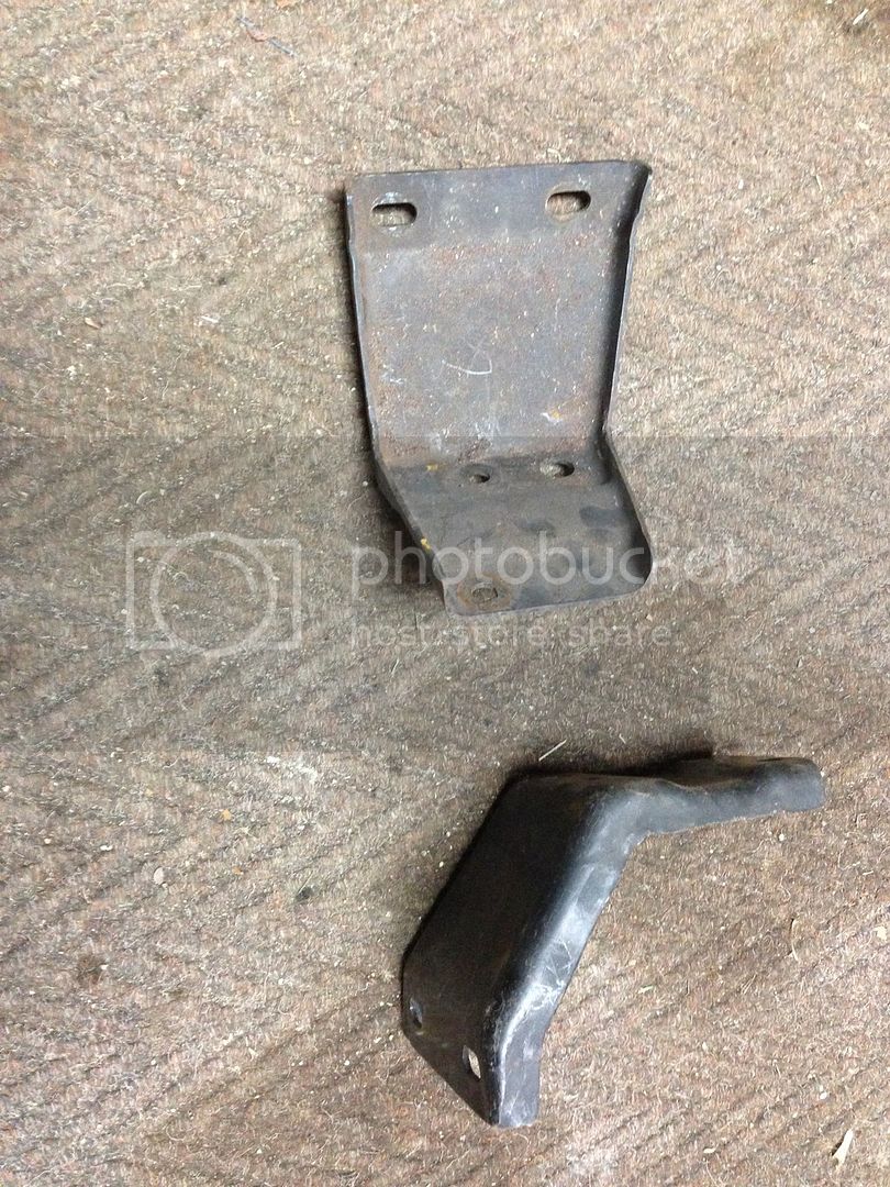

i did some test fitting today and it looks excellent bottom off the tank sits about 1" below ARB bumper you can even se it i did find bracket in my scrap metal what will work perfect for tank mount there is gap off 2" between tank and the mount so i will add spacer ...

and yes there is skid plate ,tank i m using is bolted to tank mount and the skid plate can be bolted to tank or tank mount and size of this tank is excellent fit before i did it i tok some measurements of toyota opening and i was on junkyard for two hours measuring tanks to find this one to be best
and best part , to mount it on is so simple
