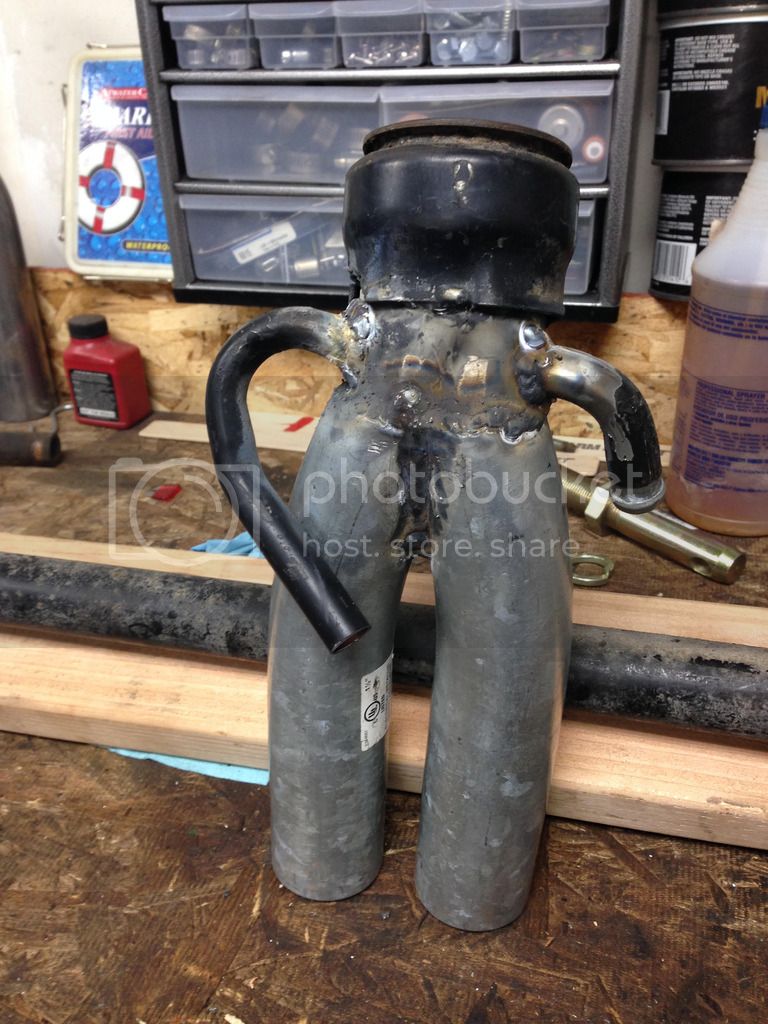

Filling should not be problem using goranvolvo fabbed neck. It vents the same as the factory style neck. I see separate vents at the fill point of the neck as an impotant safety feature. If you try to over fill either tank by transfer or filling the fuel will just circulate back through the vent. BTDT
main tank and aux tank vent on top of filler neck .

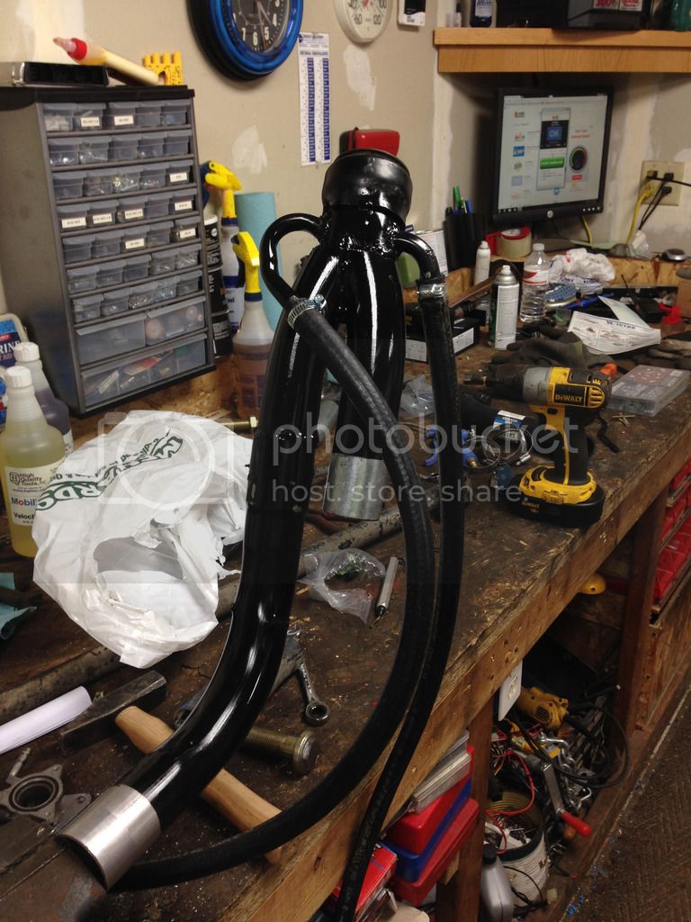

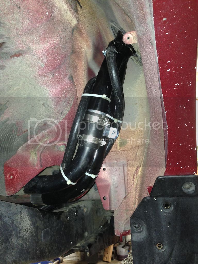

i reversed the vent hoses so main tank hose is on the rear side and aux is on the front so like you said if on tank gets overfile the fuel will go to other tanh they vent hose
all is left is to bolt the aux tank and do wiring

Nice... paint make all the difference looks great and should work the same.
