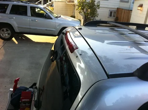

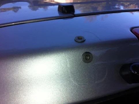

Can you post some good up-close pics of the openings and also one showing the gap between the exterior sheet metal and the actual threaded hole the must be sealed? Also, what is the exact diameter of the opening?

Here is mine, off while cleaning.
good call on the well nuts, will try that solution, thanks for the suggestion...rob red, thx for posting pics for me (i was actually away for a few days, so this was a big help!

Actually, the pictures show rivnuts in place. If this is the case, no need for the well nuts i mentioned. Simply put new hardware in the rivnuts and seal the threads with thread sealant and/or a rubber washer.

That's correct.
