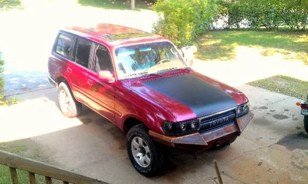

Bumper
SuperStan that is an awesome bumper! If that's the one you homemade you need to post some more detailed pics!
Thanks for the info guys, guess I'll be buying some Al's or Raptor liner
Thanks for the compliment! It is indeed my homemade bumper. I've several detailed pics and full intentions of making a thread about it when I finally get it painted so that people can see the finished product. I may even make some kits, or copies for sale if as many are interested in the forum as on the street. However, there is a moderate amount of modification necessary for direct bolt on of this particular bumper.
