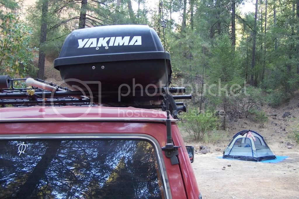

Here are a few with the hatch mount - each with different antenna.
-m
edit:
By the way, the one showing the side mounted antenna is a really bad idea for tight spaces. Tree branches will rip it off. So will other cars when they are trying to parallel park behind to you. I had a guy catch it with his mirror and rip it off. That is why I have the lip mount set up for use in trail situations.
