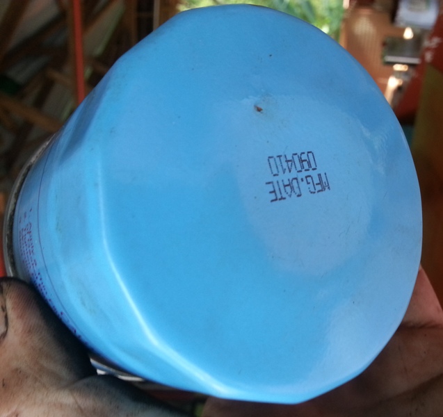

Last weeekend I busted some ribs during the TV shooting so in too much pain to look at at it. So yesterday decided to have a look pumped the priming pump and slowly a trickle of diesel appeared eventually we traced it to the fuel filter took it off and their is a PINHOLE in it.
You can see the pin hole in the pin (that little dirty dot) on the top half of the filter. Anyone ever seen this before or know the cause? A new filter being installed today and I will catch the train up next friday night and bring it back.

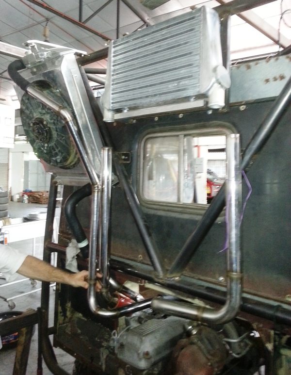

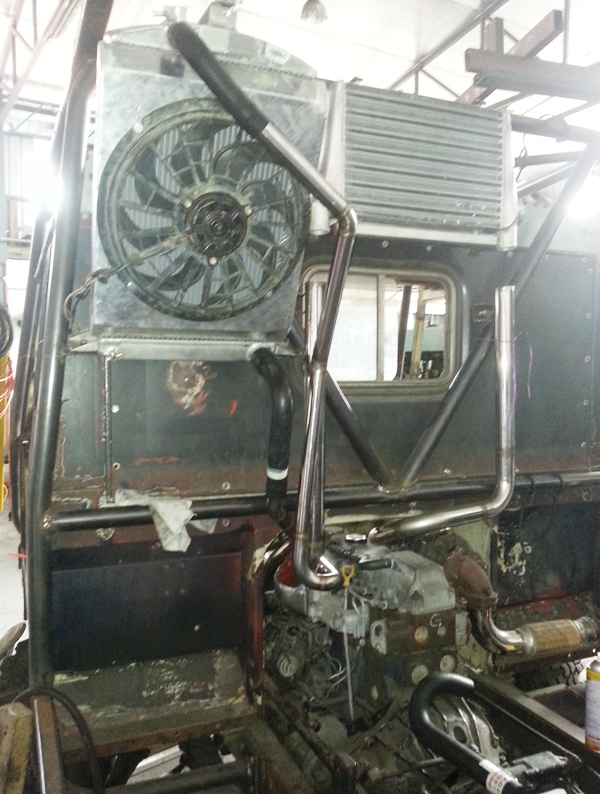

This is the Volvo as at the latest pic on Saturday when I had a quick visit on my way to mothersday dinner. Radiator installed and fan running next is intercooler fan.
Not long before the thump of a 14B-T is heard.
The only thing I could think of is that something has richochetted off the fan blade and hit the filter.
Could have corroded from the inside out if thats the lower point... Water trapped down there..
The water would have been the first thing to get squirted out... Cut it open to see....
Yes it is the lowest point we will open it later first to get it running before the weekend
