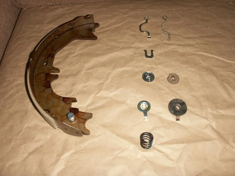

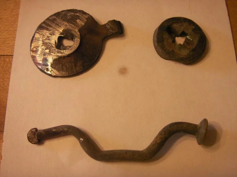

so that horrible screeching noise as we approached daniel...........................
disentegrated E-brake shoe retainer, heres whats left
It supposedly is according to my build date of 2/95. The new pin was much shorter as that one has been stretched over time likely leading to its failure. A new pin/spring combo and new shoe and the E brake works better than ever before. The replacement for the larger of the two retainer cups was much smaller in diameter but worked non the less.
