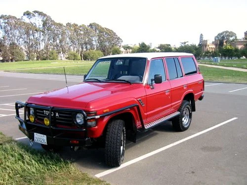

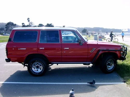

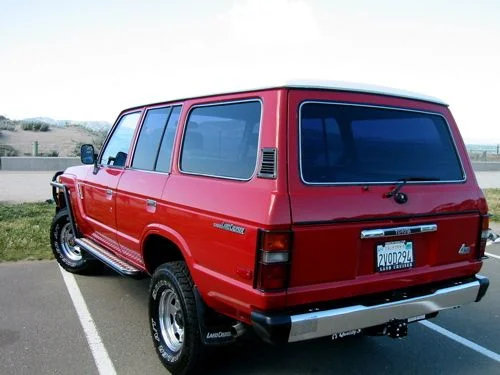

I painted mine, summer 2006. My truck is now a tri-tone.

That looks sweet. Paint, or white liner of some type? What happened to the old rack, was that factory?
The only reason I would not use Rhino liner on my roof would be for future rust issues. It would hide it, then when it is too late BLAM.... Your roof caves in LOL....
Also I would be concerned with removing it after if I did have repairs to do. But the way ROM did it you would be out of the main rust areas(ie the fn gutter)

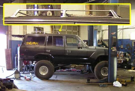

I used Krylon spray paint - gloss white, removed the CND factory rack and rubber mold roof strips (re-adhered after paint was dry), roughed up the surface with 3M pads, masked off the selected area to be painted and went to town.
I wasn't concerned with painting right to the edge as long as I had a clean frame masked off, the heat reflection would still be effective.
The rack in the aerial photo was a loner from a friend's truck for the road trip.
CND factory rack
