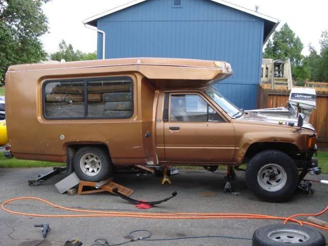

Everyone likes a picture so here is one before I swapped out the rear axle with 31's on the front. It is now SOA in the rear with a 90-ish rear axle 4cyl rear end (2 bearing carrier) and 235/75/15 = 29's.
