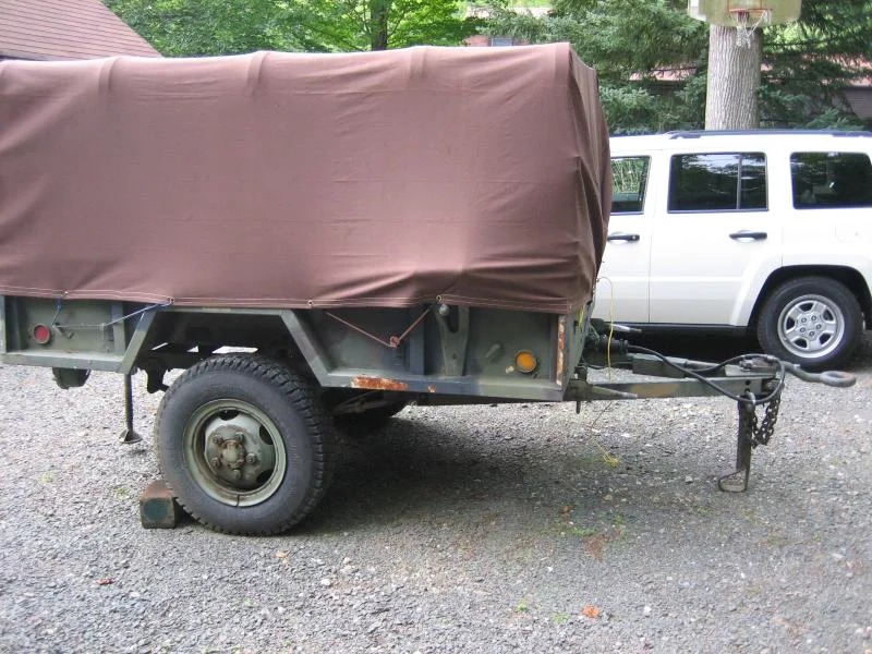

M101 3/4 ton to a stock 100 you've got a serious height differential:
I used this pintle hook mount with the pintle in the set of holes one down from the top: 12" high receiver adapter With the lunette on the trailer rotated down it will sit level with the 100 (the pics shows the lunette rotated up and down).
For your pick up:
Beg or borrow the tallest pintle hook adapter you can find. You will be dragging the landing leg on the ground with a straight pintle mount and the lunette in the stock high position. (see pic again).
The safety chains are too huge to hook into the receiver of the 100. If that bothers you, bring a hunk of chain and some clevis hooks.
Lights - an inexpensive complete two light trailer light kit is all you need. The studs on the lights are standard spacing they will bolt right in place of the military light. 5/16 or 1/2 wrench to take off the military lights.
Any help and / or tolerance of you wrenching is completely up to the local personnel. If you go to the steel soldier forum there is a section dealing with this.
Hope for the best on the tires and bearings. ;):wrench:
