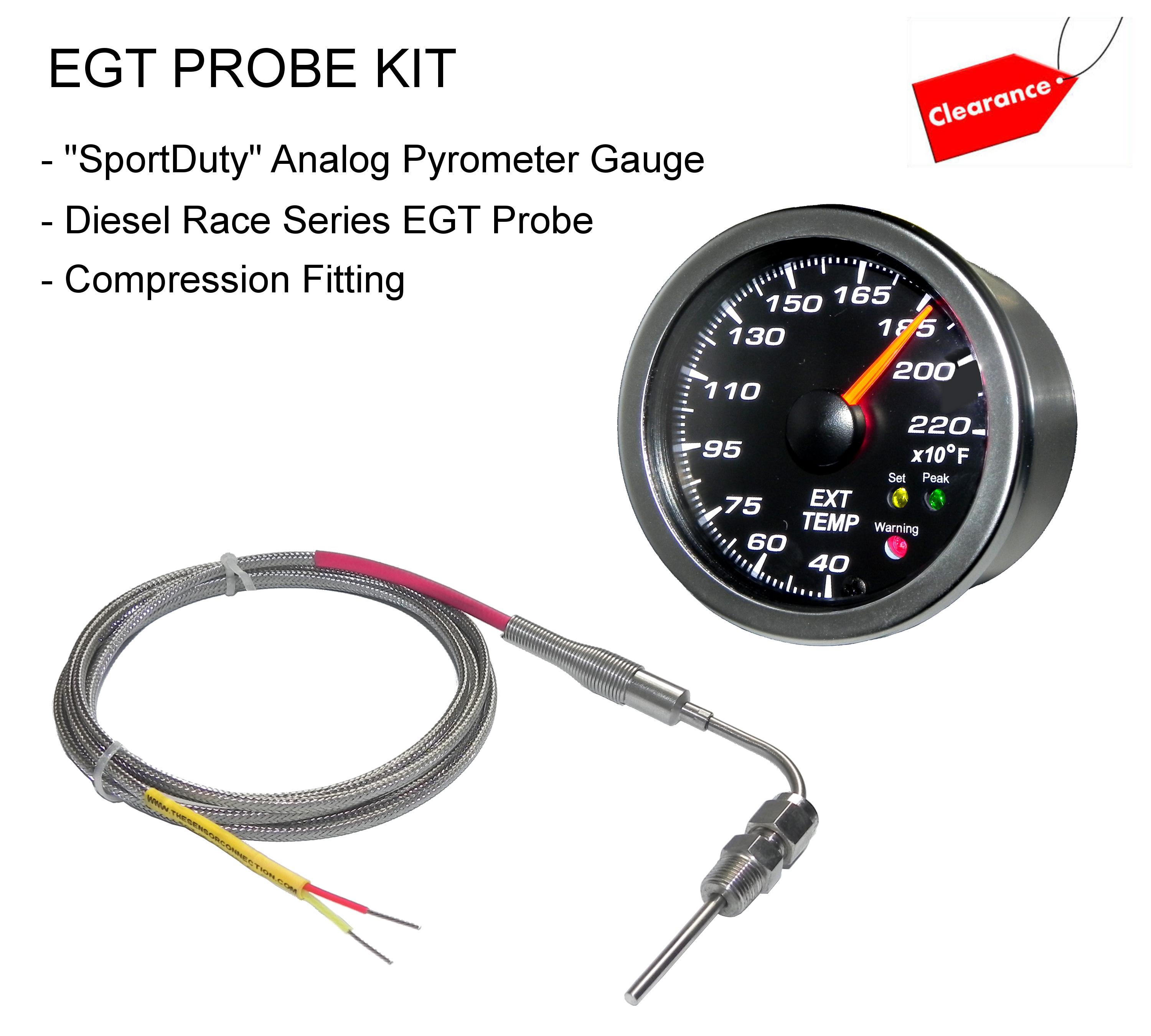

EGT / Pyrometer measures your exhaust temps. which in a nutshell measures how hard your engine is working.

Probably not (also I'm not sure what that is...
In addition to what Charles said, the pyrometer has a probe that measure the temp of the exhaust. There is a good spot on the 1HZ exhaust manifold to have the hole drilled. They don't fit them to smaller diesels but the big Kenworths, Macks etc all have them and the drivers must watch the gauge and change gears to keep them at the safe temp.
Higher RPM through lower gears is better because you have more air flowing through the combustion chamber. Ive never bothered with one because I drive gently on the worlds flattest continent, but if I was travelling through mountainous territory I would.
The 1HZ pistons are quite soft on top, it acts as sound deadener. But you need to look after them.
Its hard to see in the pic but there is a red needle behind the orange needle that you set to the maximum allowable temp.
