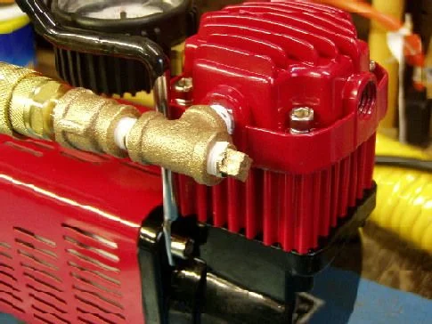

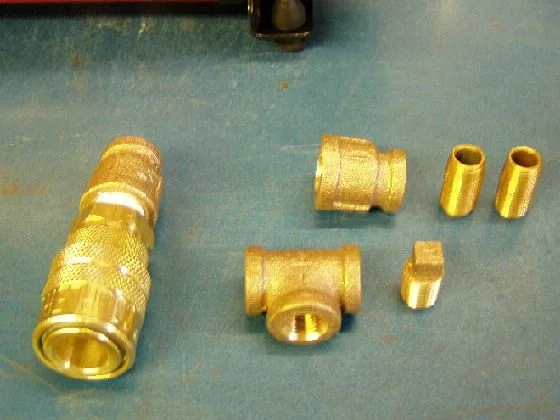

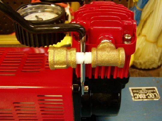

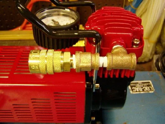

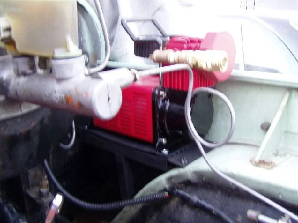

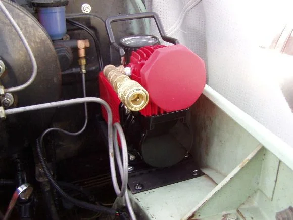

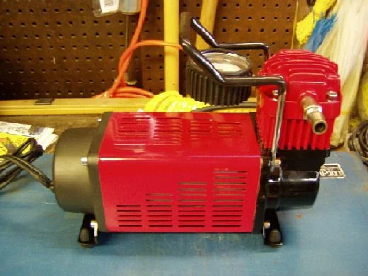

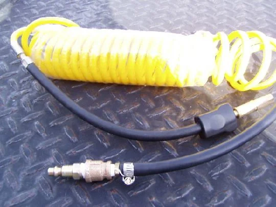

With all the talk about the Pep Boys MF1050 compressor on the outfitting board I thought I would give it a try. Pic one is the way the 1050 comes, it has a funkey hose adapter, so I wanted to change it to a quick disconect fitting and later I plan to add a tank to the system. Pic 2 shows the peices I used. 1 quick disconect end, 2 1/8inx1/2in pipe peices 1 1/8in t fitting and 1/8 to 1/4 adapter and 1 1/4in pip peice. The next few pics show how they go together.
pic 1,2 &3

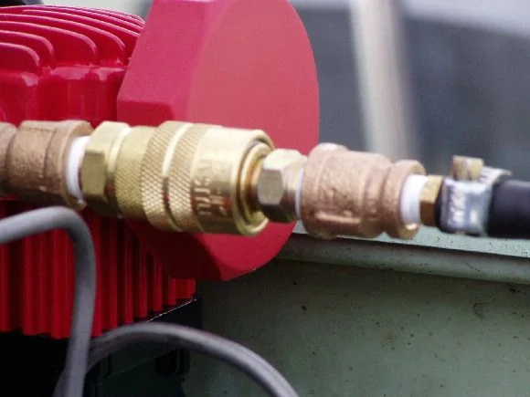

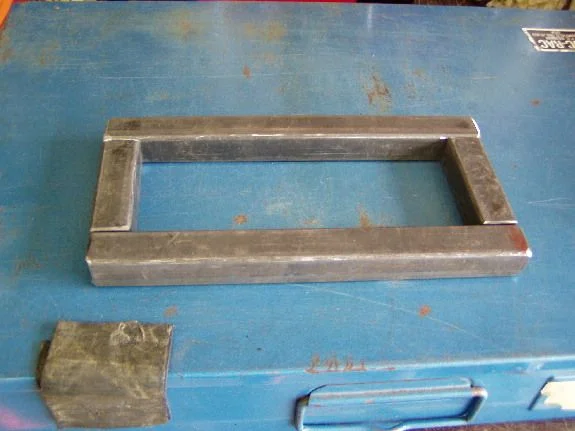

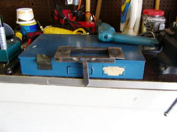

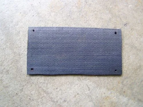

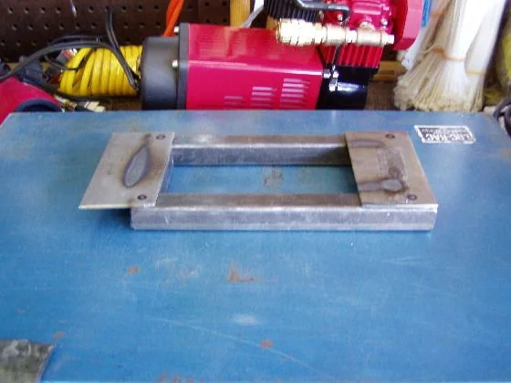

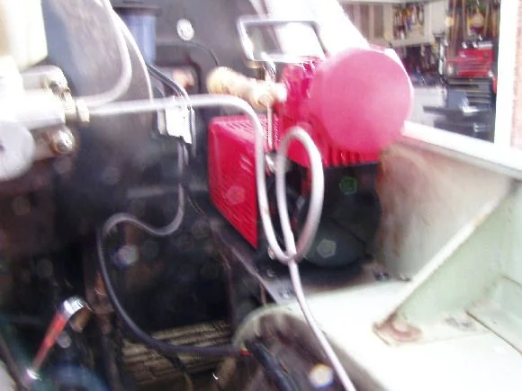

Pic 10, 11 & 12 I added a leg to the bracket I made for stability and then mounted it to the fender with a rubber pad between the compressor and the bracket. After fitting everything under the hood one last tim I took it all out painted the bracket and hard wired the compressor.

I have the same compressor. Good idea to set it up for standard air fittings. Are you going to make some sort of cover for it, so that it doesn't get too wet in a downpour? It looks pretty well protected, but rain can get anywhere.
Steve

I like where you mounted yours in the Cruiser :cool:

I just did the same thing with my QuickAir.
I looked for the 1/8 to 1/4 "increaser" fitting everwhere... no luck. I did the same thing but know the hard cover I had for the thing wont fit. :o
Looks good! Good writeup
