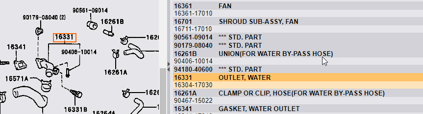

Needing some help finding a pn for a water inlet for s 1HZ/HDT with the extra outlets on it . Looked at the diagrams on Partsouq using different vins but had no succes.
I have one last one here of a batch I ordered several years ago but can’t find the pn to order a few more.
I may think you point out the water Outlet (not the one with the thermostat)
Try this : 16304-17030
Otherwise, check for :
16304-17010
16304-17020
