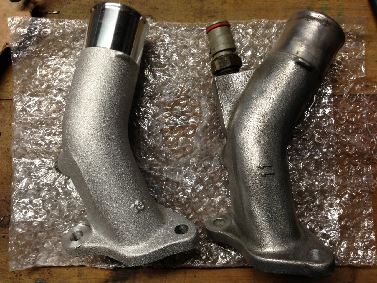

Does anybody have the part number for the water outlet that goes from the head to the upper rad hose? Its the one that has the temp sensor port built in? On the right in this pic. Its said to be from Australian spec 80's that came with a factory temp gauge
Looks like I found my answer
The Left is 16304-17010 (no temp port)
The Right 16304-17020 (with temp port)

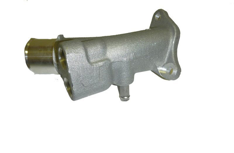

Plus I found this odd beast
Pic Below is 16304-17030

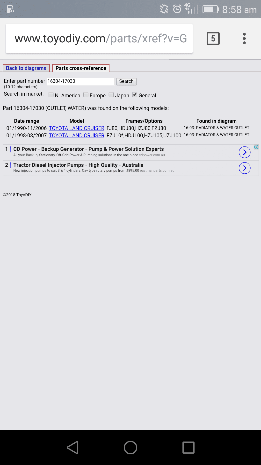

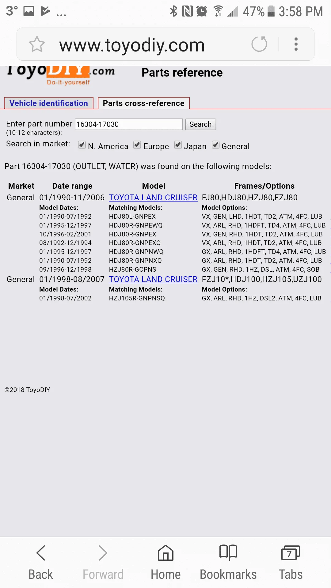

A search of the past number for the double port outlet on toyodiy does it was used on my vehicle, but I'm sure mine has a single port.
Edit: toyodiy search of my VIN shows a different part number. must vary depending on different factory options/accessories maybe?

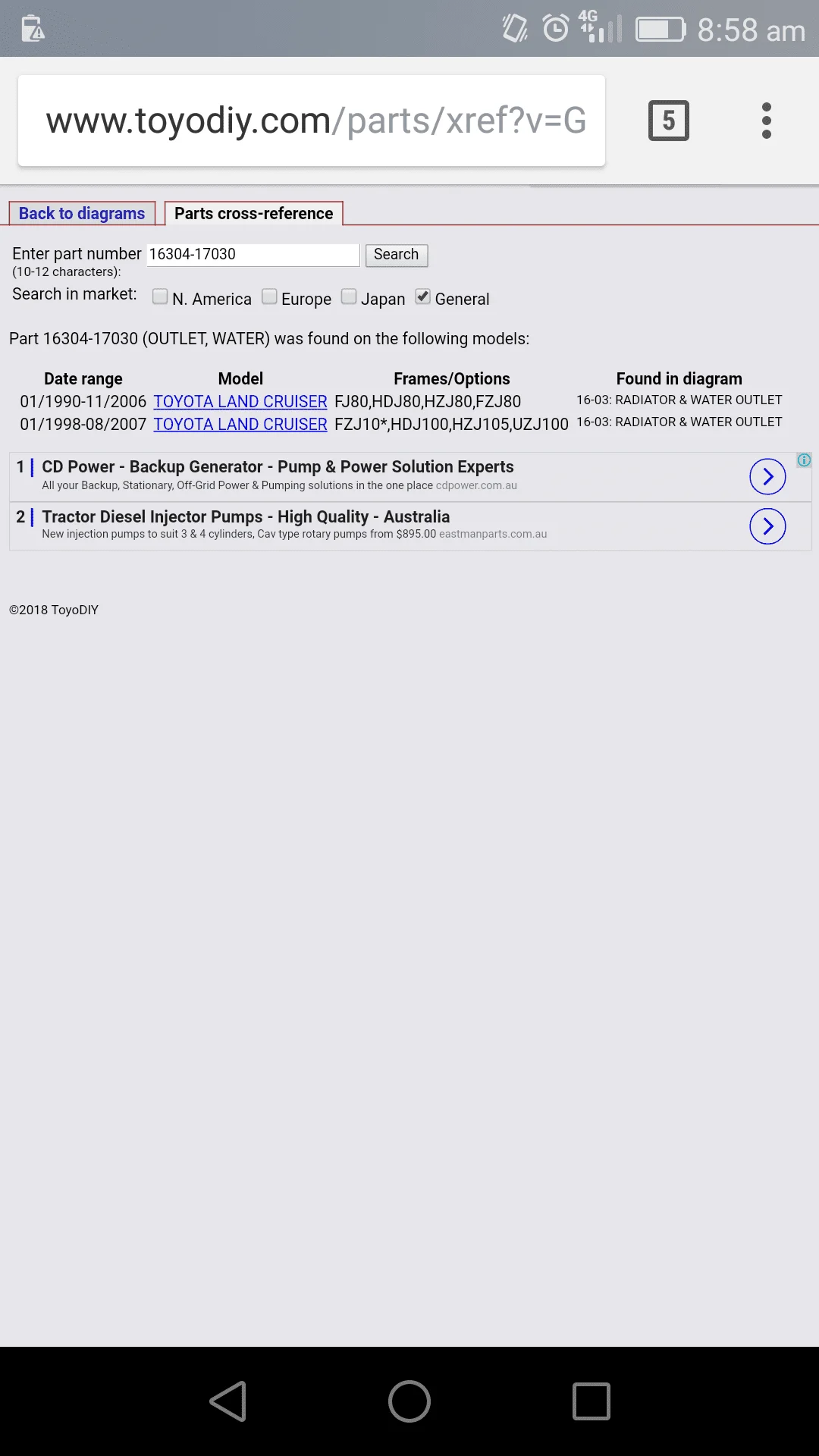

Interesting.

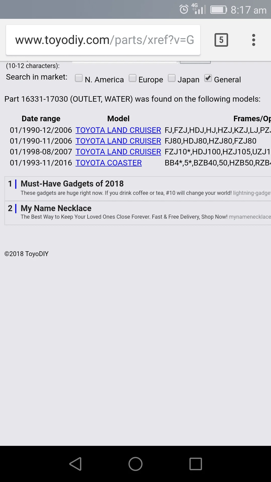

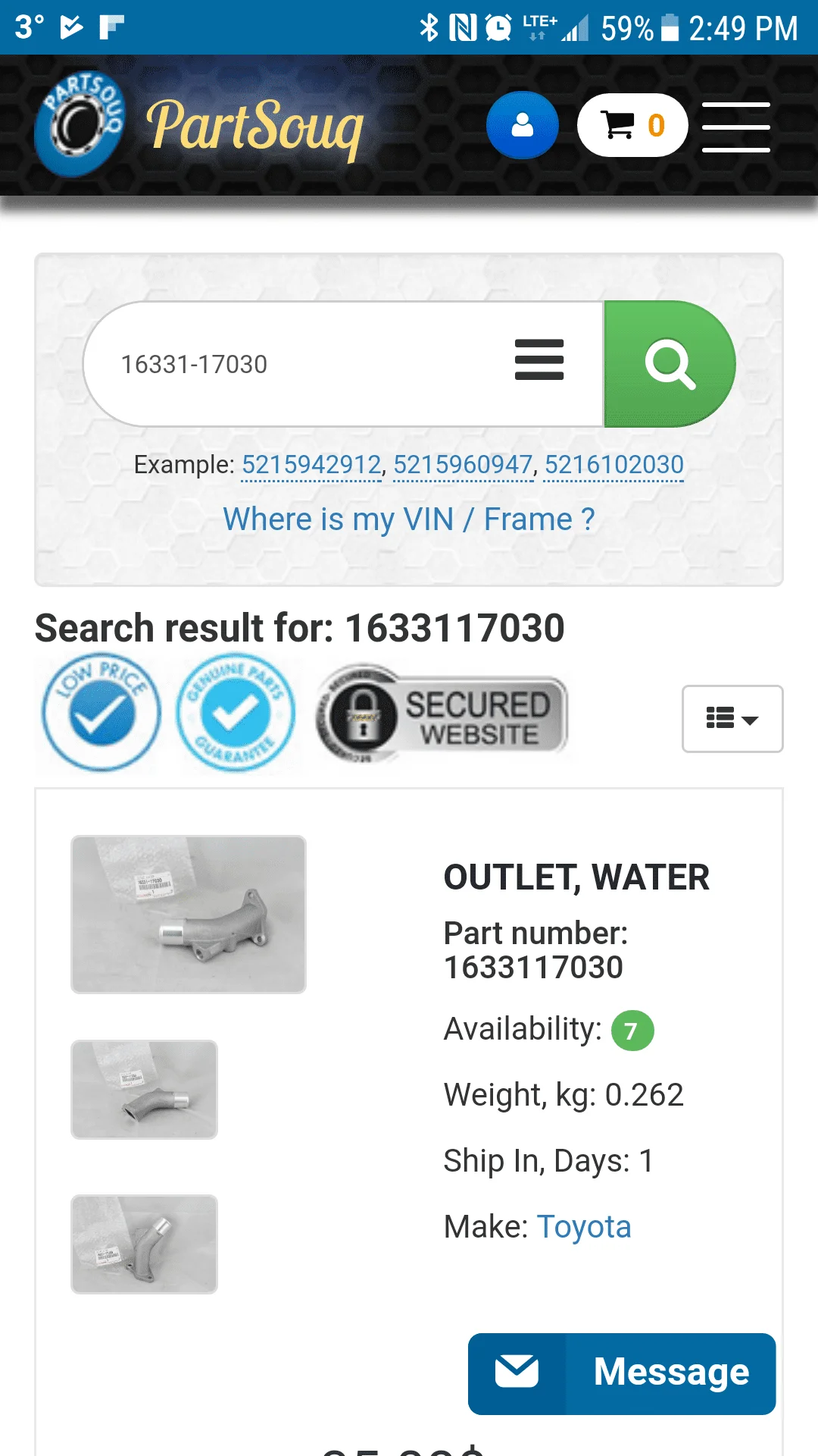

The number your showing is difremt again and only a single port and doesn't have the hose barb for the turbo cooling lline
Has anyone worked out what the double port is for?
Oops, sorry. Screen-shotted the wrong part

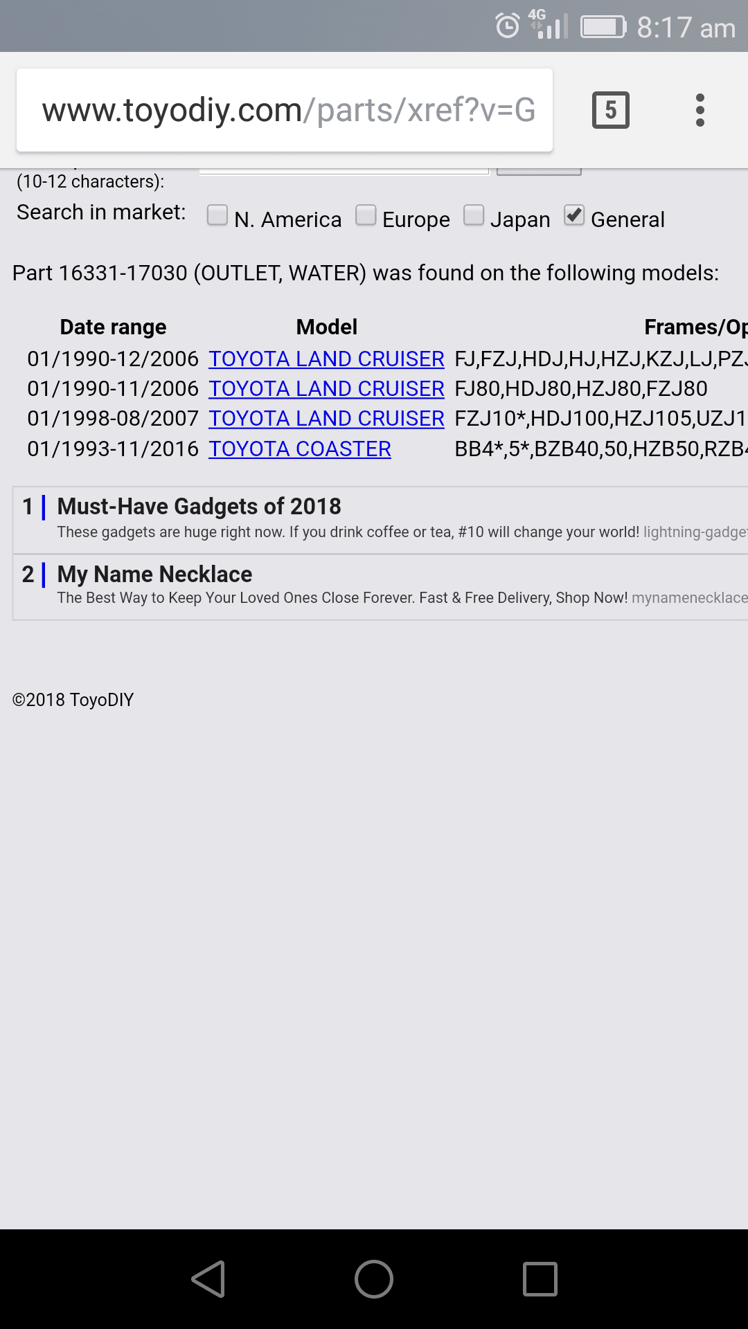

Interesting. If you take that search a step farther you will see the dual port part number 16304-17030 comes up in 4 Australian market (ARL) HDJ80's, 1 Australian HZJ80 and both a RHD & LHD HDJ80 in "General countries" (GEN).

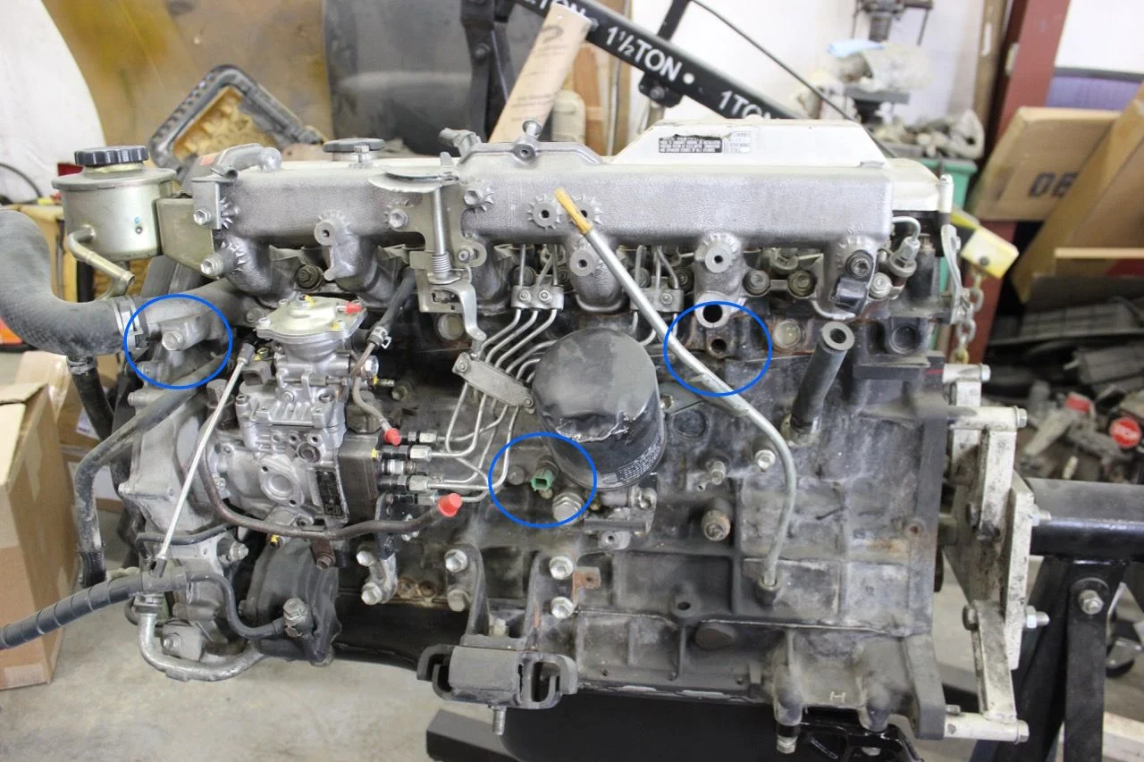

I found this pic of a 1HZ in another thread:
1hz temperature sensor location
From what I read over there the temp sensor in the single port outlet in this pic is for the aircon, the one below oil filter for the glow system and the one behind the dipstick is for the temp gauge. So there may still be another use for the dual port outlet??
in my case one was for the dash temp indicator and I " assume " the other one was for the glow system ..
