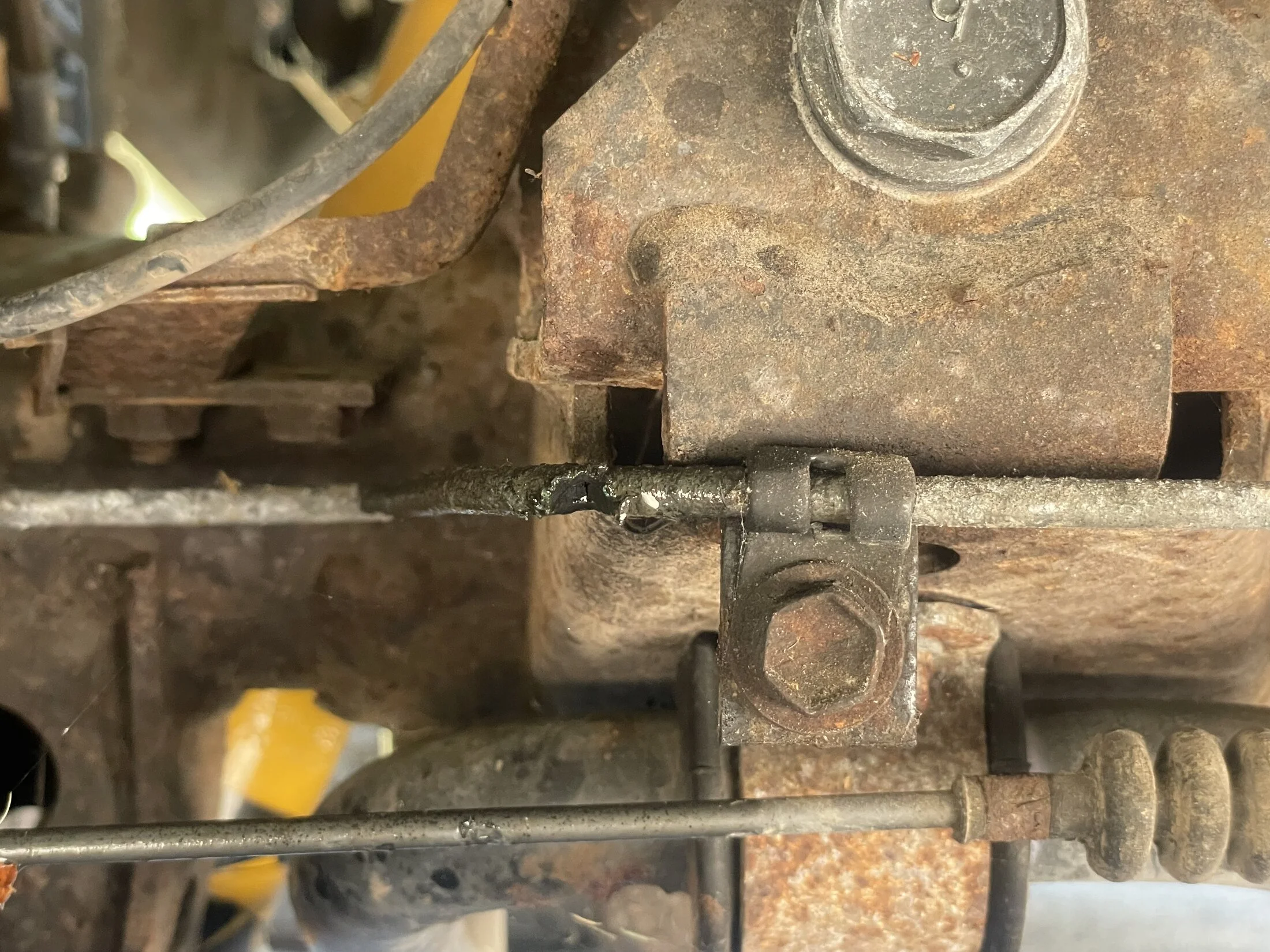

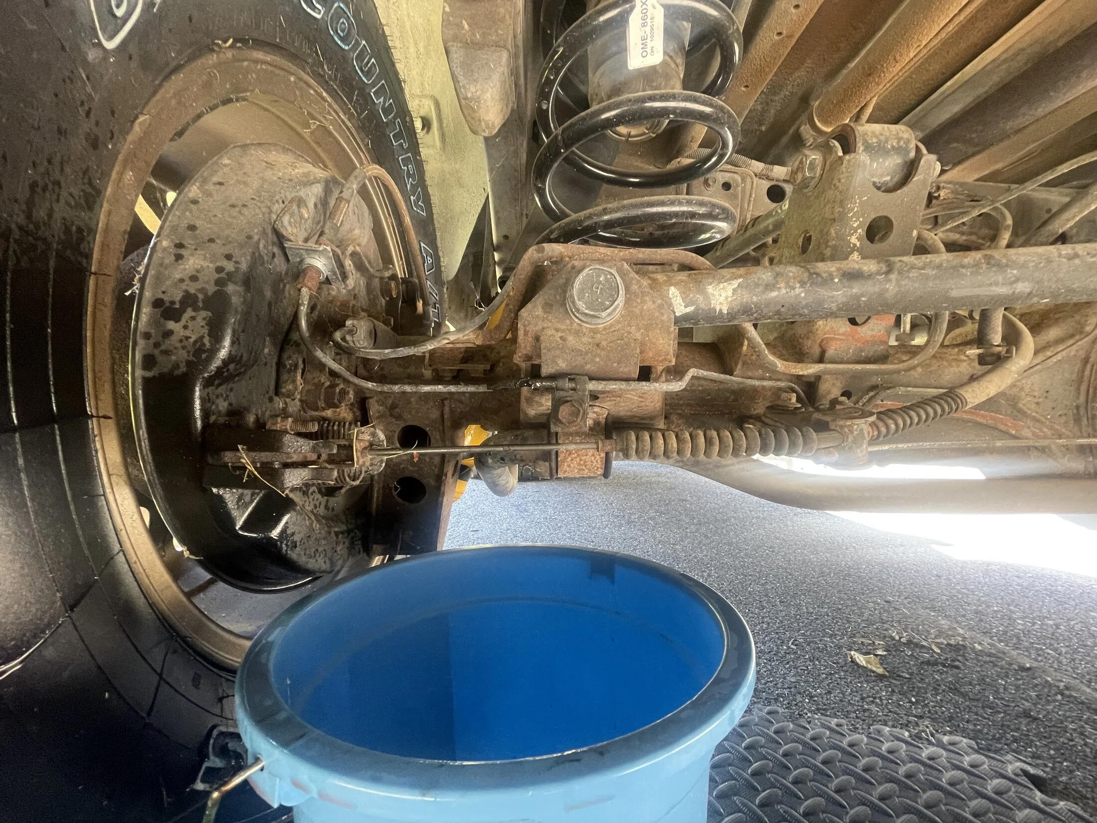

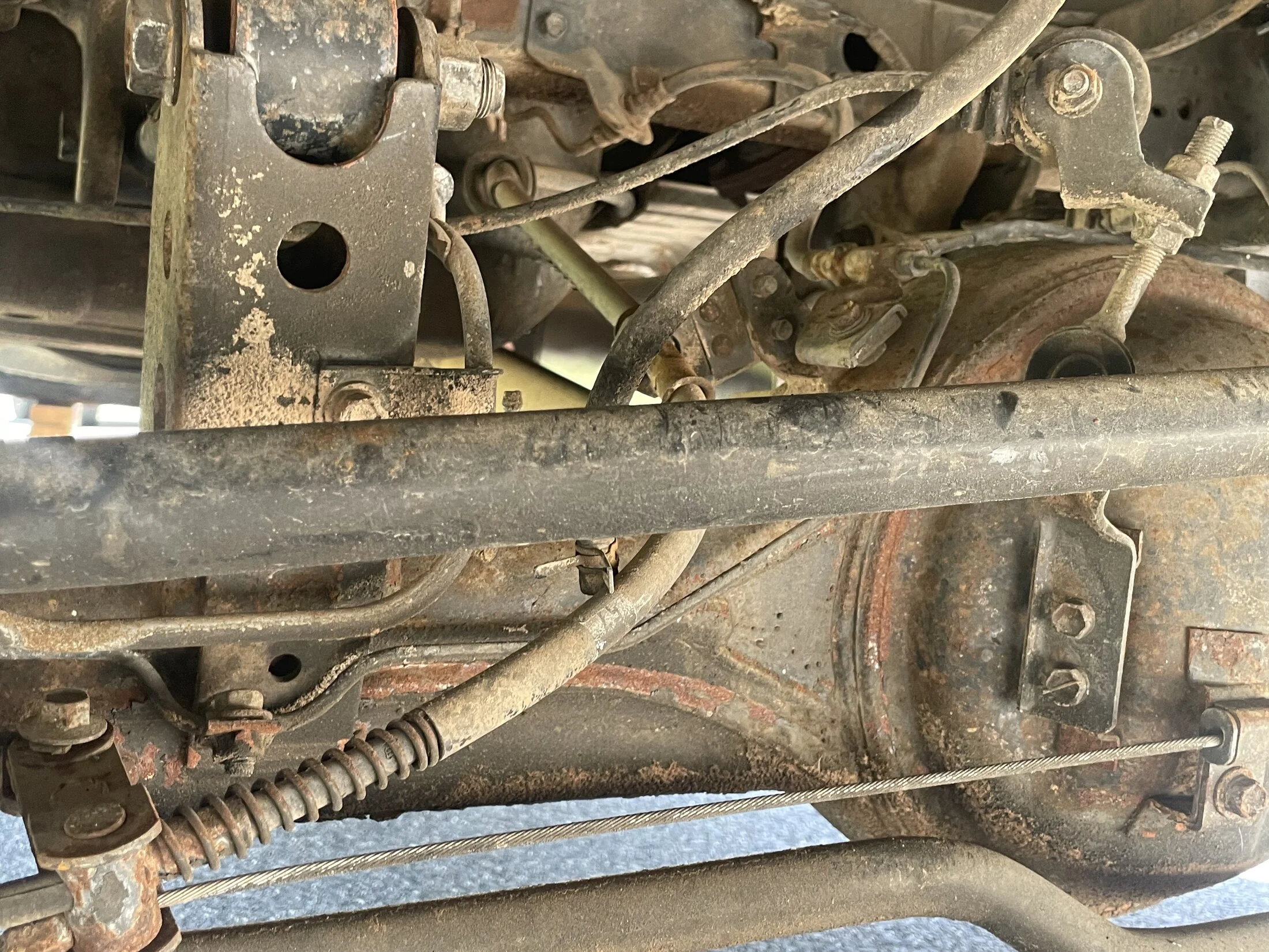

I noticed a crack on my hardline (rear left side) and need to replace it. Does anyone know what the part number is?

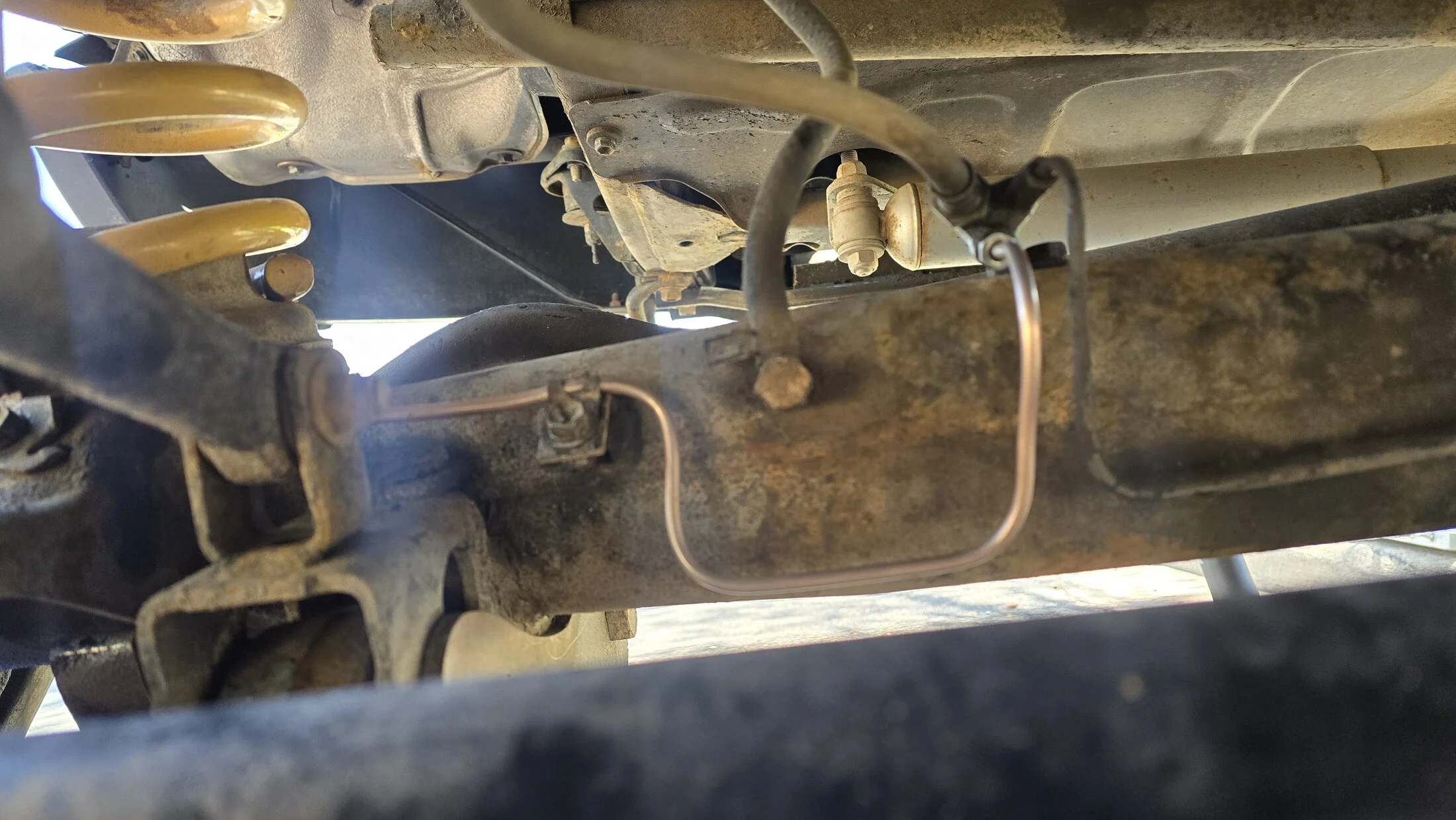

I made my own hard line for the front line on my 81. It wasn't bad at all. Bent it all by hand, but you can get a bender.

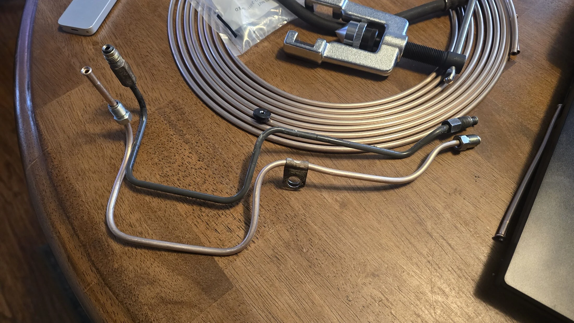

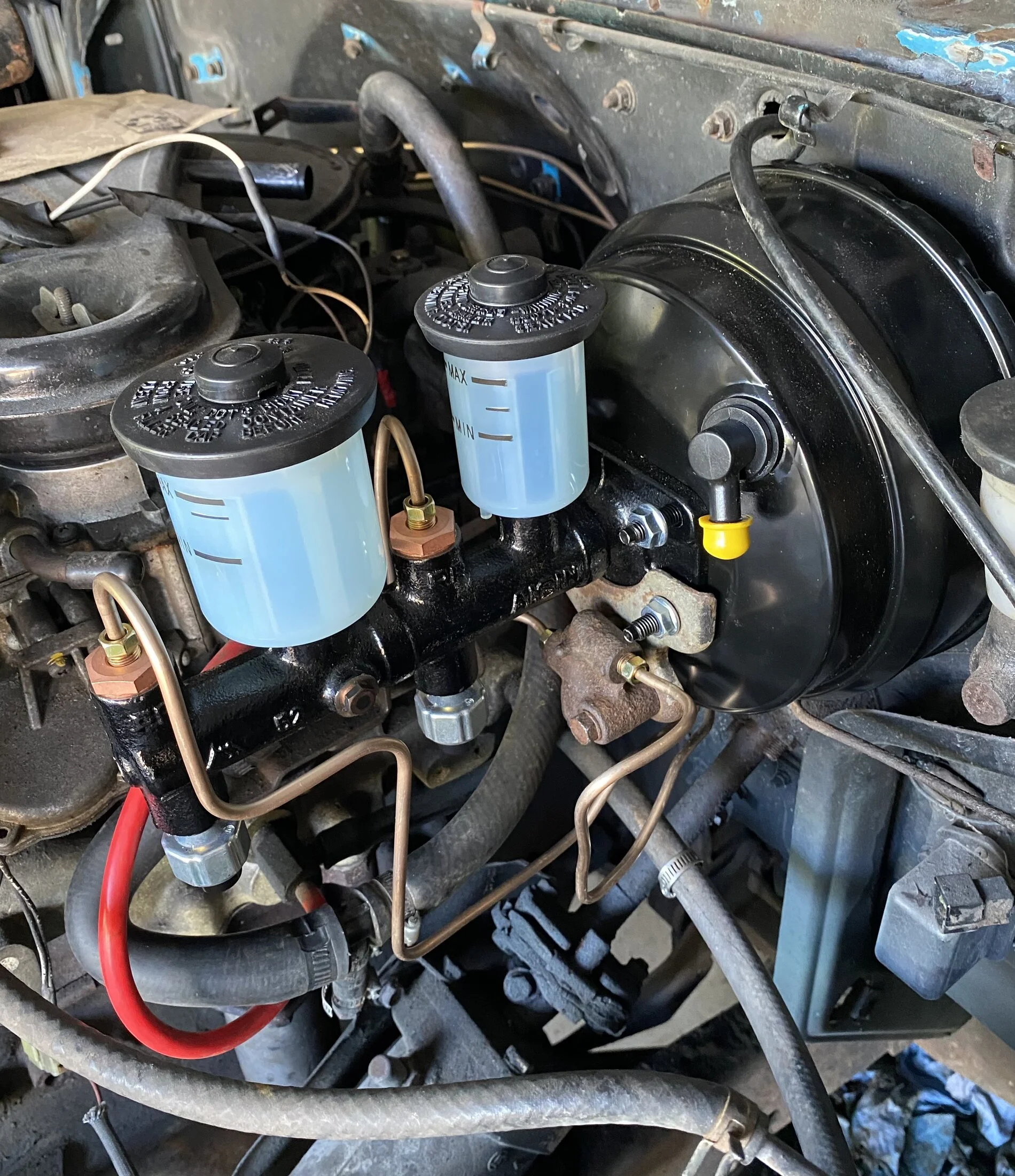

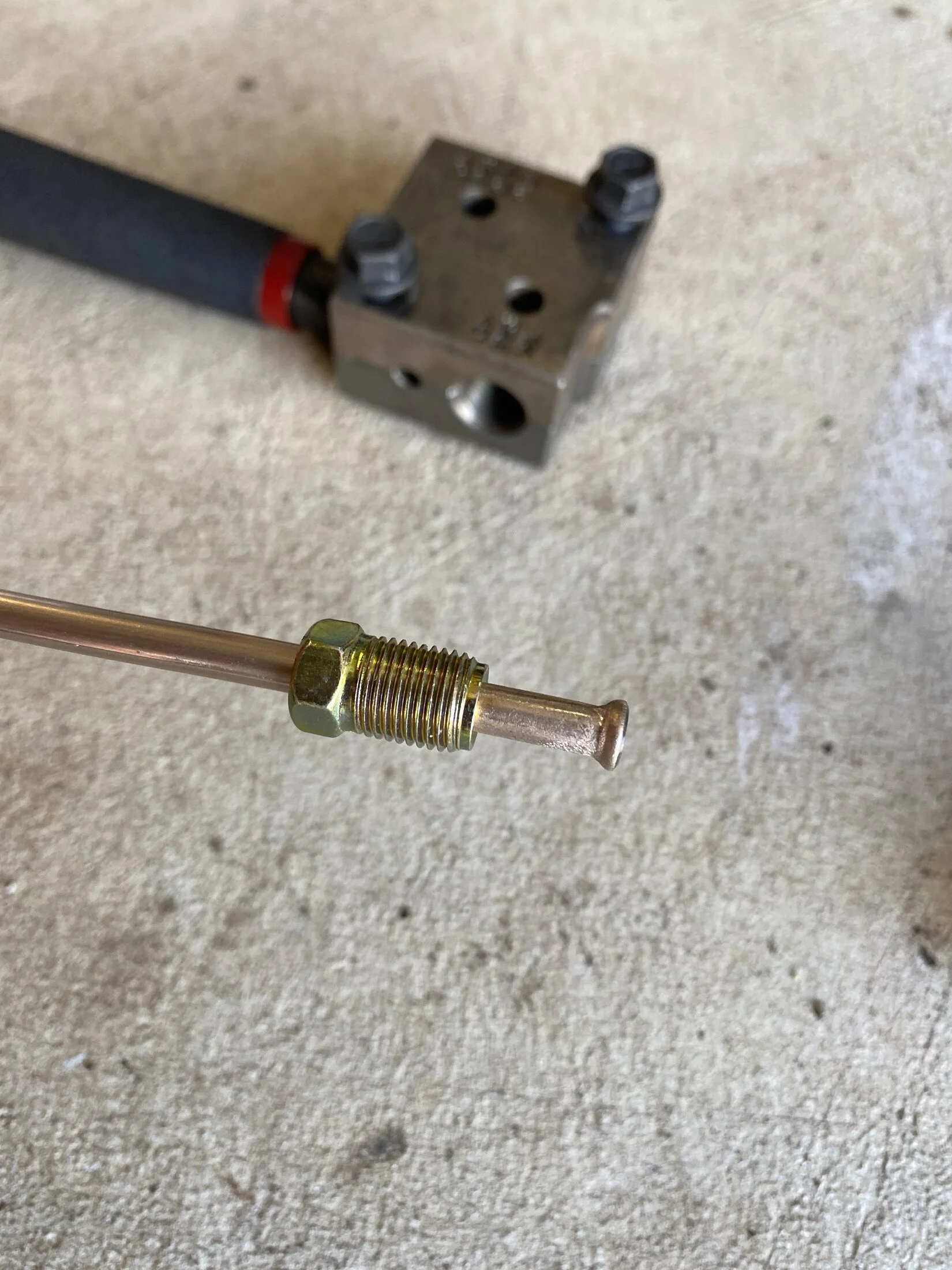

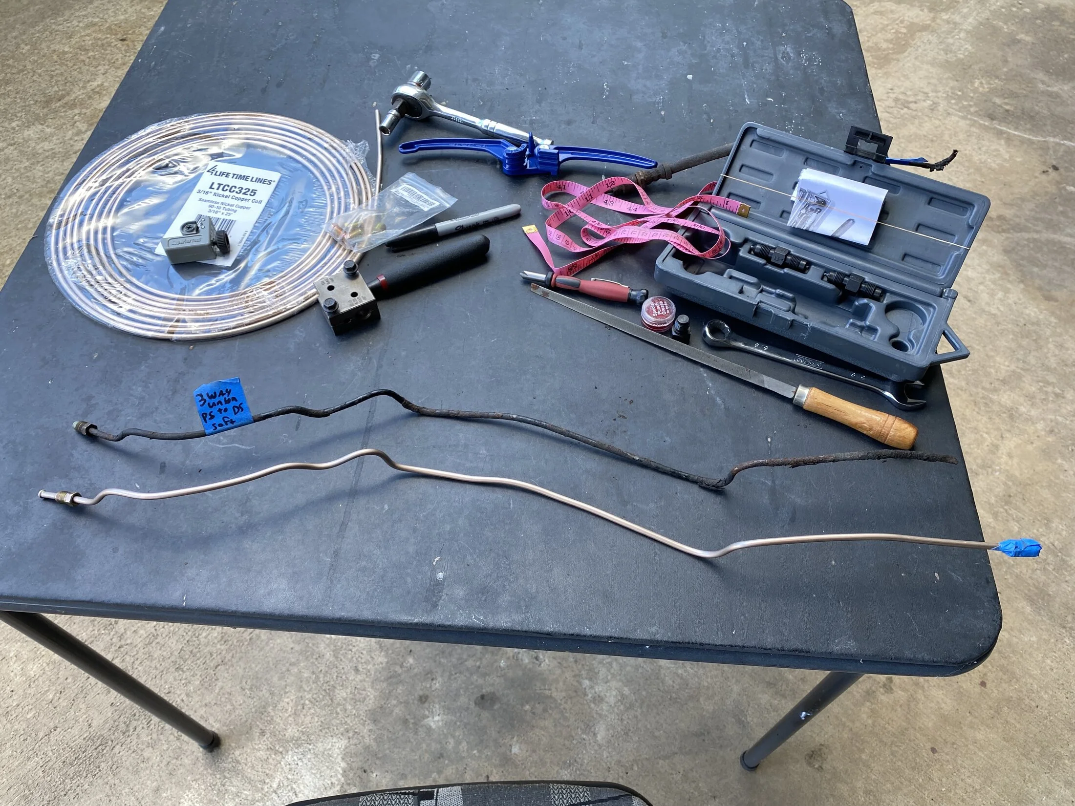

Just kidding, but it is easy and relatively inexpensive to do yourself. I helped bend up and install all new hard lines in our ‘75 fj40. You can get good NiCop line, flaring tool and bender for tight angles off Amazon delivered to your door in a couple days. Here’s what I used, most of the items came recommended off of this forum.
I was pretty proud of my work, as I had never bent up brake lines before, but most of it is pretty self explanatory after one YouTube tutorial. I also know that they sell straight flared lines with the nuts at Napa at certain lengths, so you just measure and bend to match the line you take off. Good luck!
