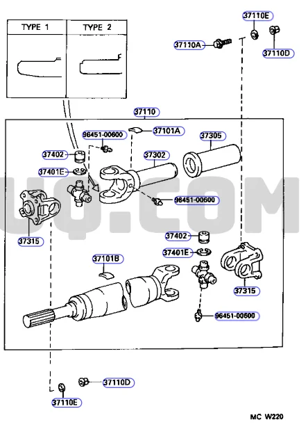

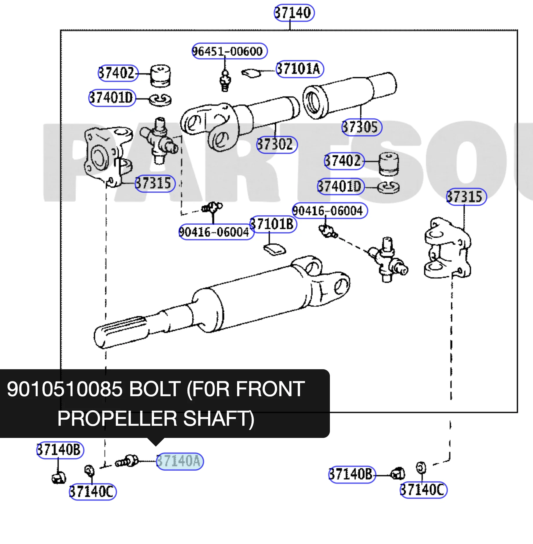

I will be replacing the u-joints in both prop shafts soon, so I figured the hardware could use a refresh too.
I have the u-joint part numbers sorted out as well as the front prop shaft hardware, but the rear hardware is the question mark. I understand that the thread sizes on the front are 10mm and the rear is 11mm.

90105-10085 (Bolt x4) ????
90560 -10H00 (Washer set x2) (Same as the front????)
90179 - 10059 (Nut x8) ????
I am using partsoq to help me figure this out, but either the labeling or the part# seems wrong; for example, the bolt for the rear prop shaft is labeled for the front, hence my confusion. Just want to make sure I've got it right. Thanks!

That is the front prop shaft.
90105-11H00 for 11mm bolt, nut, and washer in a single pack.
Double up on the single pack, or get the nuts and washers separately for the front of the rear prop shaft.
4 x 9020111013
4 x 9017911005
This is the rear:
Great info! Last time I was doing this, I got frustrated trying to figure it out so I just called Cruiser Outfitters and they sent me what I needed.
