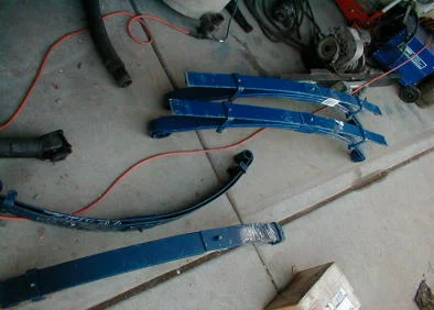

got home at 7:30 to find my parabolics here. excitement went south when i found one ubolt and all the bushings were wrong (all the bushings are the same, but the pins on the front springs aren't as big as the rear, and they measure 3 1/2" shoulder to shoulder which is about 1/2" too wide). i did some grinder work on one front and shoved it in just to see. bolt heads on center pins are too large also, so i'll have to open up the ubolt plate. i'll do that when i get the correct bushings. can't wait to get it running and check them out.

i ddin't grind the spring...i ground the shoulder on the bushing. i'd rather screw up a $2 bushing than a $200 spring. ;)

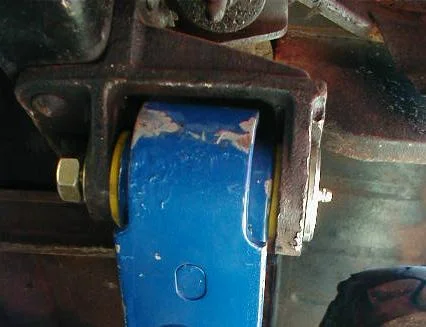

ok, the last spring is "on". couldn't find the correct bushings for the front yet, so i'll just order them from a$phincter. the local 4wpw drone was useless in assisting me the the 20 or so other shops in the denver metro area apparently are either closed on holiday weekends or closed on weekends altogether.
front bushing should be a 15mm i.d., 1 3/8" o.d. with a .125 shoulder. the rear bushings are fine i.d and o.d, but the shoulder is completely wrong and i don't see anything with a small enough shoulder (it has to be wafer thin to fit, or grind the spring). if i was planning on wheeling the rig or daily driving, i would pull the rears back out and grind the spring so i could run a somewhat normal shouldered bushing.
also, the front springs have some horridly huge ass center pin/nut combo, so plan on a lot of dremel work on your spring plate to get it to fit over the center pin.
the ubolt issue is squared away. one kit comes with five ubolts...the fifth one was the square one...apparently to fit other applications. also, they ubolts are specific to front or rear (or at least they were in my application), so check the length first (i didn't).
finally, plan on a lot of time with the flame to get the 40 year old bushings and pins out...made for some cool pics though.

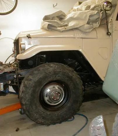

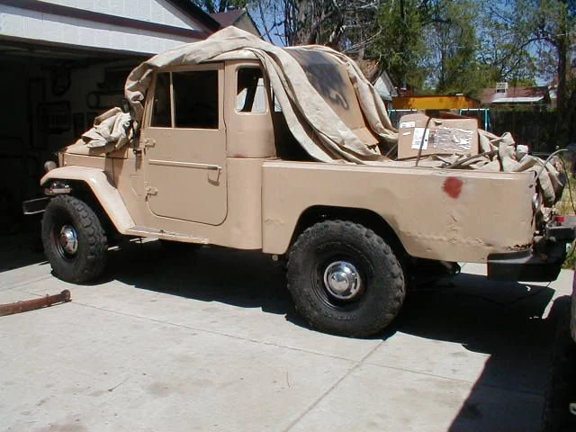

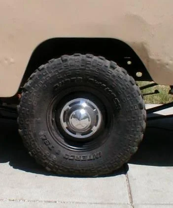

lift is minimal, but i do see it as long as the springs don't settle, it will be about what was stated (50mm iirc). hopefully they'll ride good...well, off to clean up the mess i made grinding down bushings to make them fit.
here's before and after of rear wheel wells.
