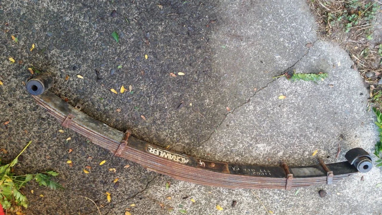

I have my 40 in a 1000 bits and now starting the rebuild. I want to tidy up the spings by removing the rusty look and coating them with a durable paint. One of the spring refurbish companies I spoke to said they use a basic water based paint to coat the springs which I guess would last 5 minutes.
Has anyone else refurbished their springs and what did they use for the coating?
