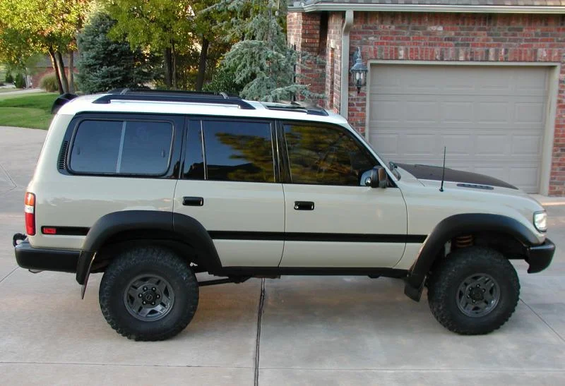

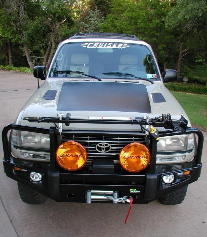

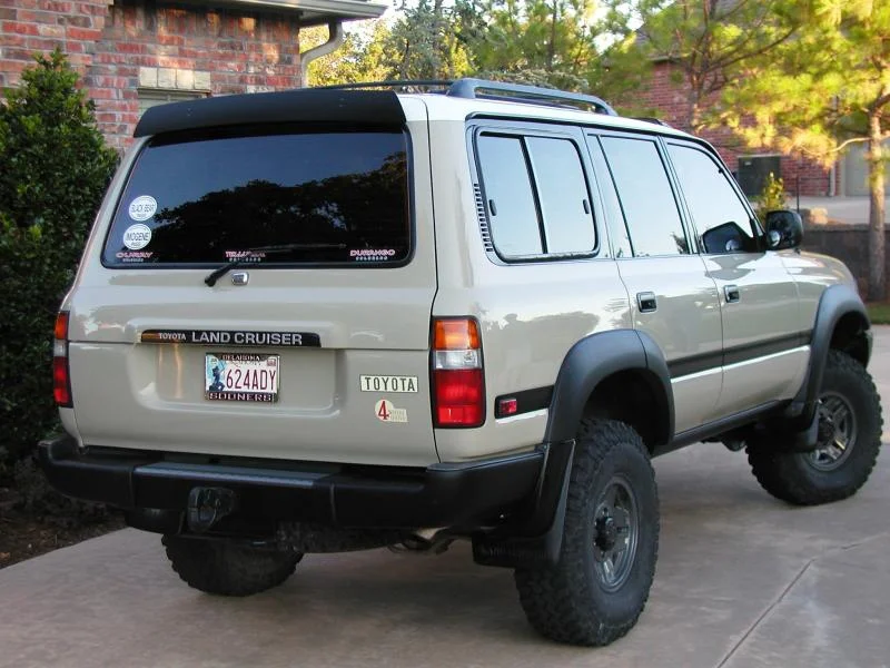

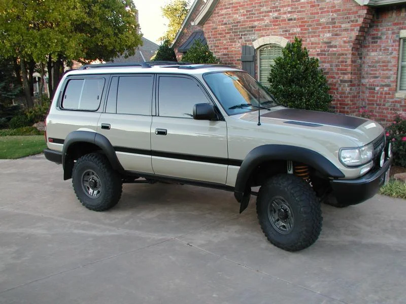

I recently ran into this other thread over in the 80 section with one of the guys from Summit Cruisers... and aside from the fact that his rig looks too clean, this is exactly the look I'm going for. Not sure about the hood, but I already have the retro badge for the tailgate! So this is as close to my "new" vision as I've ever seen.

As for the line - I like the way this truck was painted. I think I'm going to try and mimic that same paint job, just with liner instead of real paint. But yeah, I'll be doing the whole truck once I get around to this job.
