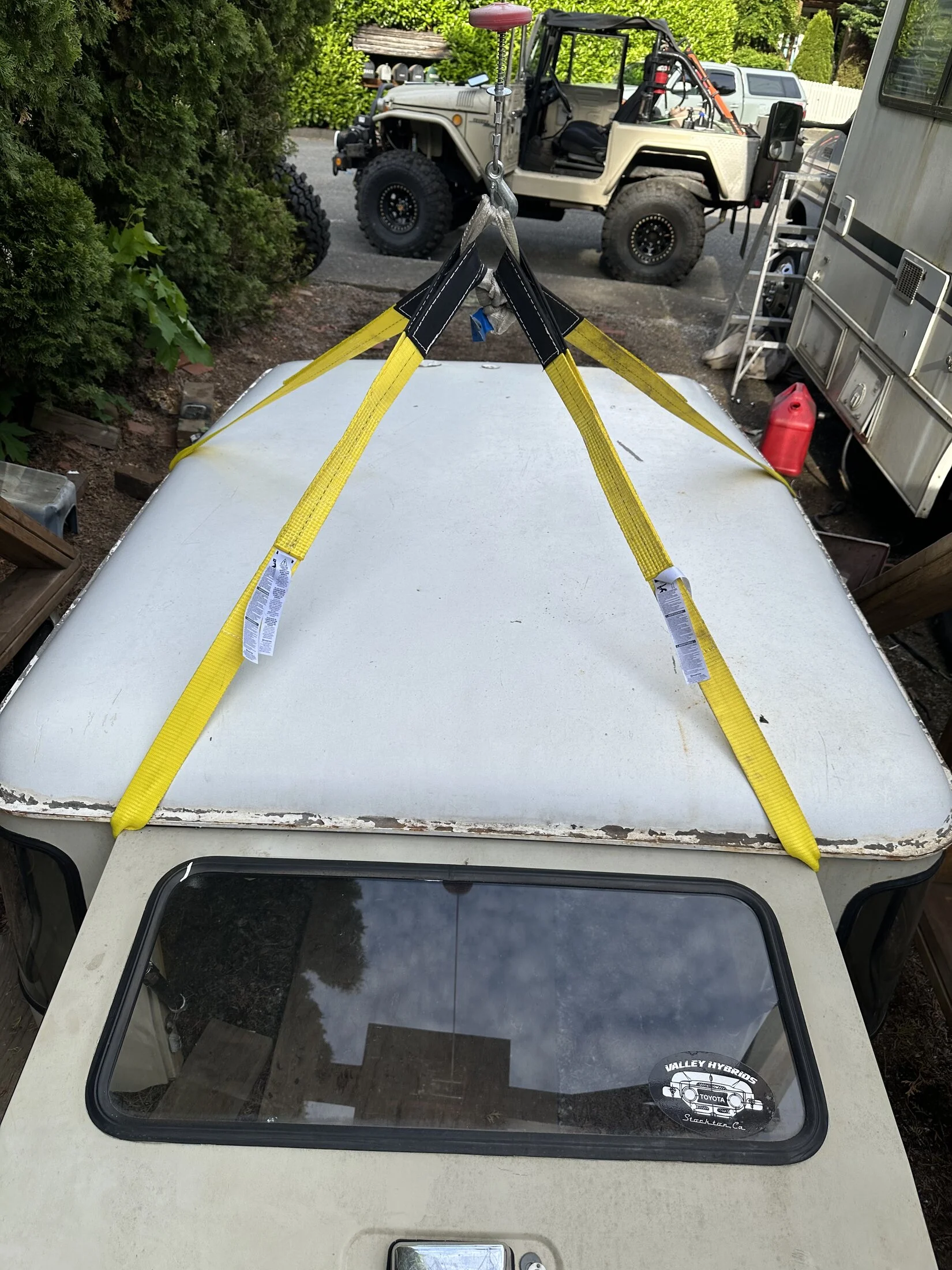

About to start pulling my hardtop apart to replace the leaky gasket underneath the drip rail.
Going to sand and paint my fiberglass top before re-riveting the top to the drip rail, the top is in decent shape no major gouges or need to re gel coat.
I’ve read a lot of threads on the topic but there doesn’t seem to be too much consensus on what paint to use on a fj40 top.
What primer/ paint system should I use that is best for fiberglass and last longest? I need to be able to get in OEM Cygnus white and shoot with a cheap harbor freight hvlp gun.
What seam sealer is the best to use between the fiberglass and the drip rail? I believe 3m is what I’ve seen used most…
What rivets are best to use for fj40 tops? Size?
Pic of top:
