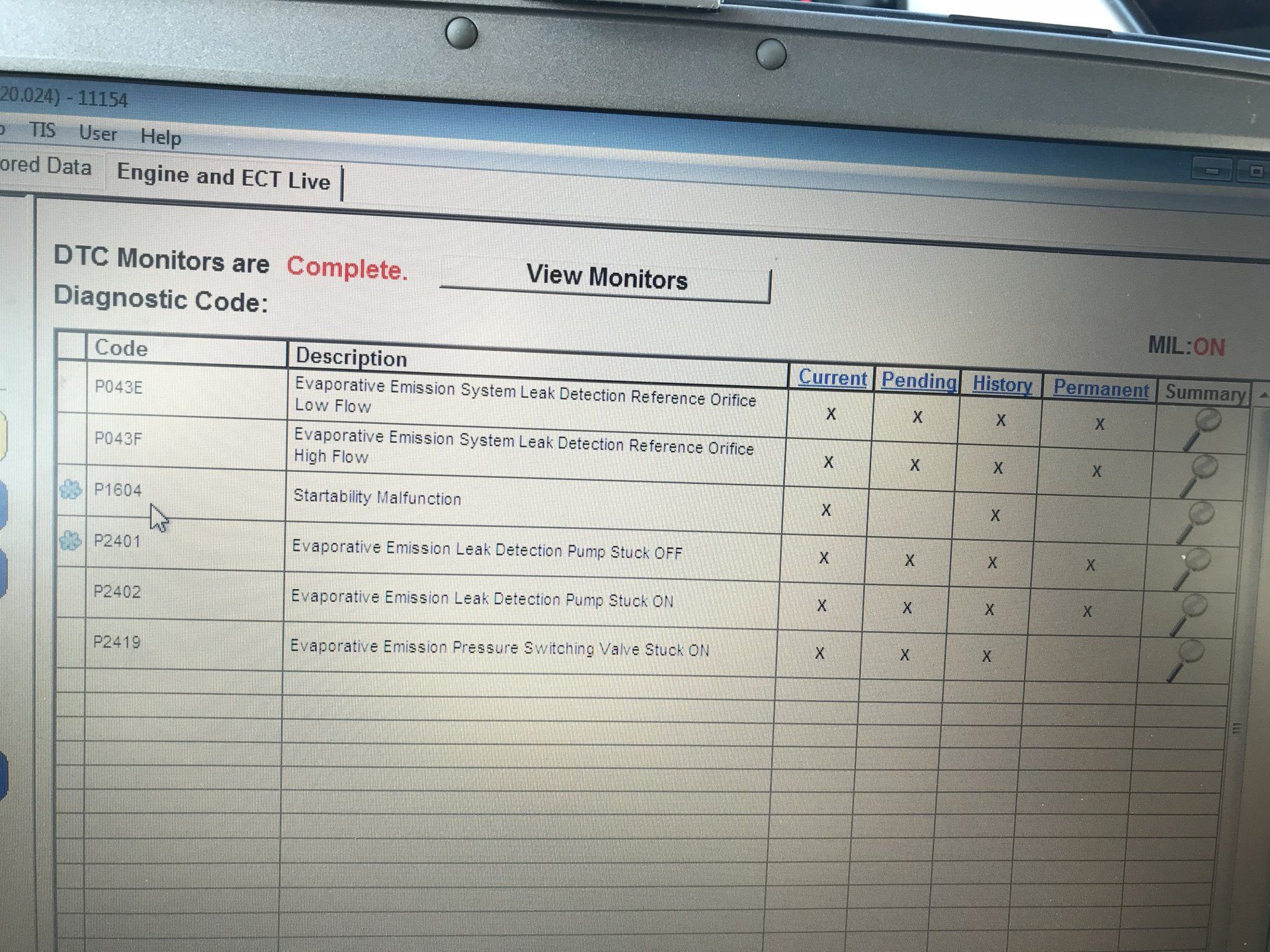

My cel code numbers are different. Yours may be related to gas cap only. Ignore P1604.
@TonyP , @Markuson
Are you getting the same codes as Kamal?
Looks like the test pump valves are stuck.

I think so. Can't remember the code number exactly but it was definitely "Evaporative Emission Control System Leak Detected".
Since they pop up every 3 days, can the collective members having this problem post the list like Kamal did. Will be interesting to see if there are any differences. Mine should pop up tomorrow. I'll post my results.
