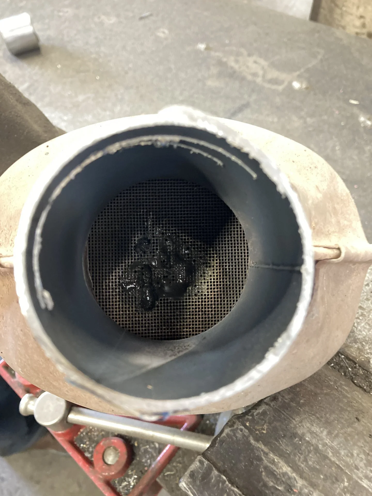

I'm going through this list one by one. For me, I've been having a P0420 come up last 2 years. It's the front Cat. By now, my cat has likely getting so bad that's it's now affected the oxygen sensor and running to rich and now throwing the 0172 code. I'm replacing my front cat tomorrow and see what happens. If I still get the 0172 code I'll replace the front 02 sensor.
**Update: May 14: My front cat was fried-literally. Replaced and welded in. We'll see if the gas mileage improves, 0172 and 0420 codes don't return.
