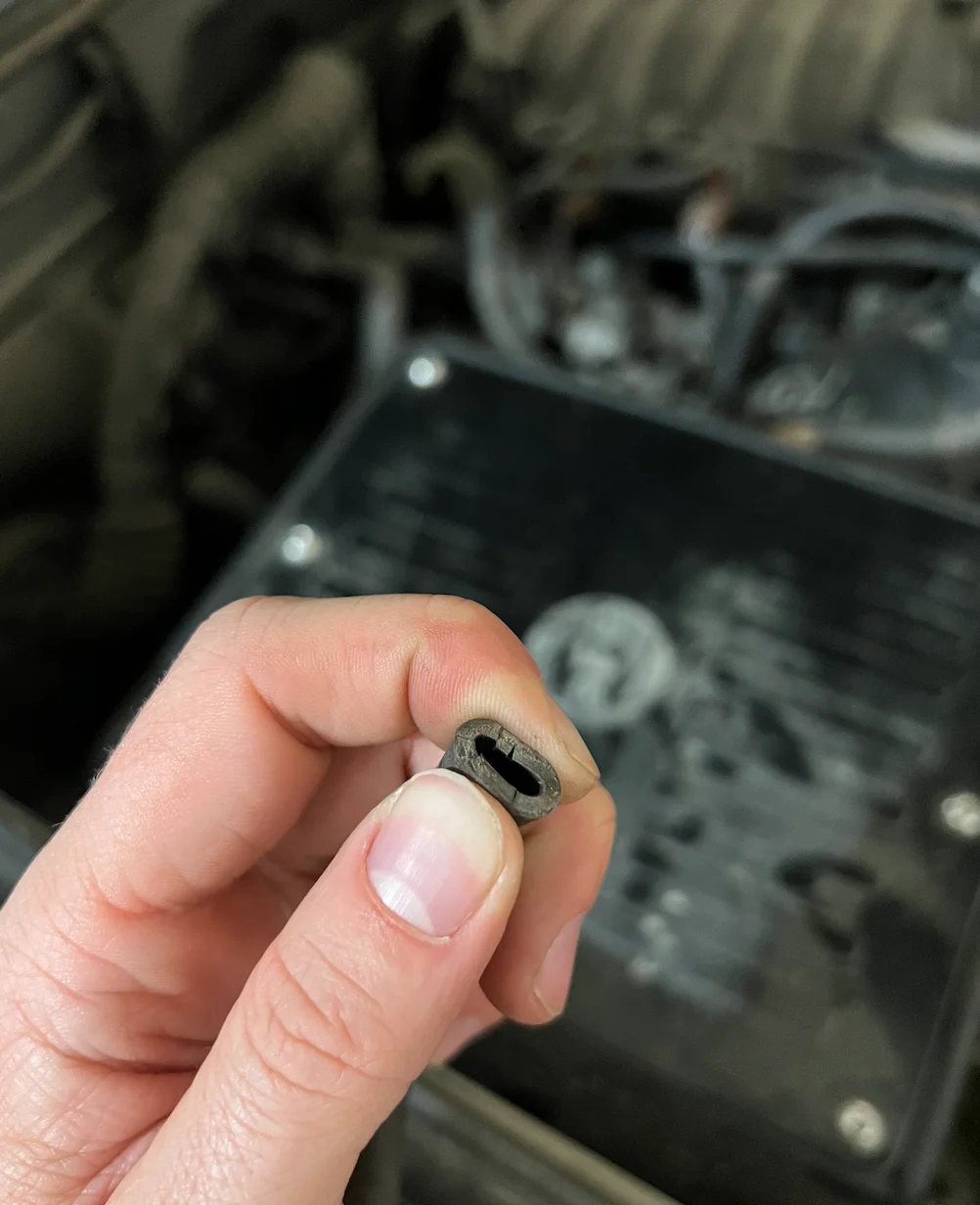

The other day, I started fiddling with all of the vacuum lines and intake tubes. I removed and cut the last few MMs of two lines that had tiny cracks on the end. I also removed and cleaned the intake tubing. I sprayed brake parts cleaner ALL over the engine and intake manifold, all lines, etc with no changes in idling. The truck is lightly seeping oil from under the intake manifold, but it's been visually the same for over 2-3 years. There is a little red tab sticking out that I will try to take a photo of, this is under the intake manifold and appears to be the gasket. But when spraying there, nothing changes.

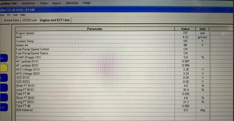

Those LT fuel trims are considerable, but they aren't aligning with ST data in the snips you provided. When you find the condition causing the error, these two should be nearly the same assuming incoming data is reliable. If you have another MAF, try it a while.

My vacuum lines look alright visually, but one of them had tiny micro cracks at the tips. I cut off the end with a razor. Some of them feel a little bit loose and rotate very easily on their connections.

I feel your pain. I tried all that too. Its those long term fuel trim at 30, dumping in gas because it cannot compensate. Way high. Mine were high 20's . Now normal. Sorry.
