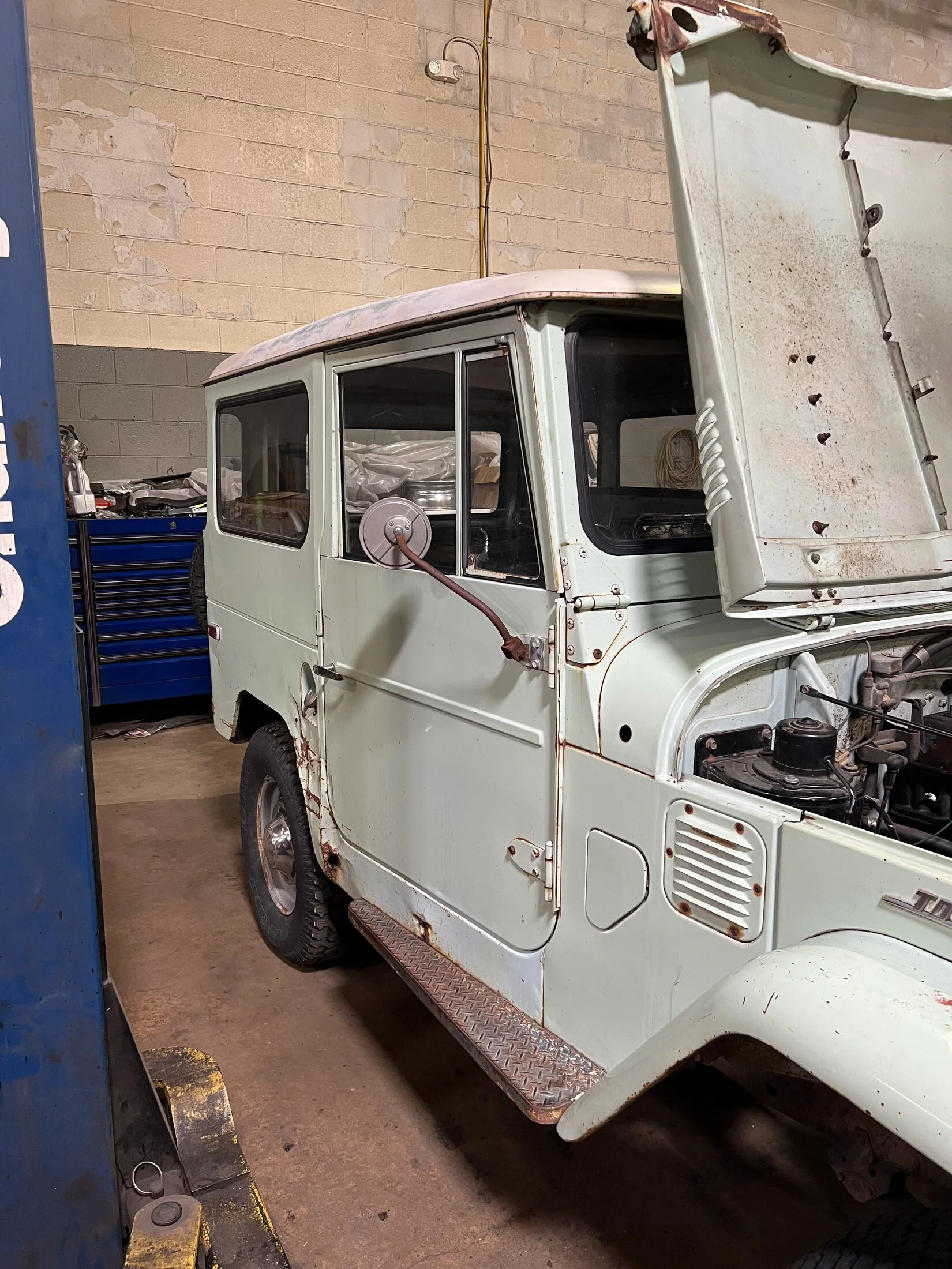

I own a 1970 FJ40 that I would like to try and remove the oxidation from the paint and see if I can get the paint to shine a bit more than it does now. The body is nowhere near perfect but it is the original paint and I just want to see if I can remove the oxidation. Any recommendations?

50/50 CLR and water. Spray one panel at a time. Scrub lightly with a blue scotch brite, rinse. You'll be mind blown. After the CLR you can hit it with whatever cleaner wax you want. I use Meguiar's Cleaner Wax in the burgundy bottle. It's cheap and does an amazing job. I have two Milwaukee buffers...a 3" and an 8" (6") those make quick work of polishing it up. But the 50/50 CLR and water will get you in the right direction. Yes, CLR like you buy at Home Depot. Calcium Lime and Rust.
