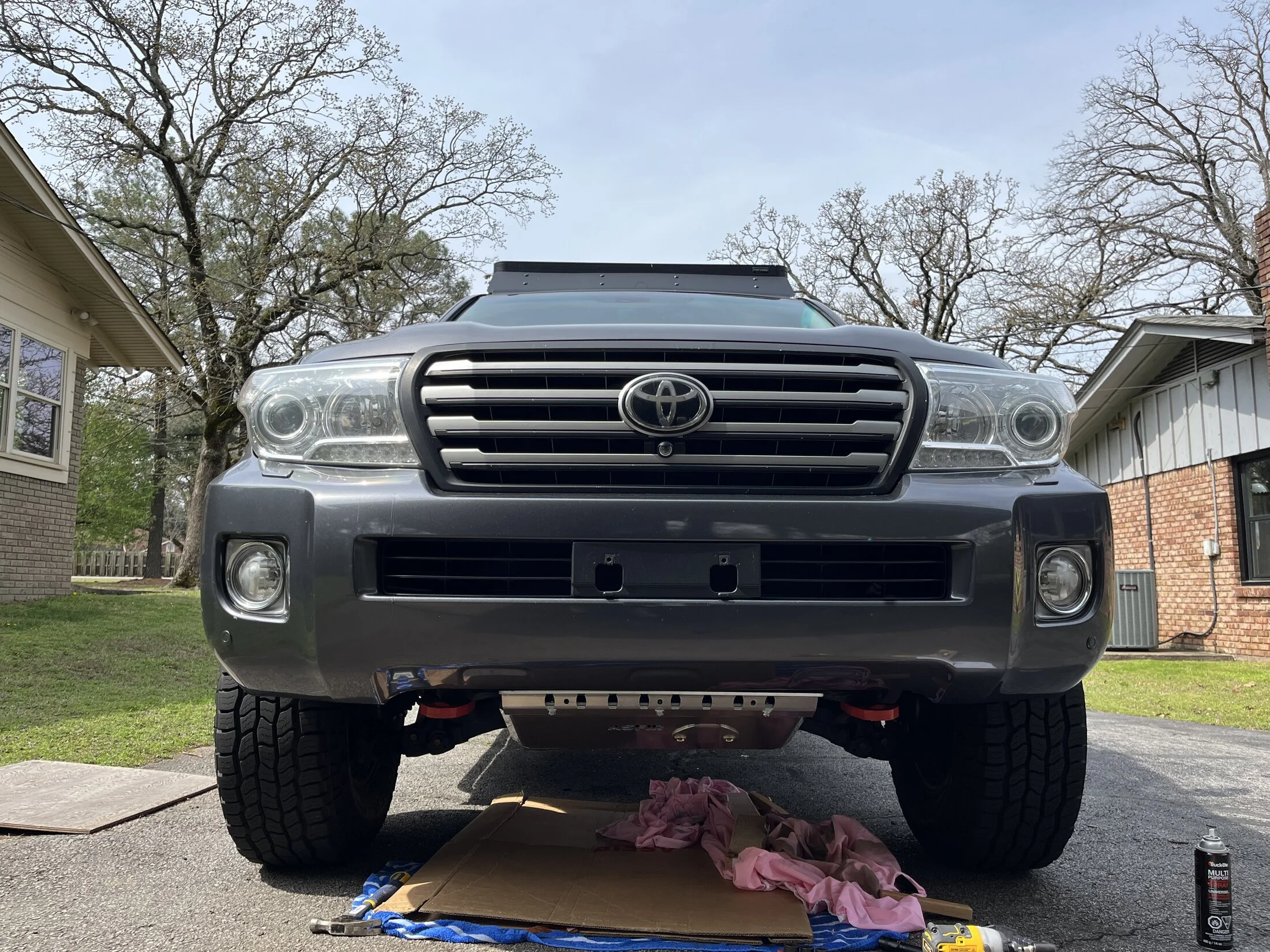

I have the front engine skid plate, and I'm very impressed with the design and fit. But the best thing about it, since I don't really do any rough off-roading, is the ability to change the oil without removing anything. And the fumoto valve doesn't get in the way.

Can you take a picture and share? Some of the stock images of ASFIR make the skid look like it hangs pretty low.
If anything it was the same as stock. To me, it seems to have more clearance than stock.
I know exactly what you're talking about. There are spacers in between the plate and the frame and I'm sure it does probably hang a little lower, but I don't really care since it already has a lift and I don't do anything serious off road. The oem skid plates had built in spacers, but I'll try to get you a better angle.
