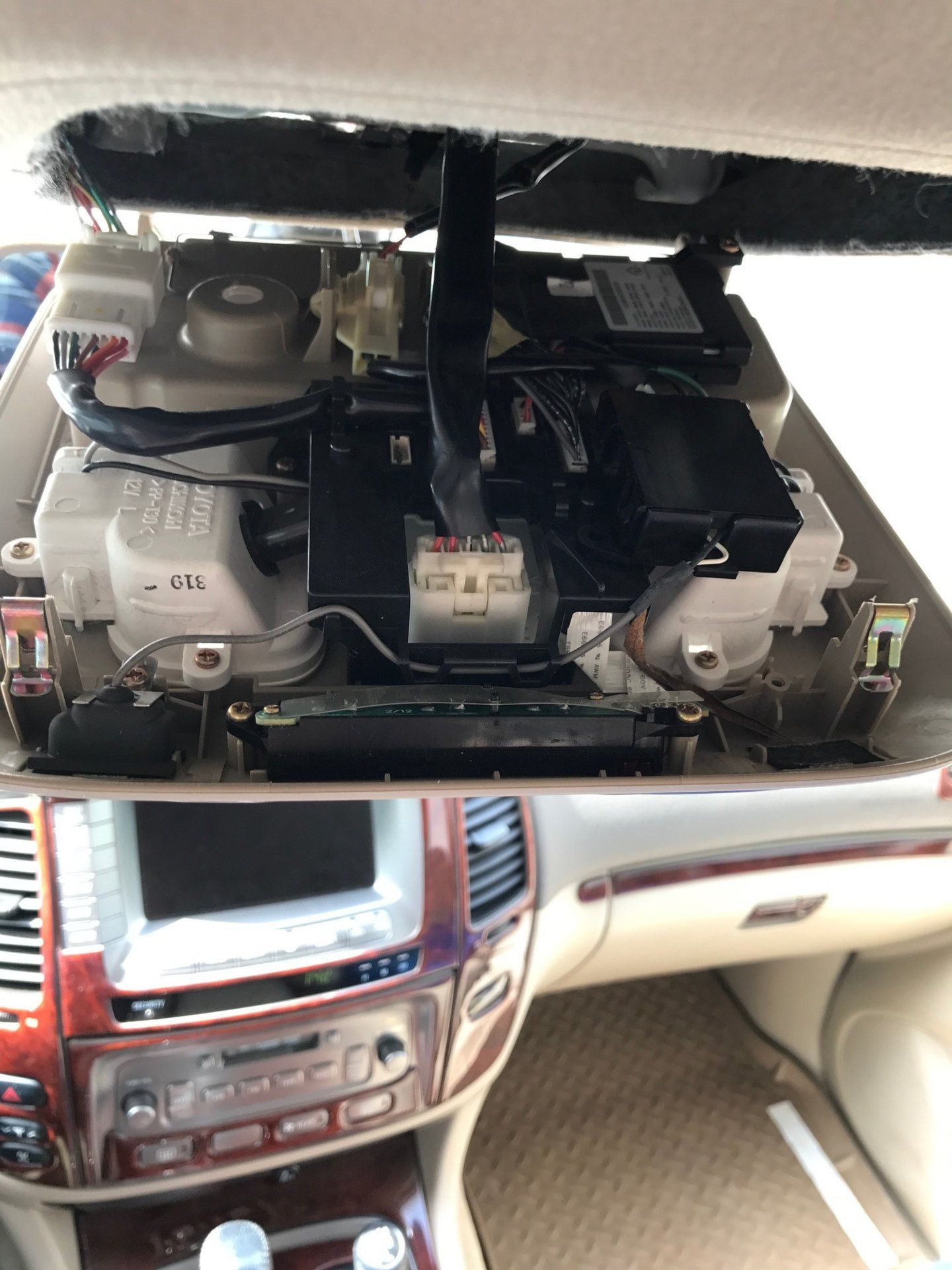

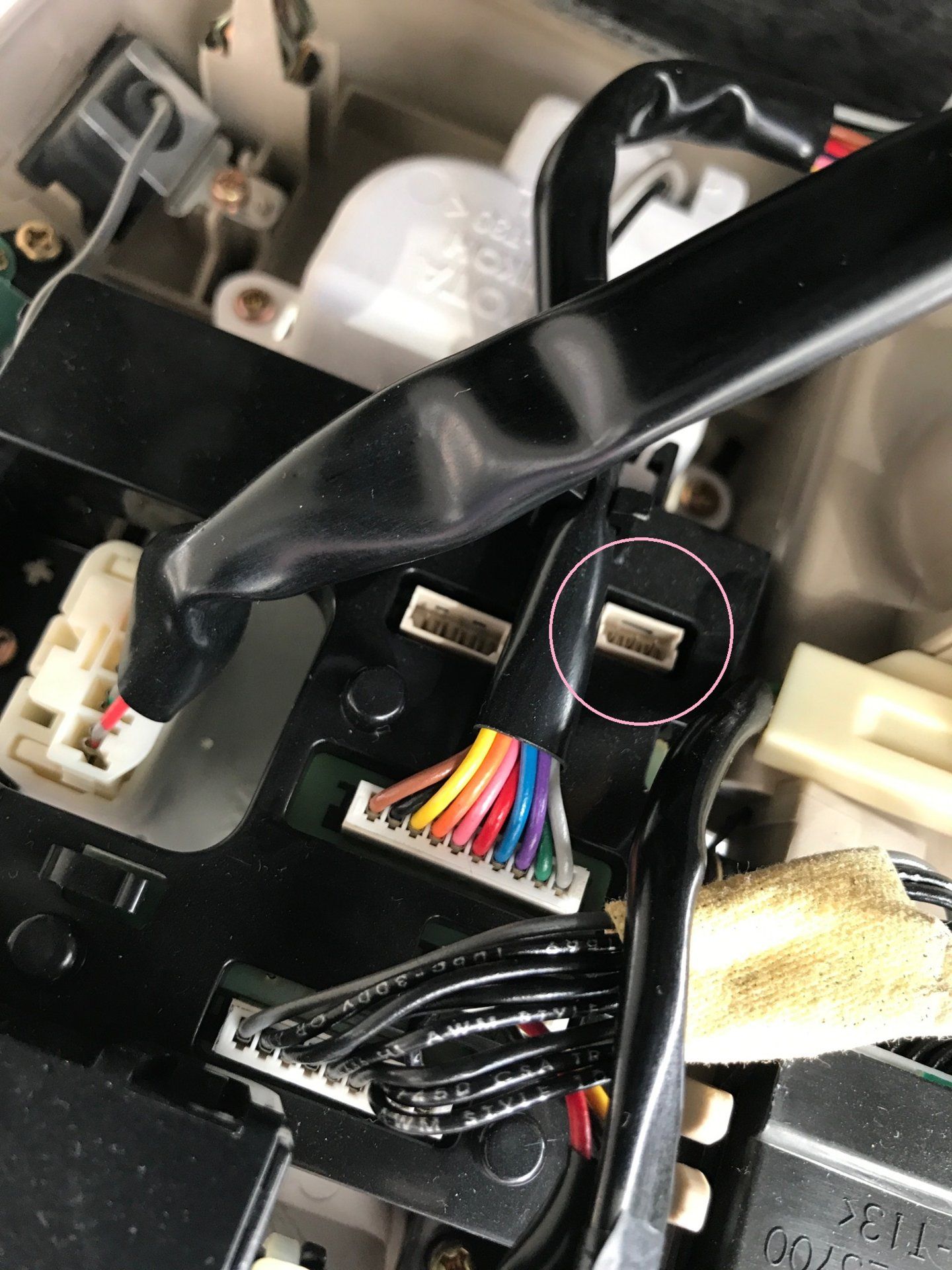

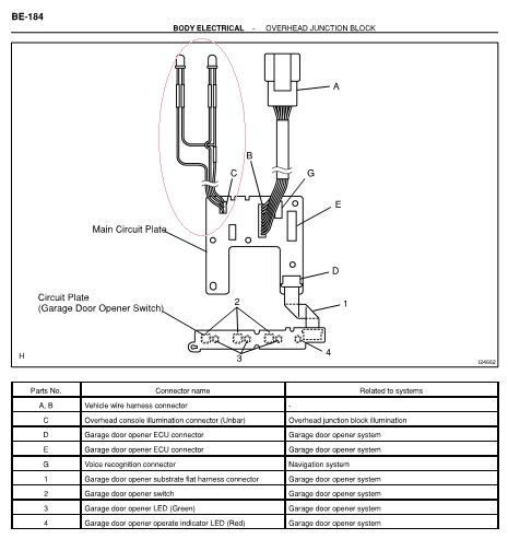

I have an 03 LC with the indentations, but no lamps. I can confirm there should be a part number out there somewhere to order the harness & lamps to just plug into the overhead console board, but I have yet to find it. I pulled the console on mine today and confirmed the connector is there and waiting. Operation wise, in my GX, these stay on as long as the headlights are on, so I would assume the circuit in the LC/LX does the same.

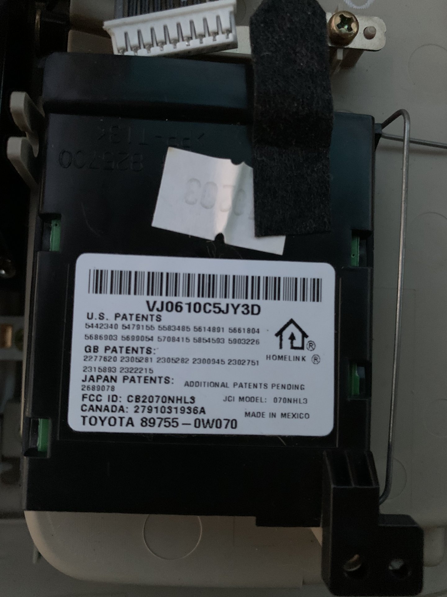

Here's the unit itself:
Anybody know if the ECU wiring/connectors on the new aftermarket transmitters are compatible/adaptable? Would be sweet to be able to figure this one out.
