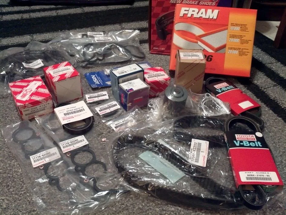

After going over what all I want to get done on the motor I got some of the parts ordered today... Timing belt, Idlers, Cam seals, Crank seal, Tensioner, Serpentine Belts, Aisin Water pump, Thermostat, spark plugs & wires, Oil filter, valve cover gaskets, valve cover grommets, plenum gaskets, and some other seals. The rest I'll get locally. This is going to be more than I initially set out to do...
The parts arrived late Saturday. Now i just need a day or two to work on it!
