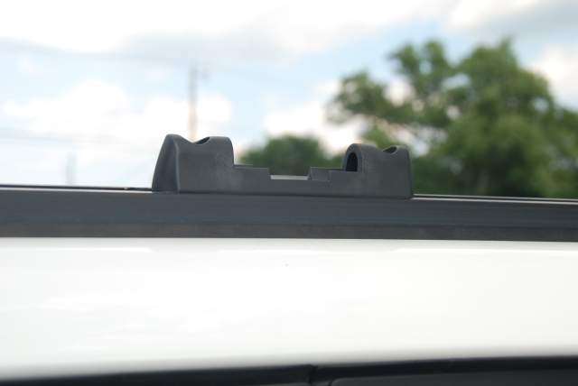

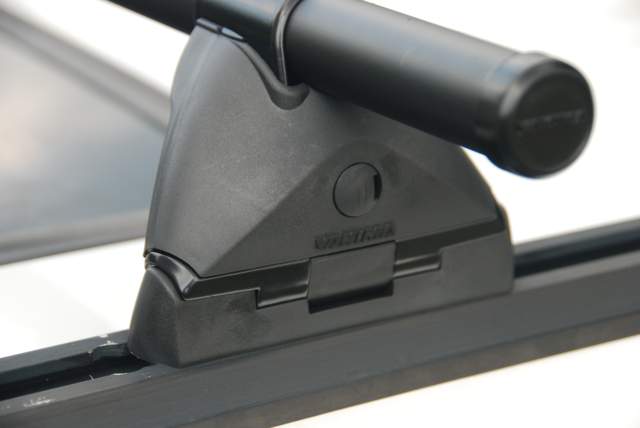

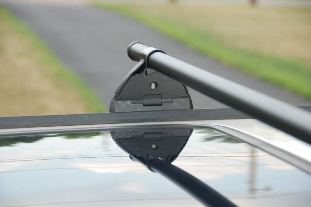

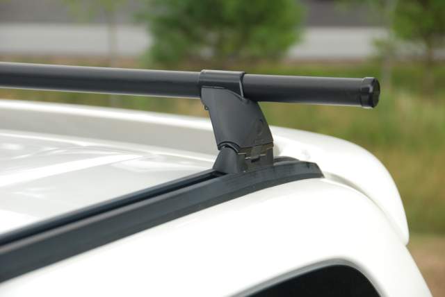

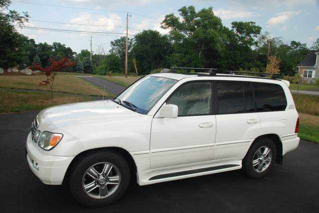

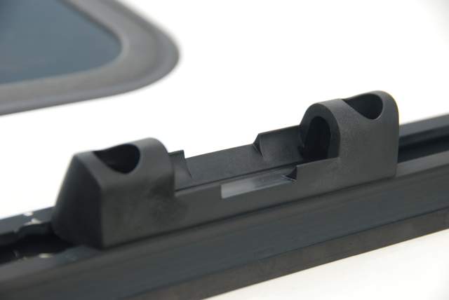

I got an African Outback roof rack from Slee a month or so ago. It's definitely an awesome rack, but I definitely won't be keeping it mounted all the time because it decreases gas mileage, adds extra noise (especially with the sunroof open), etc. There are times when having a rack is useful, but the AO rack would be overkill for the task and takes a decent amount of time to put on and take off so I decided to look into other ways to make use of the tracks that get mounted as part of the install for the AO rack and remain mounted when the rack is off the truck.
The 2 obvious options were Thule and Yakima as they both have extensive lines of rack mounts that will work with just about any vehicle. I took a trip to REI this morning and brought one of the AO studs that slide in the track with me for comparison. Starting with Thule, none of their options looked like it would work well. They have some kits that are intended to work with tracks but nothing that looked big enough to not be a sloppy fit in the AO tracks. I then looked at the Yakima options and found exactly what I needed. They have various "Landing Pads" that are designed to mount to various types of tracks and then "Control Towers" that the crossbars connect to and then attach to the "Landing Pads". It turned out that Landing Pad #1 is nearly a perfect fit for the AO tracks. The minimum bar length for the 100 series is the 58" bars. Since nothing around here exists without pictures :), here are some:

It cost $207 at REI for the Landing Pads, Control Towers, and a pair of 58" bars. You could certainly get the parts a bit cheaper online, though shipping might be a killer on the bars. I felt though that since I was opening boxes to check sizing it wouldn't be fair to then go purchase the parts elsewhere to save a few bucks and REI has always been very good on the customer service side.
I had considered the load bars that Christo sells when I first ordered the AO rack as I had thought they would be perfect for quick jobs where the AO rack is overkill. However, they are not compatible with the AO tracks - they bolt directly to the roof so you would have to remove the tracks to use them. Those bars also wouldn't be fully compatible with the Yakima or Thule product lines.

Yeah, they're a nearly perfect fit and can pretty easily be positioned anywhere along the track. The only thing is that since the spacing between the tracks isn't constant along the length, you have to loosen the crossbars within the towers when moving the towers along the track, but these adjustments are very easy to do with a single allen wrench.
The combination of having the AO rack and the ability to use the Yakima system for everyday use is exactly what I was hoping to be able to do. Plus it looks much better than the factory rack did in any configuration (just the tracks, with the AO rack mounted, or with the Yakima crossbars mounted).
