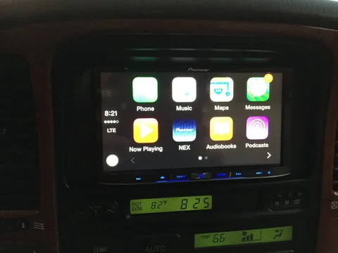

Ordered a Pioneer AVIC-7100NEX
Apr 1, 2013
21
429
Redwood Empire
Well after over 2 years of rocking a tape adapter (multiples as they keep breaking!) in my LX, I have finally gone down the rabbit hole of gutting the OEM system.
As I use AirPlay in my Home Theater, I did want to continue that with Apple's CarPlay. This narrowed my choices to the Alpine ILX-007, the Pioneer 4100/5100/6100/7100/8100NEX, and I believe Kenwood is now doing CarPlay now as well.
While I love the industrial design of the Alpine, it does frustrate me that the unit is practically useless should you not have an iPhone in the vehicle. (only AM/FM work without an iPhone).
This made the Pioneer NEX H/U's the choice for me. I was going to get the 6100, but the 6.2 inch screen somehow seems much smaller than the 7 inch in the 7100/8100. While I almost went ahead and ordered the 8100, the 7100 is all but identical sans the capacitive touch screen.
I have now also procured a JL Audio 500/1 which I am going to tandem with most likely a JL 12W7 ProWedge and either Focal 6.5 component sets (front and rear) or JL Audio components with most likely a JL Audio 300/4.
I am open to any suggestions for both speakers and amplification (for the components). Given the sound deadening in the LX, I have high hopes that it is going to sound absolutely amazing.

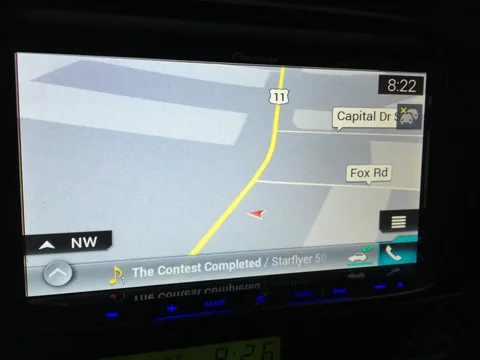

I just put the 8100 in my 01 a few weeks ago prior to a 9 day road trip. I have been super happy with it, you will not be disappointed. The Android Auto function works great with Android phones, google play music and maps work really well.
I am beyond stoked about this.. It is amazing just how much more modern the interior looks when replacing the 98-02 (some 2002's) tape deck/CD changer.
Kinda wished I went ahead and got the 8100, but they look identical. That said, the capacitive screen is definitely a plus.

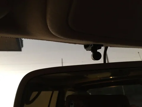

Mine is just under the lip - centered - of the top rear hatch. The wires were run internally up to the top of the hatch and through the grommet that holds the other electrical wires.

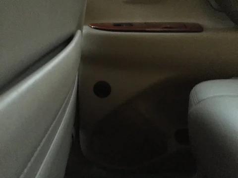

I cannot overstate just how much better the sound truly is now. Ended up using a single Kicker 12 inch subwoofer in the back that can be easily removed so that no utility is lost in this project. Truly awesome having Apple CarPlay and a million other functions. Also, it rocks to no longer be using a bloody tape adapter.
