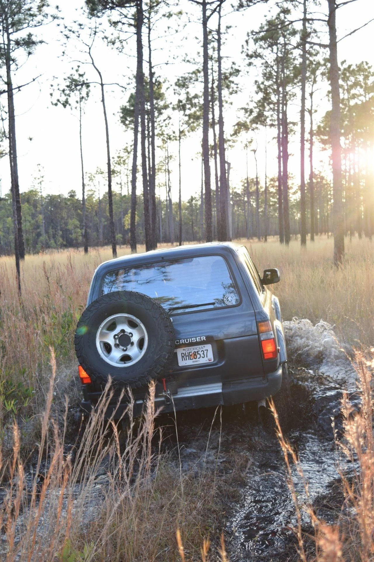

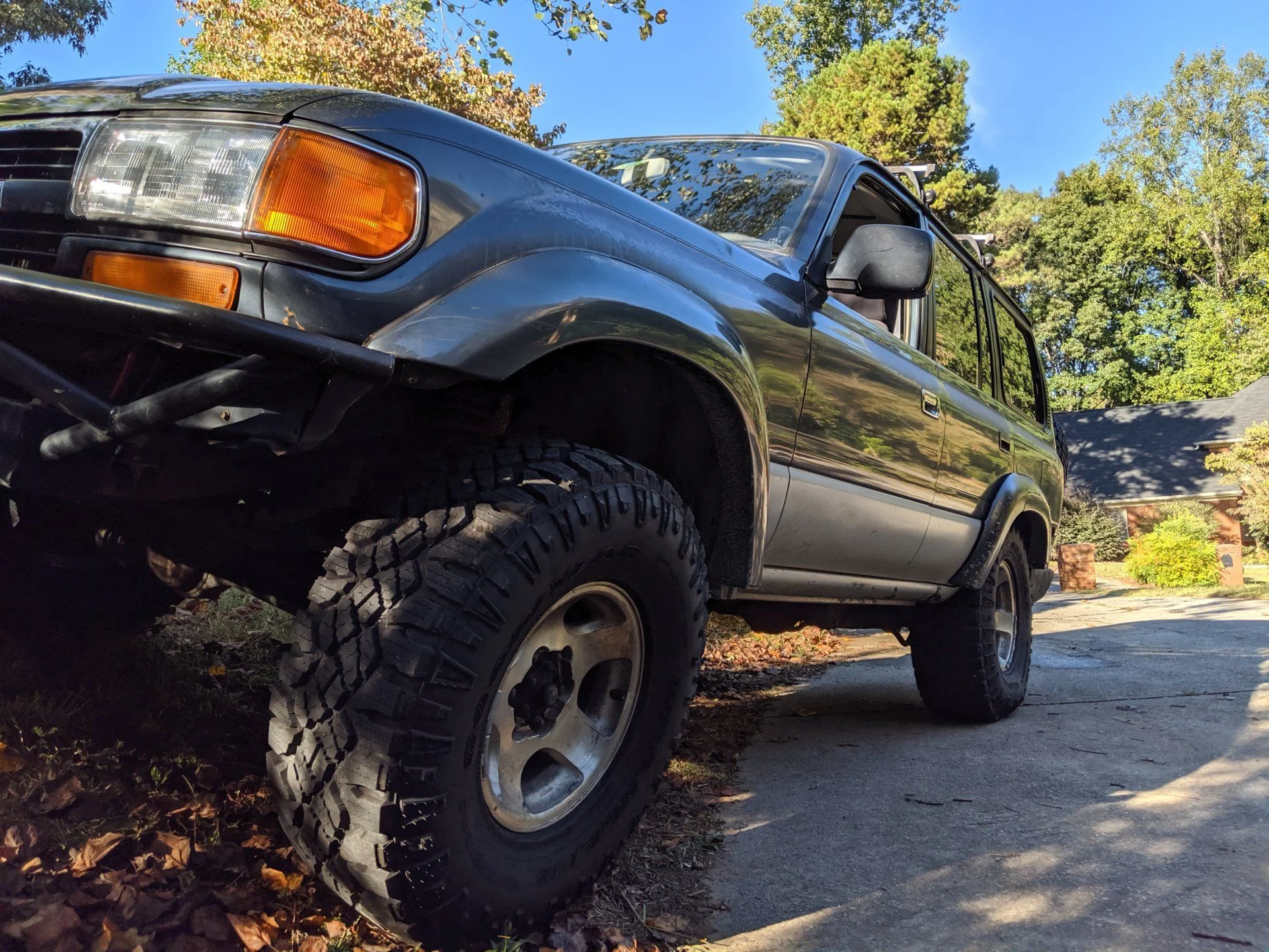

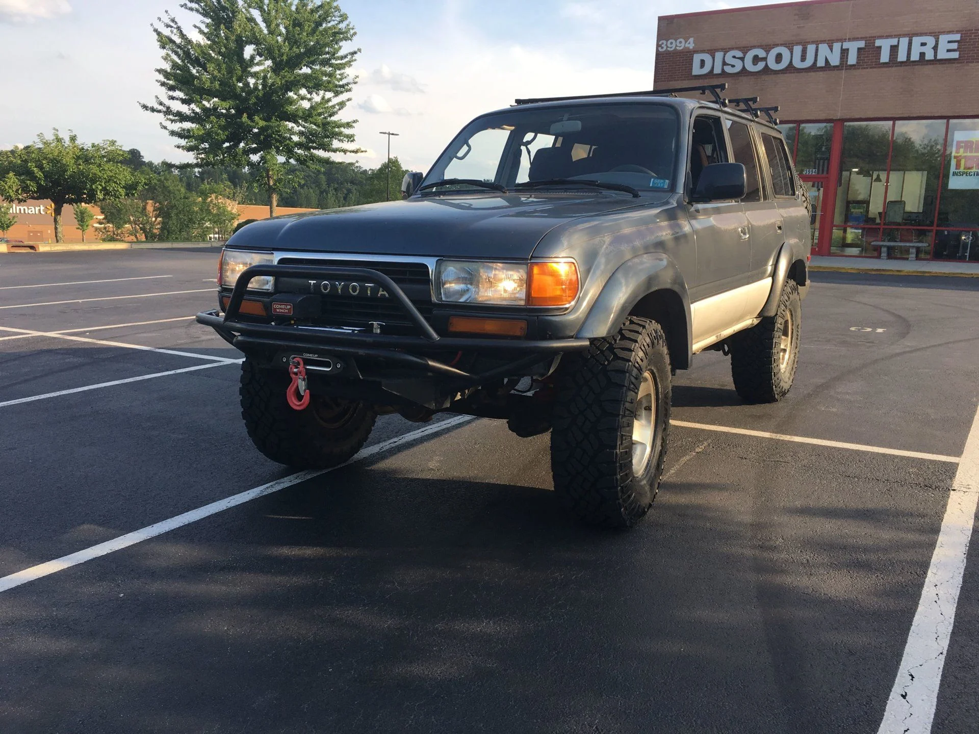

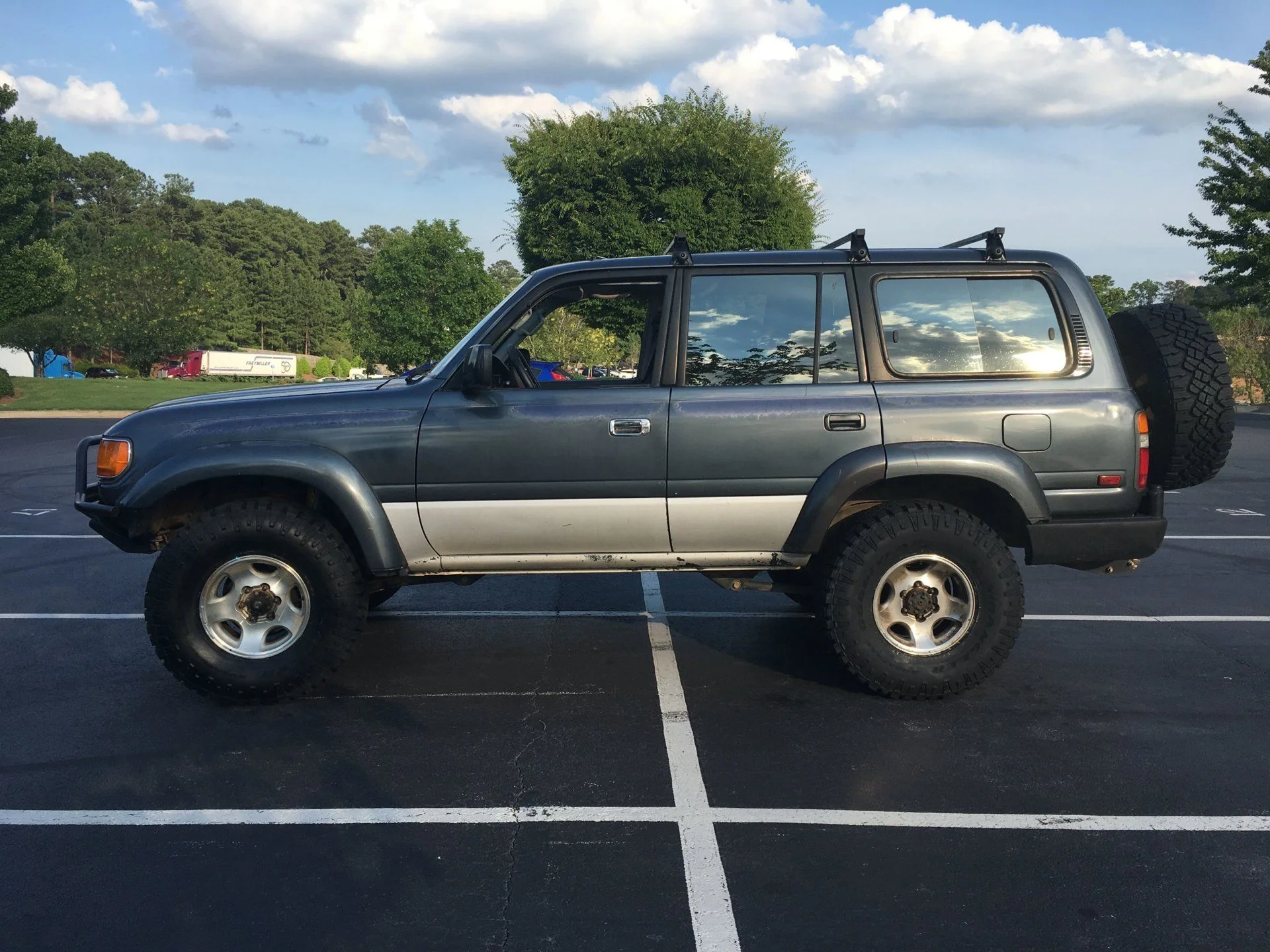

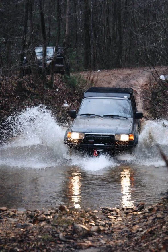

I would love to get it back on the road for as inexpensive I can since I'm paying for school and don't have a great flow of income. Any suggestions are welcome. Here are a couple pictures of it:
