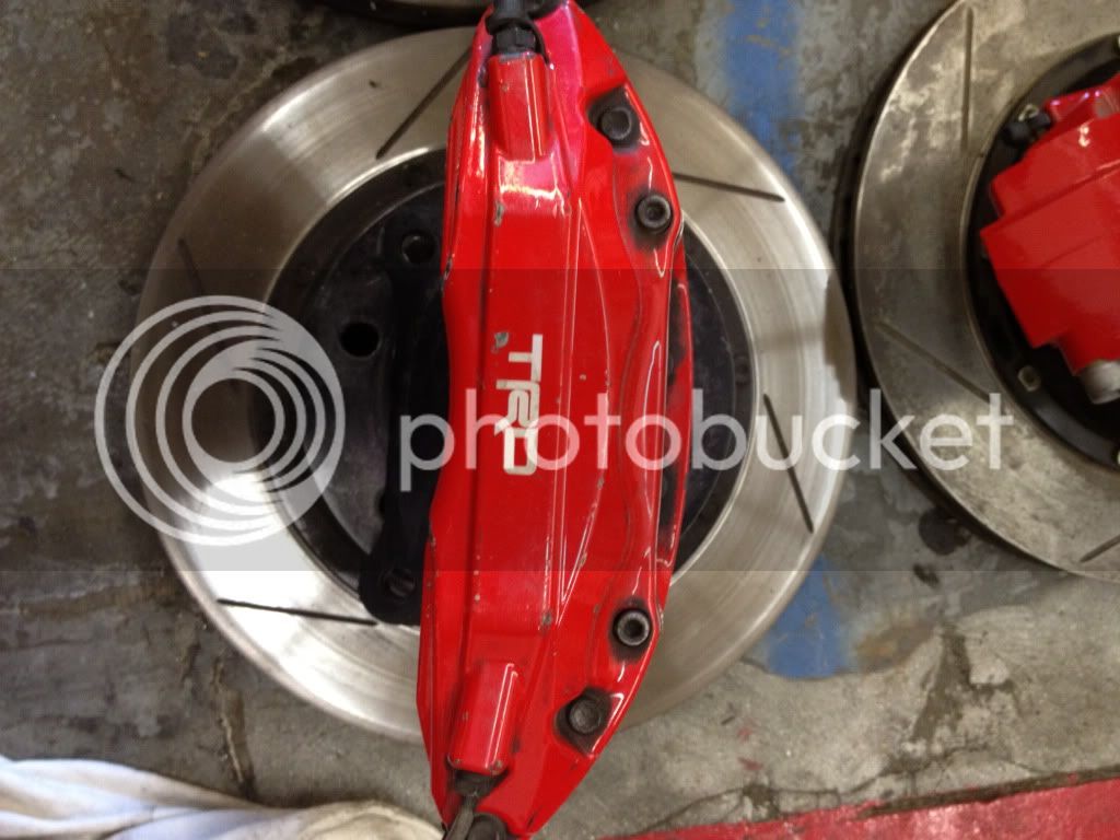

Somewhat irrelevant info on brakes on the 3rd gen runners. Some of you smarter people will give face palm, but posting this info here anyway. Please correct as needed.
Problem, 4runner brakes sorta suck and like to warp.
Recall HERE
Solutions:
"upgrade" to Tundra Rotors and Pads.
Two variants:
Stock 4runner calipers are 199mm.
Earlier Tundra calipers are 199mm & up to Sequoia 2002.
2002 Tundra calipers and rotors 231mm.
Key markings:
199mm : caliper S13WE
231mm : caliper 13WL
Haven't decided which route to take, but that what I know.
